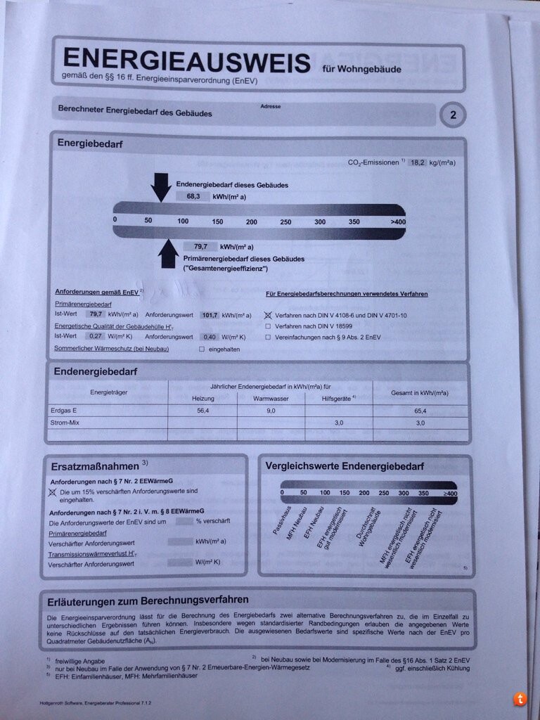

We are building a bungalow 108 with Town & Country, including underfloor heating, 40cm (16 inches) roof insulation, triple-glazed windows, and all the usual features. The consultant told us that instead of a 24cm (9.5 inches) Ytong wall with insulation, he would recommend a 30cm (12 inches) wall without insulation. This way, they said, meeting the KfW 70 standard would be no problem... so, were they lying to us? Because I keep reading about 36.5cm (14 inches) blocks... or is it due to the thick roof insulation combined with the underfloor heating and thick floor slab? Town & Country would be shooting themselves in the foot if they were lying to us here...

I was mistaken, sorry, the roof insulation is only 24cm (9.5 inches)...
Unfortunately, I can only find information about the concrete slab, such as concrete grade C25/30.
Then there is the floor with approximately 85mm (3.3 inches) insulation (rigid polystyrene foam, thermal conductivity 0.035 W/mK) and about 45mm (1.8 inches) cement screed.
