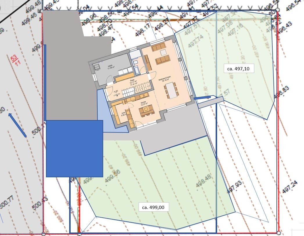

hanghaus202313 Feb 2023 13:27In my design, the finished floor level of the basement is at 496.3 m (1627.6 ft) when used as living space. Your lowest point on the property is 496.4 m (1627.9 ft).
However, my version should generally work without a basement, with optimized earthworks and retaining walls.
I also swapped the kitchen with the living room. The utility room becomes the laundry/utility space, and a storage area can still be separated.
I rotated the house so that if a house is built to the south later, the view won’t be too obstructed.
Have a look at the Vero architect-designed house.
Your planner’s design also works here. The upper floor level then reaches 499.75 m (1640.4 ft) and the lower at 497.05 m (1630.6 ft).
If the basement fits the budget, the only remaining issue is the tower construction. I would at least shift the basement 3 m (10 ft) to the southeast so that a roof terrace can be built on top.

Dachshund9013 Feb 2023 14:03hanghaus2023 schrieb:
In my design, the finished floor level of the basement used as living space is at 496.3 m (1,627.95 ft). Your lowest point on the plot is 496.4 m (1,628.62 ft).
I also swapped the kitchen with the living room. The utility room becomes the HAR (household utility room), and a storage room can still be partitioned off.
[ATTACH alt="Grundstueck138.jpg"]78188[/ATTACH]
I rotated the house so that if a neighboring house is ever built to the south, the view won’t be obstructed.
Take a look at the architect-designed Vero house.
Your planner’s design also works here. The upper level will then be at 499.75 m (1,640.42 ft) and the lower at 497.05 m (1,631.56 ft).
If a usable basement is within budget, then only the tower construction speaks against it. I would at least shift the basement 3 m (9.8 ft) to the southeast, so that a rooftop terrace can be built on top. That looks good 🙂 I think it’s quite close to the levels of our version with a basement. The retaining wall you’re showing below in the garden?
That would mean the entrance through the front door would be at 499.75 m (1,640.42 ft) and the basement exit at 497.05 m (1,631.56 ft)? The garden surface in front would then be at the same level... so that means what we want should actually work?!
... if you don’t cover the significant part with a beam. DBDDHKP :-( I’m afraid I don’t understand, please explain 😉
But what am I supposed to do about the tower construction? I guess you have to accept some compromises if you want to keep the basement...
hanghaus202313 Feb 2023 14:25Dachshund90 schrieb:
That would mean the entrance at the front door is at 499.75 and the exit from the basement is at 497.05? The garden area in front would then also be at the same level... so what we want should actually work, right?! These are the elevations according to your plan, if the basement ceiling is reduced to about 2.40 m (7 ft 10 in).
My option without a basement should work with the elevations shown in the plan due to the volume balance and the optimization of the upper floor (knee wall about 2.00 m (6 ft 7 in)). If you raise the height by about 75 cm (30 inches), you will also need to add 75 cm (30 inches) more fill. With the basement option, you can use the excavated material for leveling.
