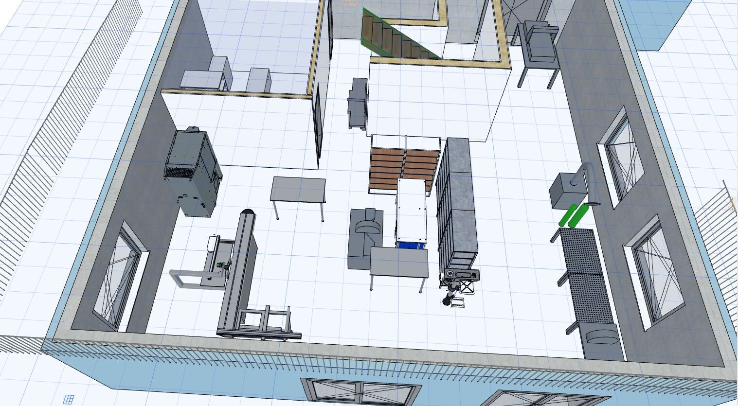

To clearly specify the intended use of this basement space, an image is attached.
The space is needed, among other things, for the following equipment (only partially shown):
Panel saw (6m space requirement)
Planer/thicknesser
Clean air extraction system
Welding table
Welding machines
Welding fume extraction
CNC gantry milling machine
Wood miter saw
Metal miter saw
Workbenches
Screw compressor (possibly in the attic)
Compressed air tank at least 300 liters (80 gallons) (possibly in the attic)
Sandblasting cabinet
Bench drill press
FLM 3D printer
Anyone who has worked in a workshop knows how important sufficient clearance is, as you not only risk bumping into things but potentially more serious consequences. Therefore, the necessary movement space must definitely be provided.
These are high-quality machines that cannot be accommodated in a shed or similar. In addition, storing them in such a manner always carries the risk of damage from condensation.
Currently, the machines are used exclusively for private purposes, but a commercial use in the future cannot be completely ruled out. In order to operate them in a general residential area, noise control regulations (TA noise) and air quality regulations (TA air) must be observed, so the basement would be ideal for this purpose.
There is also a level access, which facilitates unloading, for example, wooden boards. The neighboring building also houses a commercial business in its basement.

Regardless of the floor plan / basement, etc.: your hobby workshop adds a significant fire load. Have you considered how to address fire safety for this?
