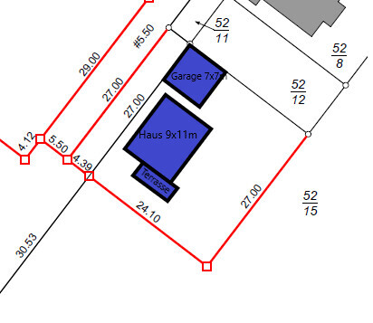

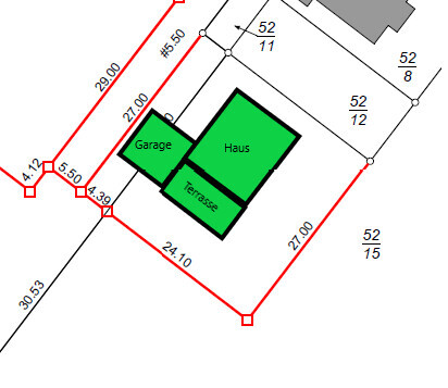

The main consideration right now is simply the arrangement of the house, terrace, and garage on the plot (see sketches). With the blue option, I lose a lot of space to the south, so the terrace becomes smaller and moves close to the southern boundary. This also leaves little space for passage along the boundary. In the green version, the garden becomes smaller toward the east....

I don’t know what the zoning plan says, but with the blue option, you could also consider swapping the building’s dimensions, so 11 m (36 feet) toward the southwest instead of 9 m (30 feet). That’s how it is oriented in my opinion.

as an initial preliminary draft, the blue option is proposed. This is basically similar to the version suggested by hanghaus2023 but loses more space towards the south. The reason for this is that the garage is 7m wide (23 feet) and there is a staircase between the garage and the house leading down to the garden and the basement/laundry room entrance.
This leaves just about 7.5m (25 feet) from the south side of the house to the property line. With a nice large terrace, there isn’t much space left towards the boundary, and if the neighboring plot to the south is ever developed, it would be right in front of you.
While we’re on the subject, since we have a good relationship with the neighbors to the north, it is still uncertain whether we want to place the garage directly on their boundary, as it could potentially cast shade on their terrace.
For these reasons, the green layout has also been proposed as an alternative.
