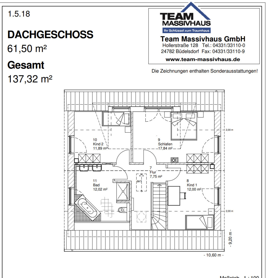

Regarding the original floor plan: it is quite poor. No one wants to have a staircase immediately visible when entering a house – it’s simply not the best side to show. TM has yet to gain any acclaim for their floor plans. The building proposal catalog from Team Massiv feels to me like an accumulated collection of customer houses (which I generally appreciate as a concept compared to simply copying the entire prefabricated house catalog), but these designs still need some “refining,” which I unfortunately find lacking. A note of caution when abbreviating: another regional general contractor would be Tönjes and Meichsner, who built @kati1337’s “old” house and whom I personally find more recommendable. So, to avoid confusion, TM and T&M should definitely not be mixed up. Then there is, for example, Kagebau, which I recall receiving rather mixed reviews here. In comments from the unfortunately now inactive @Nordlys, there are numerous assessments regarding the reliability of various owner-operated general contractors from northern Germany, often with a caveat like “they’ll go as far as Deekelsen, maybe Büttenwarder, but probably not further” – although searching for these comments using the forum’s search function can be a bit tedious, it’s worth looking them up since Karsten usually also commented on how trustworthy their reputation is, figuratively speaking, as reliable “horse dealers” ;-)

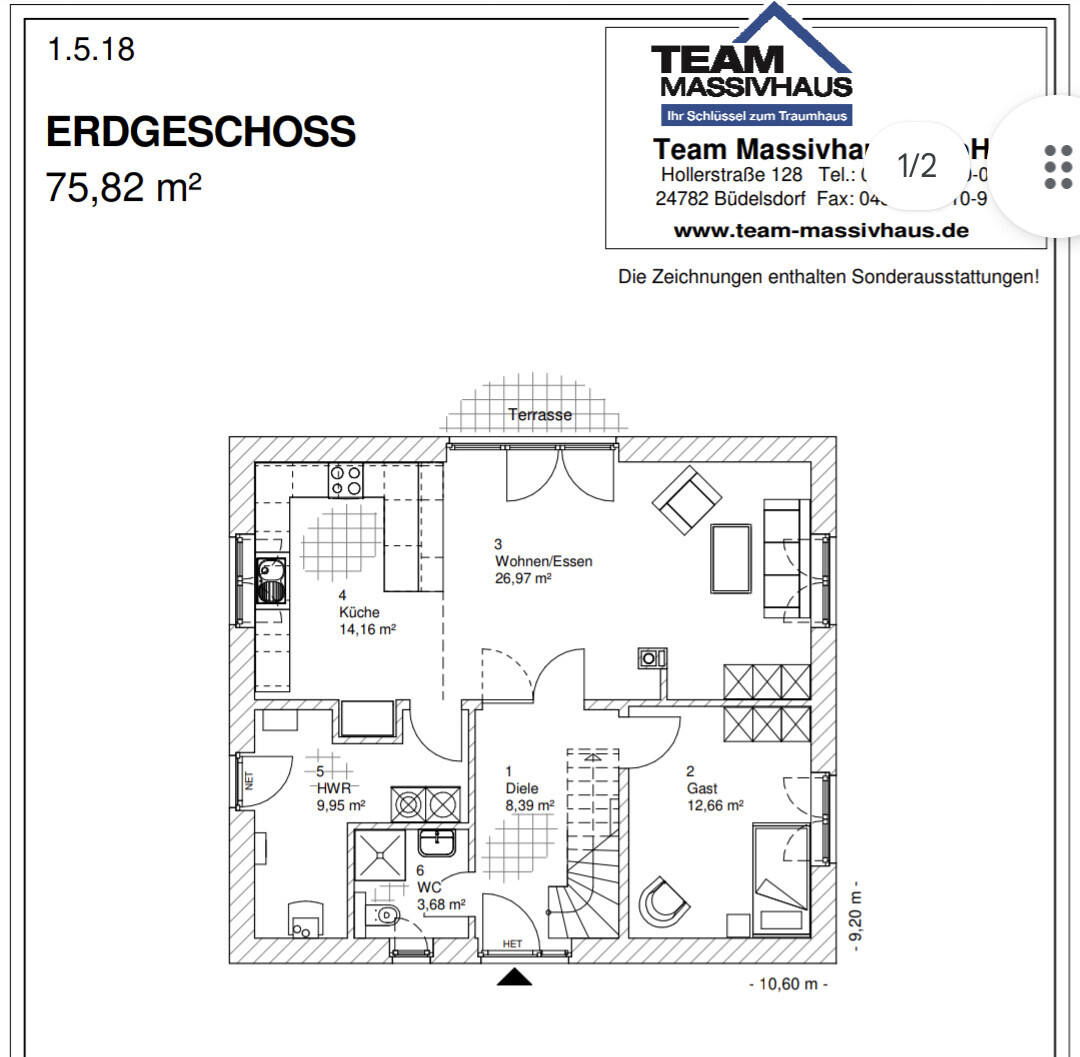

Additionally, we have given some thought to your warnings about the staircase in the open living area, and since we want to be reasonable, attached is our new favorite layout for you to critique.
A quick update: we spoke with an excavation contractor, and the costs for digging the wastewater pipes are less dramatic than expected because there are apparently inspection chambers on the property. As for the other utilities, we are still waiting for feedback from the respective providers.
The utility room has a lot of unnecessary circulation space due to the bend. I am unsure whether it is even allowed to place it without a window. Surely, someone else can assess that.
Personally, I don’t like guest toilets where you have to step in and squeeze in front of the sink to close the door before you can finally sit down on the toilet.
Upstairs, the bedroom seems disproportionately large compared to the children’s rooms (children spend more time in their rooms than you do in the bedroom). The bathroom door is inconvenient because it opens directly into the circulation path for Child 2. The bathroom is also larger than the children’s rooms, which seems like the wrong priority to me. Reduce the bathroom size by cutting down the open space in the middle, and you will gain about 1m² (11ft²) for each children’s room and can optimize the upstairs layout again (maybe with smaller bedrooms as well).
WilderSueden27 Jan 2023 11:20Doesn’t the utility room have a window? I would definitely omit the kink and instead place a cabinet in the utility room there. Overall, I don’t think it’s well designed; I wouldn’t place the access to the technical room through the living room. The bathroom situation can probably be improved as well.
What also strikes me immediately is the dining area—or rather, the absence of one in the current plan. Try drawing a table and chairs to scale there. Also, windows above the back of the sofa? A TV in the middle of the room? Even if this might not be the final furnishing... always keep the intended furniture layout in mind during planning and, if possible, include it in the drawings.
