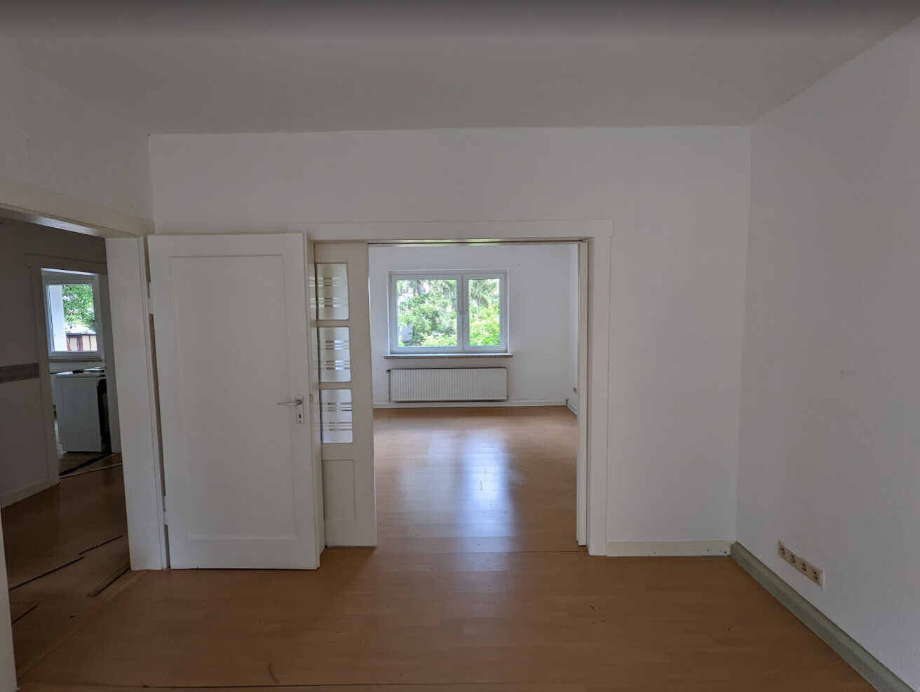

As promised in the original post, here are some before pictures from the inside:
Ground Floor:
Living room looking towards the future dining area. The sliding door between these two rooms will remain, as well as the interior doors.

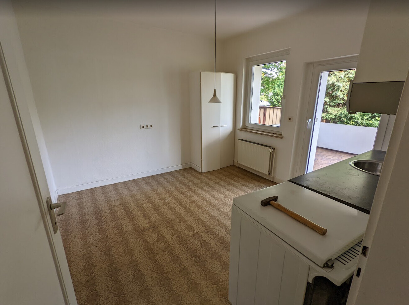

Kitchen:

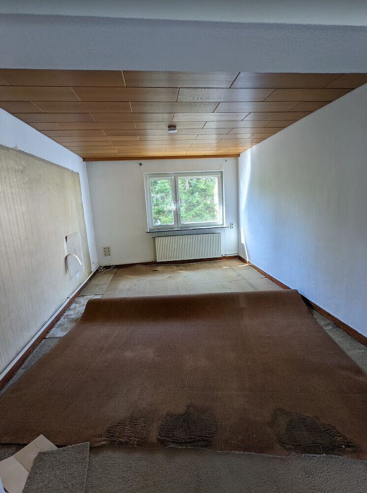

Upper Floor:
Children’s room with wood paneling at the top. You can also see there are multiple layers of flooring, mostly just laid on top of each other with very few exceptions, not glued.

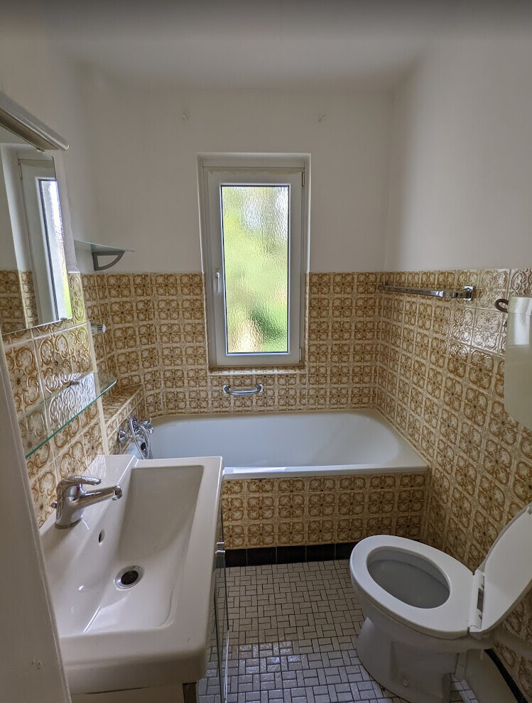

Bathroom → will be relocated to the opposite side of the building.

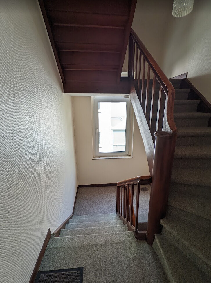

Stairwell – here the carpet will be removed, the wood sanded and painted:

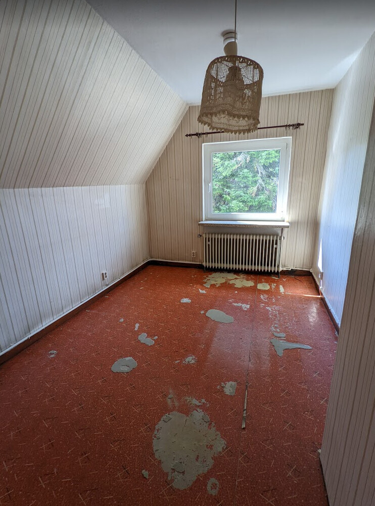

All rooms basically look like this – very high knee wall and ceiling height (2.65m (8 ft 8 in)) – resulting in almost fully usable living space. Beneath the “floor” there is well-preserved floorboard everywhere as well. Since nothing is glued down, we have already been able to look underneath many areas together with the floor specialist – so far it looks good!
Ground Floor:

Kitchen:
Upper Floor:

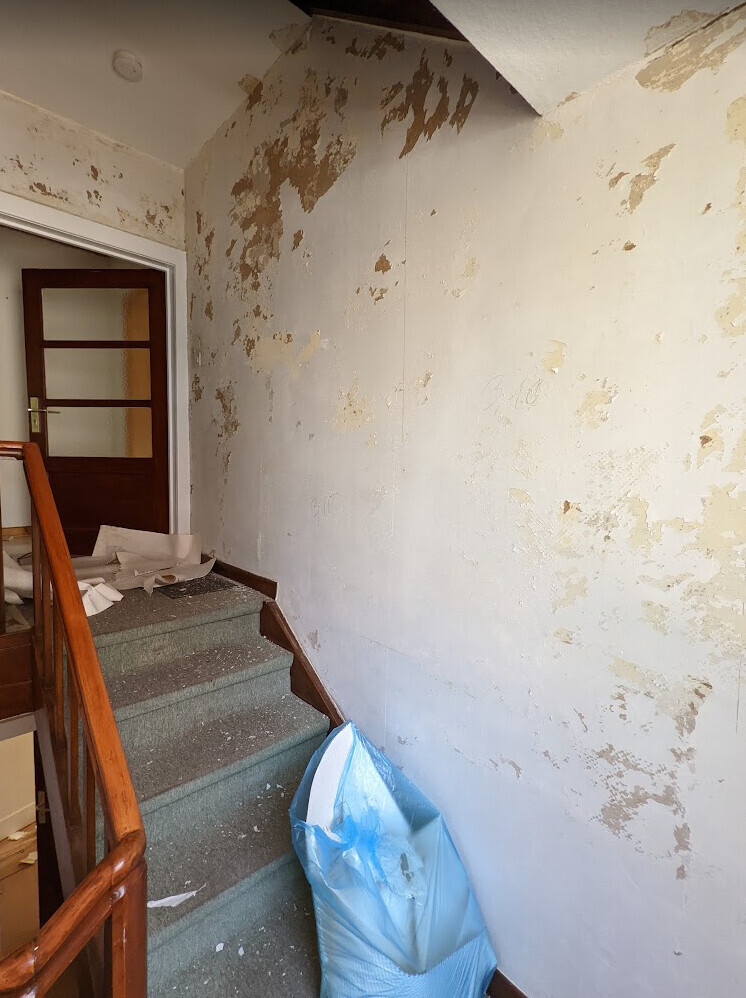

Here is the hallway, where there was fiberglass wallpaper that peeled off quite easily, but caused various superficial damages to the topcoat plaster:
On the ground floor, the plaster was hidden behind two layers of textured wallpaper and 5mm (0.2 inch) polystyrene interior insulation, so everything had to be scraped off (example from the living room). The walls look terrible, but this is also by far the worst room in terms of holes in the top plaster:

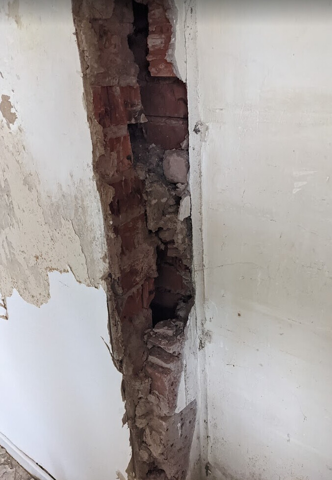

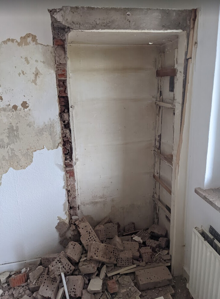

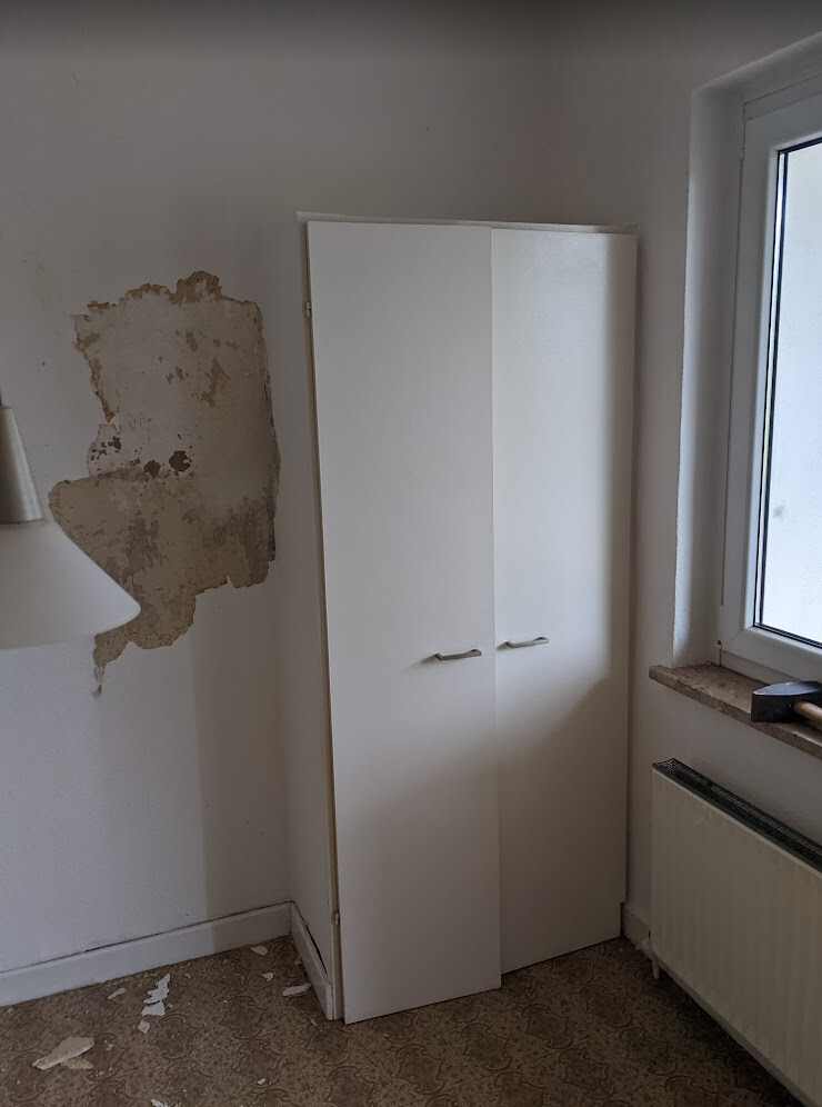

In the kitchen on the ground floor, there was this built-in pantry made of masonry:
You can already see the sledgehammer in the picture, which was used to break it down:
Problem: Apparently, a thermal bridge was deliberately created here in the past. While the house is generally built with a cavity wall, this pantry is a solid wall only. That means there is currently a small hole in the wall where you can see between the two brick layers. This will need to be rebuilt...

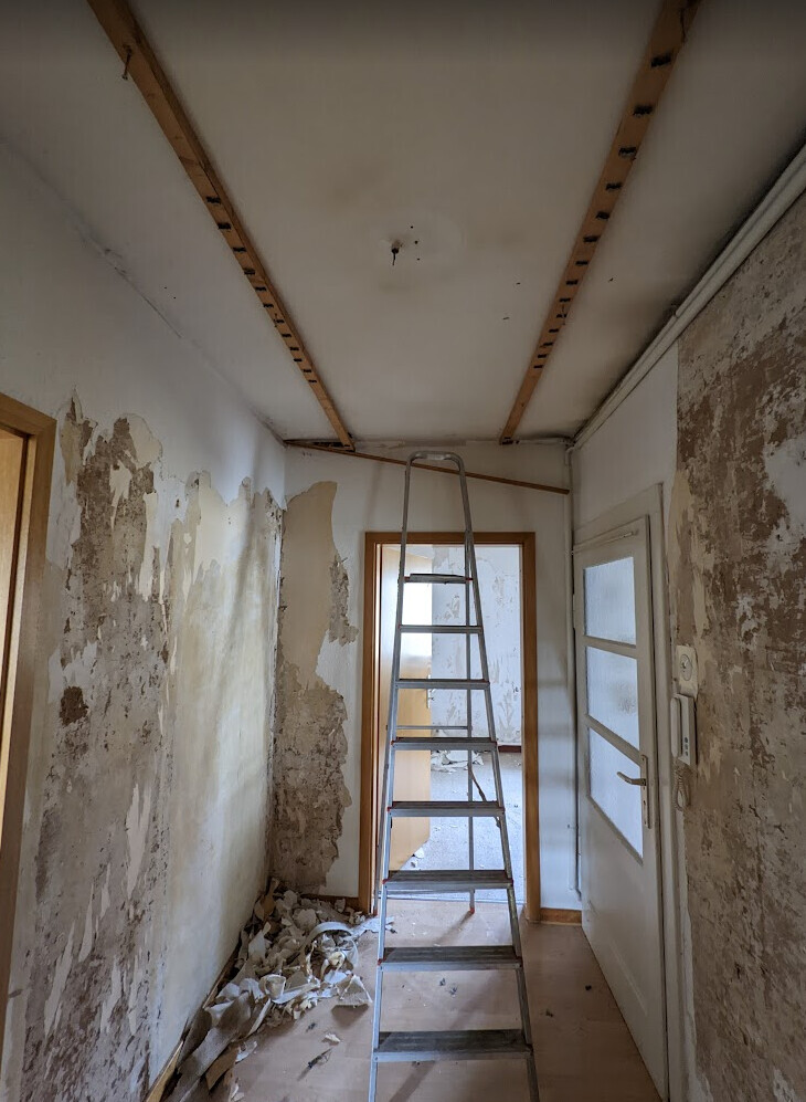

On the upper floor, the first ceiling panels have also had to come down:

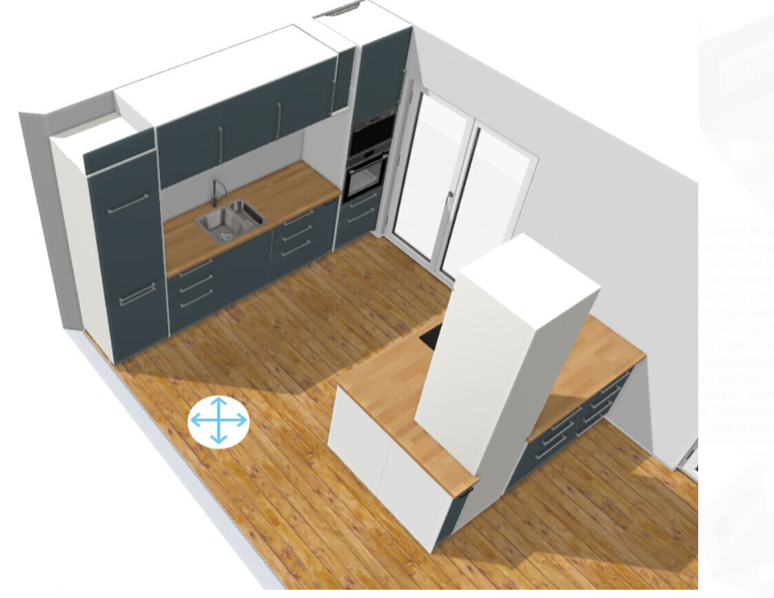

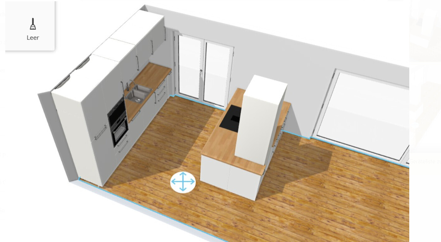

We’ve also started thinking about the kitchen. This might not feel urgent yet, but since we’re expecting child #2 in December, we want to arrange as much as possible now. We can already order the appliances and have the seller store them.
These are two quick options put together in about 30 minutes using the Ikea planner. The white column is the chimney, which will stay to allow heating pipes and electrical wiring to run through the house.
The upper layout looks more symmetrical visually, but the lower one is probably more practical (more light — there’s also a balcony above the door, which blocks light, and less obstruction from the door to the outside). The island measures about 1.2 x 2.1m (about 4 x 7 feet) minus the 80cm (31 inch) cooktop width on the side without the chimney. The countertop along the wall is approximately 2.1m (7 feet) long minus the sink. We do have quite a few appliances that need a place (large Kenwood kitchen machine 50 x 35cm (20 x 14 inches), Sodastream, small coffee maker, kettle, large bread box 40 x 40cm (16 x 16 inches), bread slicer). The bread slicer is planned to be hidden in a drawer, and we might replace the kettle with an induction version? Otherwise, the available space should be sufficient to place the appliances properly, right?
What do you think — does this make sense? 🙂
leschaf schrieb:
Problem: It seems that a thermal bridge was deliberately included here back then. While the house is generally built with a double wall, the closet is only single-walled, meaning we currently have a small hole in the wall where we can see between the two brick layers. This area will need to be rebuilt...A typical case of unclear explanation, I would say. The system being described as a "non-powered mini fridge" ;-) was fundamentally intended that way.https://www.instagram.com/11antgmxde/
