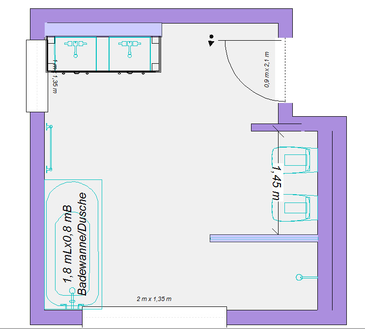

I would appreciate it if you could take a look at our bathroom layout plans.
Here is some background information:
We will try to schedule another appointment with the bathroom planner soon, but we don’t want to come completely unprepared,
so any tips are very welcome!
Thanks in advance and have a nice evening,
Hausbaufaehig
- 14.4m² (155 ft²), upper floor (full story), window sill height = 1m (3.3 ft)
- The designs are roughly oriented to the north; to the east of the bathroom, behind the drywall, the bedroom is mirrored. It probably makes sense to avoid placing the toilet on this wall.
- Design option 1 corresponds to the original plan, but the L-shape is not desirable (too cramped, too little light).
- Design option 2 was proposed by the bathroom planner, and a corresponding 3D rendering is included. I actually like it, but my partner dislikes the small partition wall as well as the view from the toilet towards the window.
- The other designs are my (failed) attempts to fit all sanitary fixtures in the room 🙁
- Required are: bathtub, shower (120x100cm (47x39 inches), mostly glass, with a door), toilet, bidet, sink (120cm (47 inches) wide)
- Dark, secluded corners are not desirable, so the T-shaped design is ruled out as well
- If necessary, we would also consider a freestanding bathtub, or possibly a corner bathtub, if that fits better.
- Adjusting the windows by a few centimeters or modifying the sill height on the west side would probably also be possible
- I imagine a bathtub in front of the windows might not be very practical, but I wouldn’t completely exclude it
- The windows face the street or the neighbor’s property, so the view is not a major consideration 😉

@ypg .. are you referring to version 4 from the introductory post or the version in post 4 (which I still like best .. optionally a partition wall for the shower at about 120 cm (47 inches) height with glass on top, or directly about 220 cm (87 inches) high. And you could also easily do without a shower door ... another thing that doesn’t require cleaning.

Hausbaufaehig4 Jul 2022 11:56ypg schrieb:
Your right alcove is actually ideal for a walk-in shower. There we go again with the V4 😉 Yes, the shower in the right alcove probably makes the most sense in all layouts, just like the washbasin on the northern wall. Then we basically only need to decide how to best arrange the bathtub, toilet, and bidet within the remaining space 😉
Maybe one more thing:
What bothers me about layouts 1, 4, 5, and 6 is that the toilet and bidet are immediately visible as soon as you enter the bathroom, which puts them on display. Layout 5 feels even less comfortable because you sit with your back to the door and yet still in a very central spot.
Myrna_Loy4 Jul 2022 14:44K a t j a schrieb:
Maybe this one as well:
[ATTACH alt="bad.jpg"]73091[/ATTACH]
What bothers me about layouts 1, 4, 5, and 6 is that the toilet and bidet are immediately visible as you enter the bathroom. In layout 5, it’s even less comfortable because you sit with your back to the door, yet still very central. This is great! Light coming from the left at the washbasin, close to the door, the bathtub placed quietly with a view. After bathing, if you want to rinse off quickly, the shower is nearby and also receives natural daylight. I would skip the bidet, use a washlet instead, and install a towel radiator on the shower wall.
motorradsilke4 Jul 2022 15:08K a t j a schrieb:
Or you can completely separate the toilet and bidet:
[ATTACH alt="bad3.jpg"]73095[/ATTACH]
This way, two people can use the bathroom and the toilet independently at the same time. That would be a pity for the nice, large bathroom.
