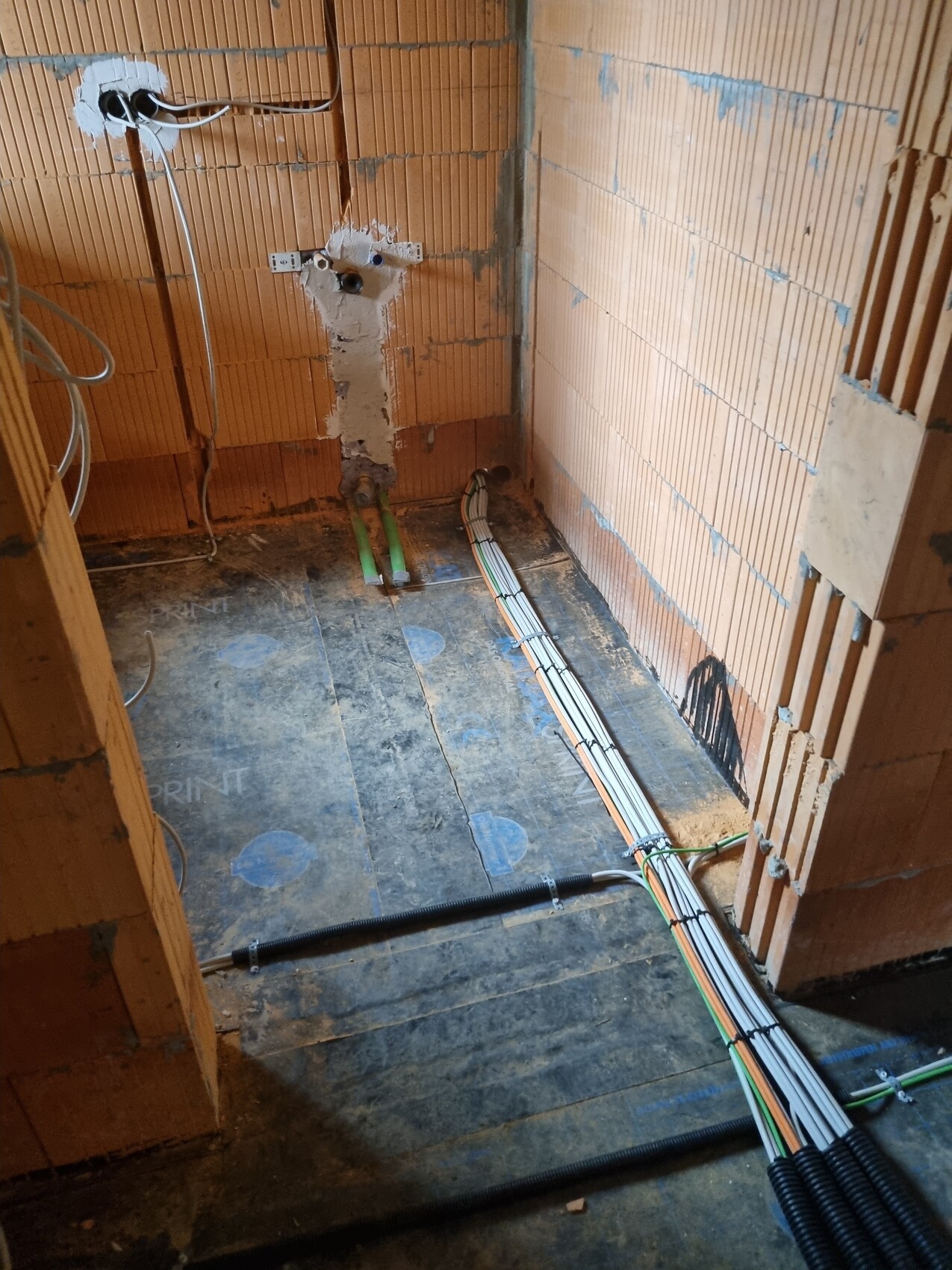

Is the thick grey area in the bathroom the wall plus drywall? The fixtures can also be installed inside the wall without drywall (see photos; the wall is 17.5 cm (7 inches) Poroton block). In the main bathroom, the bathtub plumbing is integrated into the exterior wall.
The main bathroom will have at least one double casement window, possibly two. Since it involves installation in the exterior wall, I will discuss it with our planner. Thank you!
