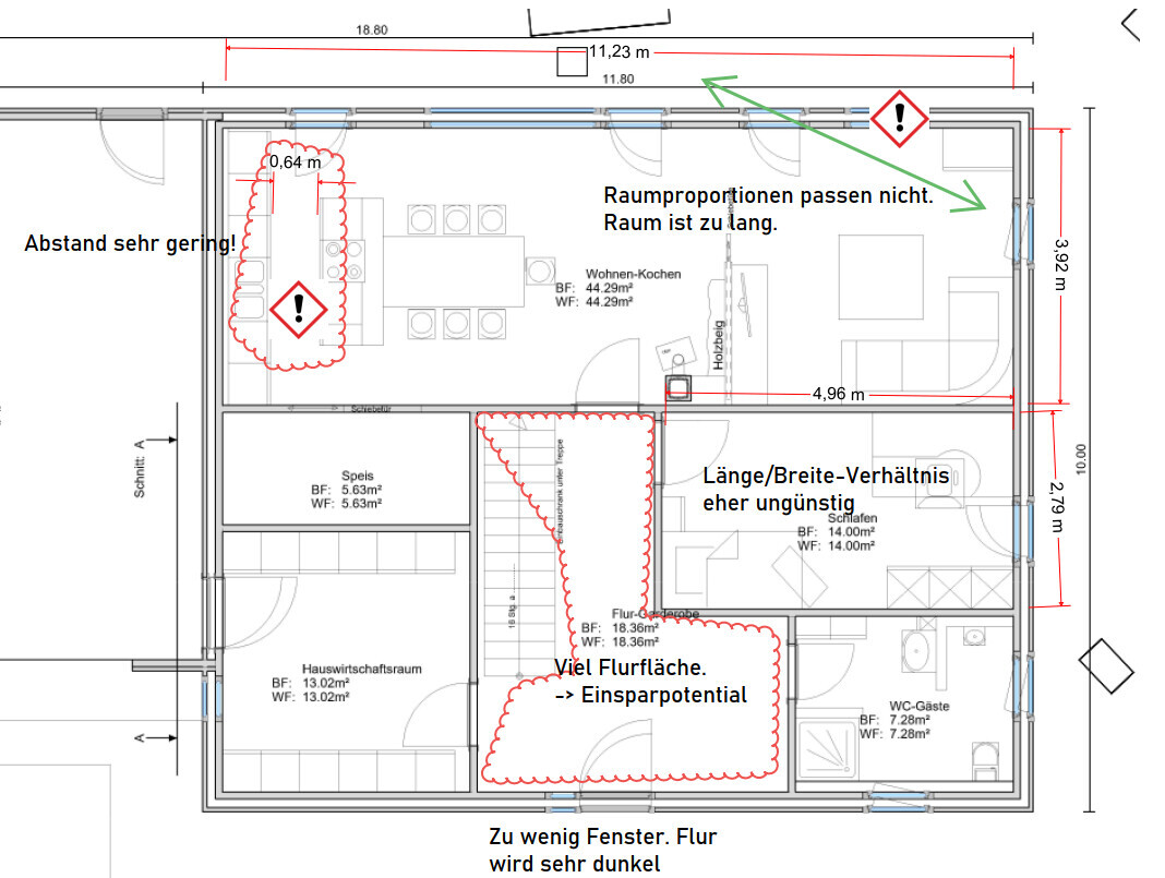

we have received approval for a plot of land through the "local resident model" in a rather rural area about 50km (30 miles) from Munich and are planning to build a solid wood house on it. The carpenter responsible has provided the attached initial proposal, which is largely based on our specifications and drawing. We will suggest some changes but are already curious to hear your opinions. The interior work will mainly be contracted to familiar craftsmen, while windows, hardwood flooring, kitchen, doors, and joinery work will be done by a family member as own labor.
Regarding the drawing: The south side (top of the drawing) faces the garden.

I agree with the opinions of the previous commenters.
This definitely needs to be revised.
Possibly even from scratch.
The proportions are dreadful. Nothing really fits together. On one hand, the hallways and bedrooms are excessively large, while the kitchen barely allows for any movement.
The open-plan living area is also far too elongated. Overall, the rooms are rather awkwardly arranged and tend to be narrow and long.
Without that staircase in the middle of the house, you would have much more freedom with less space required.
At the moment, the staircase probably doesn’t stand out either, because the area will be quite dark.
The bedroom(s) are huge but offer little space for wardrobes or similar furniture.
All in all, it’s wasteful but without real added value.

I also think you really need to revise this thoroughly.
However, as SoL already mentioned:
SoL schrieb:
With €450,000 you can’t build 200 square meters in Bavaria. However, they have €650,000 available.
That aside, I find the many narrow rooms a bit cramped. For good lighting in bedrooms, wider windows are better, placed deliberately so that long rooms receive light deeper inside. The open-plan area seems too narrow lengthwise; larger patio doors could have a very positive effect there.
A properly built wardrobe for five people is missing. Otherwise, I agree with @philipp’s opinion.
But you have 650,000 available.Yes, TOTAL BUDGET. I understood that as including the land (150,000 €).@Bockwurst1: Is the 650,000 for the entire project (including land, etc.) or just for the house?
Hausbautraum2021 Apr 2022 09:55I don’t like the room layout upstairs either. One child gets 12sqm (130 sq ft) and the other 23sqm (248 sq ft)?
For the budget, I thought 650k might be enough for the house, but including the plot, definitely not. Friends of ours (we also live 50km (30 miles) from Munich) got quotes for a 200sqm (2,153 sq ft) timber frame house (turnkey), and the price came to 700k. And solid wood is even more expensive.
