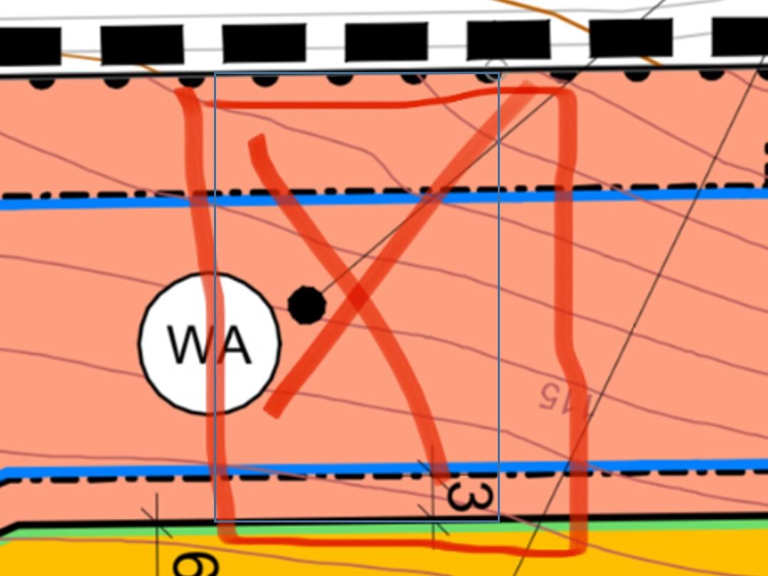

gutentag schrieb:
I marked the dimensions on the development plan. Your measurement error is more than 3 m (10 feet). You should be able to narrow down the property’s location—for example, is there a bend in the building line?
The thin blue line shows your property according to the survey plan. Unfortunately, it’s unclear whether the east-west orientation is correct. That is actually all quite clear.

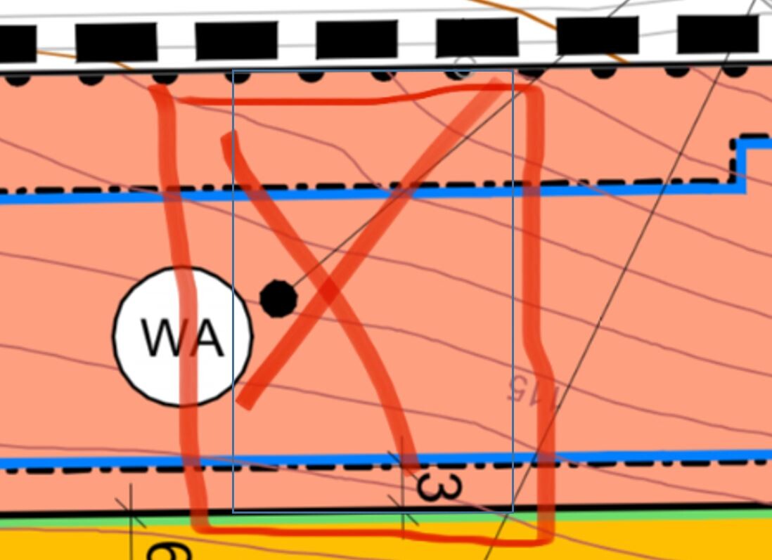

gutentag schrieb:
Why not do it like this from the start?
Now I have roughly placed the lot correctly.
On the east boundary, there is an elevation difference of about 5.7 m (19%) and on the west boundary about 5 m (17%). The street also has a slope of about 4%.
[ATTACH alt="Grundstueck123.JPG"]71220[/ATTACH]
Where should the garage or parking space be located?Thank you. The house will be positioned along the east boundary with the parking space there as well (the sewage inspection chamber is located there at the lower point). Additionally, the plots on the opposite side of the street are staggered slightly, so despite the north-facing slope, we won’t have too much midday shade – the larger windows will be positioned so that they face the 6 m (20 feet) gap between the houses across the street.
gutentag schrieb:
Why not do it this way from the start?
Now I have roughly positioned the plot correctly.
[ATTACH alt="basement-living-area-versus-more-living-space-on-ground-floor-571101-1.JPG"]71220[/ATTACH]
There is about a 5.7 m (19 ft) height difference at the east boundary and about 5 m (17 ft) at the west boundary. The street also has a slope of approximately 4%.

gutentag schrieb:
A north-facing slope is not easy. Do you at least have a nice view to the north? How tall is the house on the north side? Are there pictures of the plot?
In winter, you probably get little to no sun. That’s why, in my opinion, the large window front on the south side might not be very practical. Yes, the view to the north is beautiful, and we want to be able to look out at it from the sofa.
