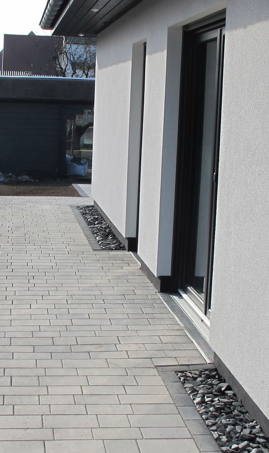

In front of all the doors that open, we have installed rain gutters. These are also meant to protect against driving rain. So far, no water has penetrated the seals.
In front of the main entrance door, an additional slot drain was installed. So if water should ever flow toward the house—which ideally shouldn’t happen—it could be intercepted there as well. Just a thought to consider.
We have installed these rain gutters in front of all floor-to-ceiling doors and windows, including on the terrace in front of the lift-and-slide element. Better safe than sorry.
