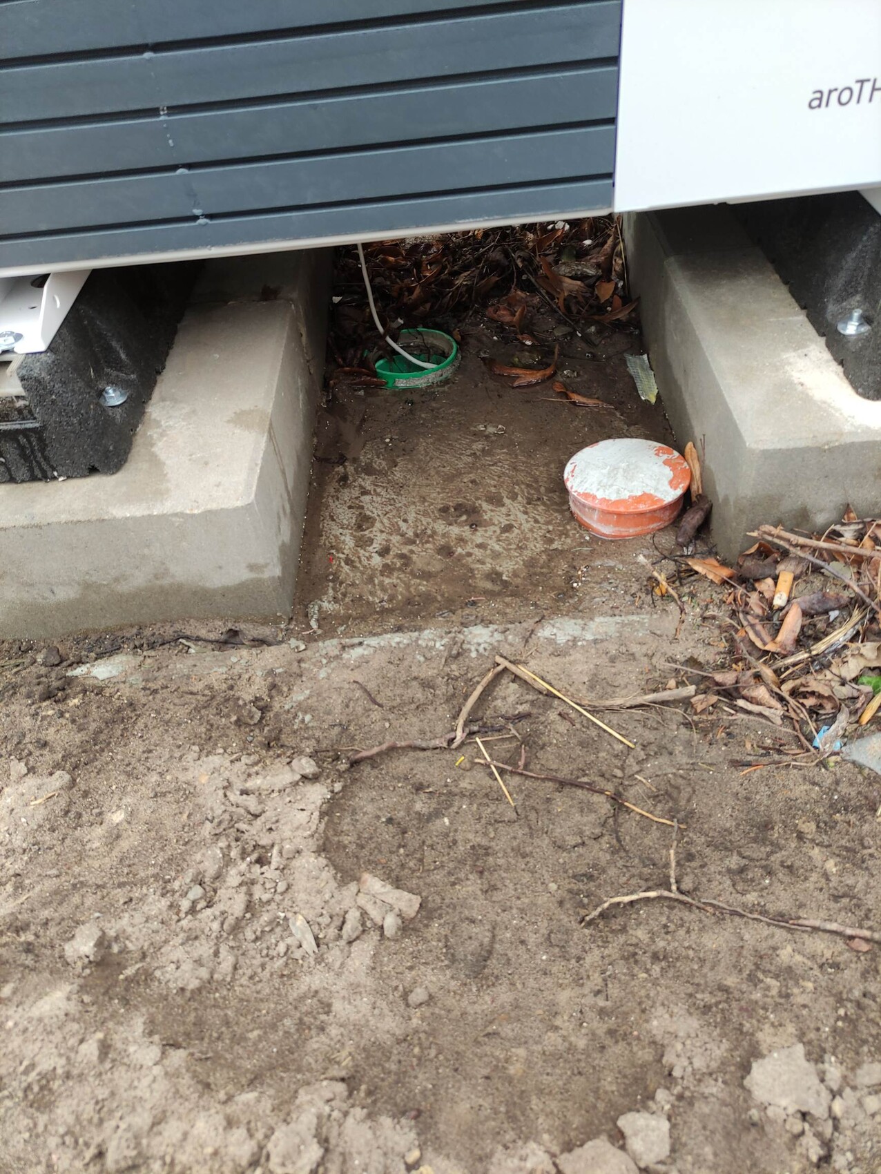

By the way, the heat pump seems to be releasing a lot of steam. Is it normal for it to be very damp behind and underneath the heat pump?
I get the feeling the condensate drain isn’t working properly, but maybe it’s just steaming so much that the moisture spreads in all directions?

Yesterday, our system was defrosting (steam cleaning) every hour. This is due to the high humidity. It will only decrease when the air gets even colder or rises above 6-10°C (43-50°F). Then it stabilizes again. It is important that your condensate drain is functioning properly. The water should be effectively drained, not just flowing down into a closed pipe. On Saturday, my system used 8 kWh, and yesterday it used 26 kWh. As mentioned before, it was cool with high humidity all day and night yesterday. 😕
At the back, it is only damp because the collectors are defrosting there, and the water is flowing down. However, everything stays dry inside for us because the water is collected internally and routed out through the inner drain to the outside.

Ok, then something is definitely wrong, I think. Maybe the drain inside is somehow clogged. You can easily check this when it defrosts. A good amount of water should drip out from the bottom—and only there. That’s where your small white tube is hanging out.
