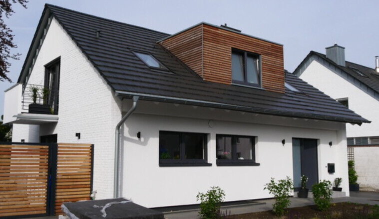

Visually, we imagine the house to look somewhat like this, in terms of color, the dormer, and also the dark window frames, etc.
Modern white single-family house with dark pitched roof, wooden dormer, and garden.

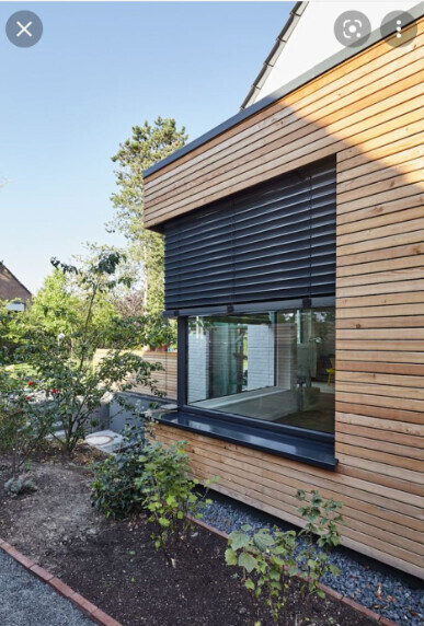

Along with a long extension reflecting the timber of the dormer, similar to this:

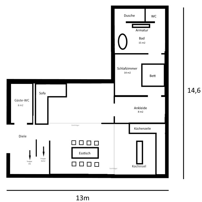

New plan here: I have marked in gray the walls where an opening would need to be made. Do you think this is structurally feasible?
Floor plan of an apartment with shower, WC, bathroom, bedroom, dressing room, kitchen, dining area, sofa.
The bathroom and parents’ bedroom practically overlook the garden. Spa retreat or mood killer? 😀
Is a passage through the dressing room into the parents’ bedroom okay, or what do you think?

Nida35a16 Jan 2022 16:36
That looks like a feasible plan. Whether the structural design works will be calculated by the structural engineer. The sequence of the dressing room, bedroom, and bathroom is viewed differently here. The arguments will surely be presented. For us, it would be dressing room, bathroom, and bedroom.
If she has Sissi or Top Gun in the home theater, or he needs to leave early, it is quieter to sleep in the rear.
The living room has a lot of foot traffic.

WE have not progressed as long as you do not share the development plan with us. So far, nothing has been proposed that seemed unfeasible to me (with four decades of experience in this field). By the way, the current house is single-story, and attaching a shipping container with a flat roof to the house does not seem appropriate.
zizou89 schrieb:
New plan here: I marked the walls in gray where openings would need to be made. Do you think that is structurally possible?
[...] Please be completely honest. Any kind of criticism helps me.
What’s the point if you don’t accept the criticism and still draw nonsense like partially removing existing exterior walls? – if steel isn’t playing the role of a Rolex, almost anything is possible structurally, but then there’s no budget left for anything else ;-)
Which basic software are you even using for your floor plan tinkering?
It’s almost an art to carelessly sketch proportions whose correct dimensions you know!
For us readers this is just exhausting, but for you it seriously diminishes the chance to gain clarity :-(

Why bother if you don’t accept the criticism and draw nonsense again, like peeling away parts of the existing exterior wall? If steel isn't acting like a Rolex, almost anything is possible structurally—but then there’s no money left for anything else ;-)
What beginner software are you even using for your floor plan tinkering? It’s almost an art to sketch proportions incorrectly when you know the correct dimensions! For us readers, it’s just exhausting, but for you, it costs you a crucial understanding :-(
Which software can I use? I really have no idea, as you can tell.
For me, the main goal is to be able to explain to an architect soon what I might want, without just saying, “Here’s my plan, finish it for me 😀”
I’m already trying my best to make it at least somewhat understandable.
