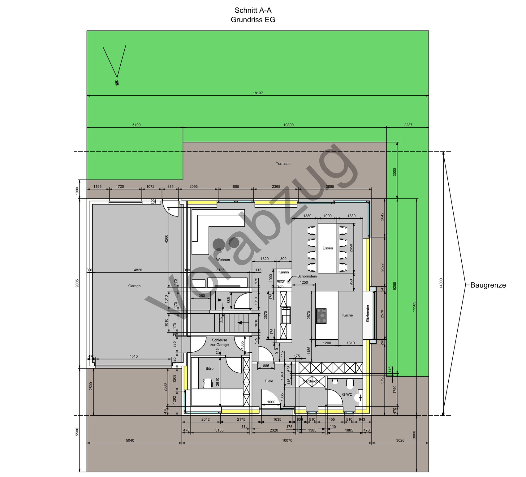

I have revised the ground floor layout and incorporated some of your great ideas, and now I’m really looking forward to your feedback.
The windows are still shown as before. I will update them once the interior concept is finalized.

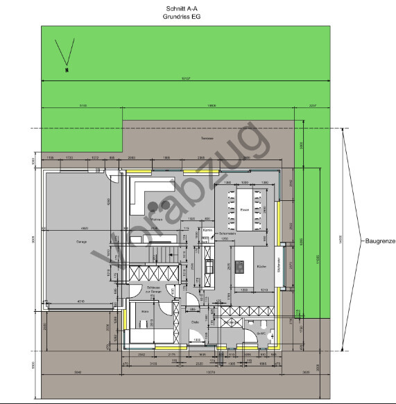

Tomorrow, I will take a closer look at the attic floor. Many thanks for the layout, Kati 🙂.
I find the solution in the kitchen very well done, but not the airlock at all.
The office here is no longer the typical driver’s room, but the location and window actually make it more like a gatehouse.
Kati.com schrieb:I’m not against it either, if it fits properly. Unfortunately, homeowners often stubbornly insist on something that only causes problems. Here, there is now a hallway that is only 103 cm (40 inches) wide in the rough wall opening and over 300 cm (118 inches) long, almost in darkness. Then there are the even narrower toilet doors... You can’t tell me you like going in here, @Kati.com.
Why is everyone against it? It’s important to me to have direct access to the garage as well. Especially when the garage is so large and has space not only for cars but also for other small items.
I’m also not against it if it fits. Unfortunately, very often the client develops a stubbornness during construction that only causes negative outcomes. Here, we now have a hallway that is 103cm (41 inches) narrow according to the RBM and over 300cm (118 inches) long, practically in darkness. Then there are still the narrower toilet doors… You can’t tell me you enjoy going in here @Kati.com.
The office is no longer the traditional driver’s waiting room, but the location and the window actually make it a gatehouse. Hello ypg,
thank you for your feedback. We are always open to suggestions and improvements. How would you redesign or carry out this area?
The doors have not been adjusted yet!

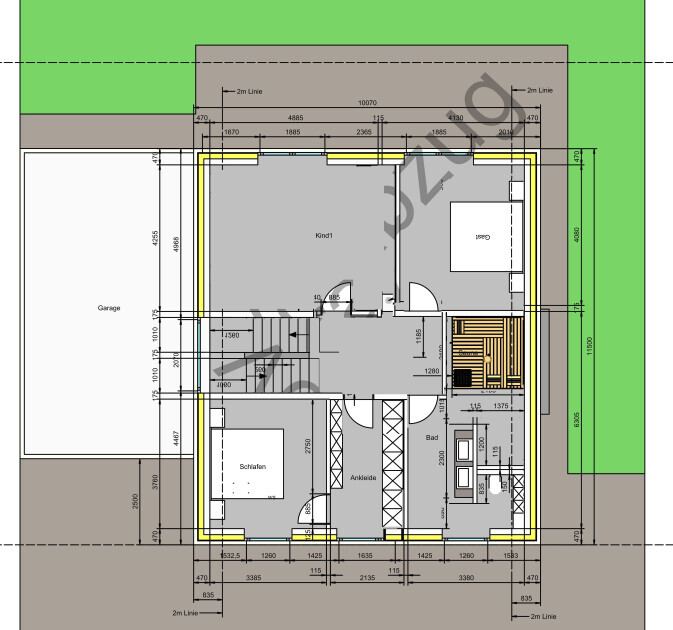

Idea for the ground floor: Reverse the staircase direction, install a large built-in closet underneath, and connect it via a small vestibule. This creates a great wardrobe area when entering the house from the garage. I don’t like the sofa’s current orientation; I would rotate it to face the garden, with the TV either mounted on the extended fireplace wall or to the left of the living room window. Another idea, if 8sqm (86 sq ft) is enough for the guest room: place the guest room on the ground floor and convert the guest toilet into a shower bathroom. Upstairs, have a home office instead of the guest room.
Idea for the upper floor with the reversed staircase direction (self-explanatory):

Idea for the ground floor: reverse the staircase direction, create a large built-in closet underneath and connect it with a small anteroom. This results in an excellent cloakroom when entering the house from the garage.I think this suggestion is very good. The downside is that you don’t have any storage room now. Neither under the stairs nor in the kitchen... But you have a large kitchen with plenty of storage space... and don’t forget—a basement. I also like the solution on the upper floor. However, I would place the door between the dressing room and the bedroom at the front to keep walking distances shorter.
@jpg – yes, I also find the 1m (3.3 ft) wide long corridor extremely narrow. It should be at least 1.3m (4.3 ft).
