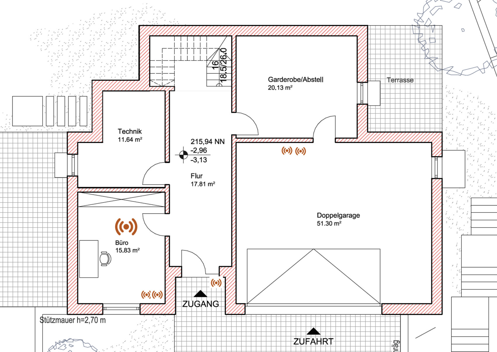

Basement: 6 connections
Office with double outlet occupied and space for an access point on the ceiling
Entrance for door station (camera)
Garage double outlet for wallbox (electric vehicle charger)
We will confirm details for the technical room
Floor plan of a house with technical room, office, hallway, cloakroom/storage, double garage, terrace.

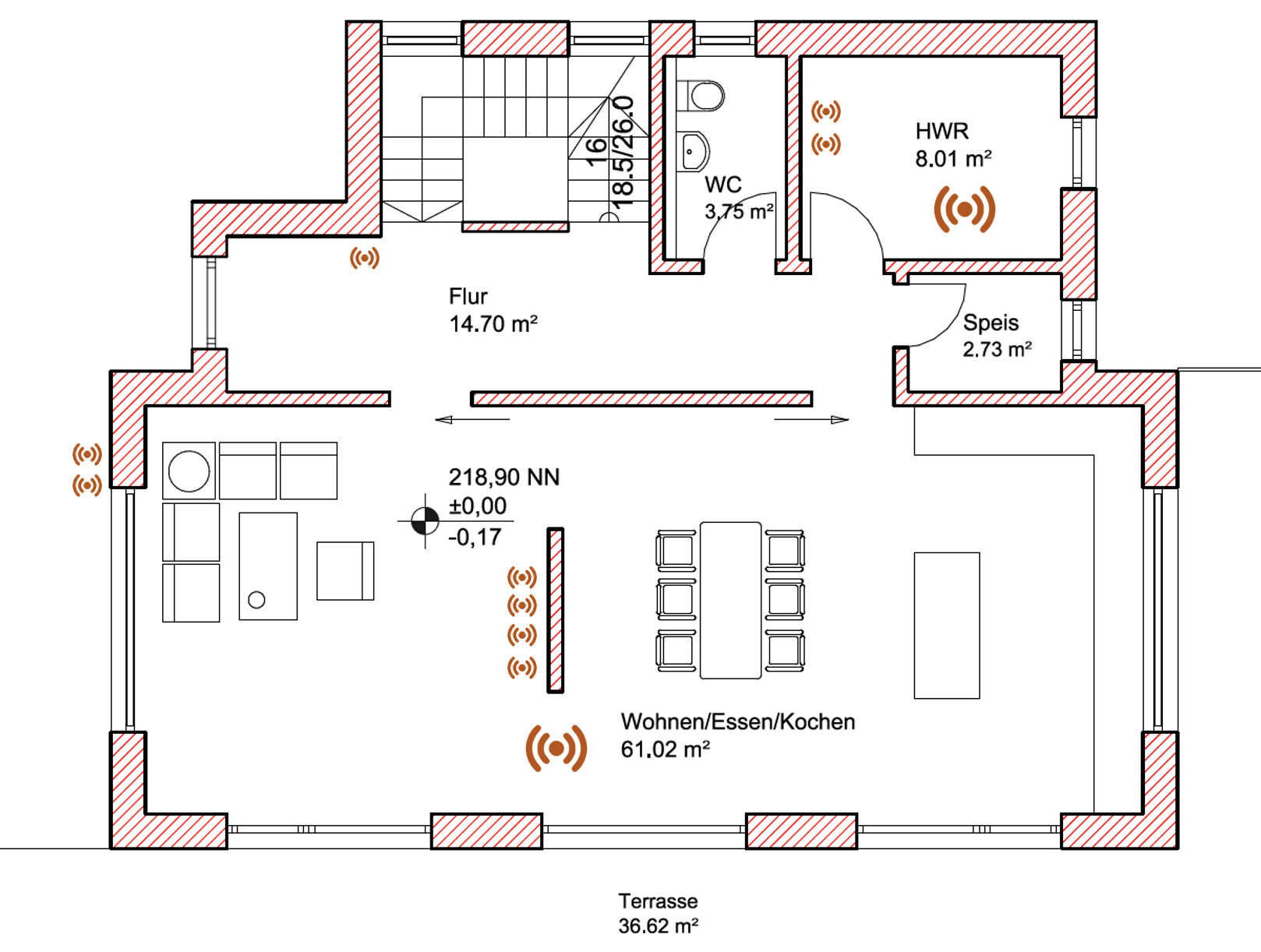

Ground floor: 11 connections
2x double outlets at the TV
2x access points (transition between living and dining areas)
Double outlet in utility room
2x outside for awning/shading and outdoor access point
1x for indoor door station
Floor plan of a house: hallway, WC, utility room, pantry, living/dining/kitchen, and terrace with Wi-Fi symbols.

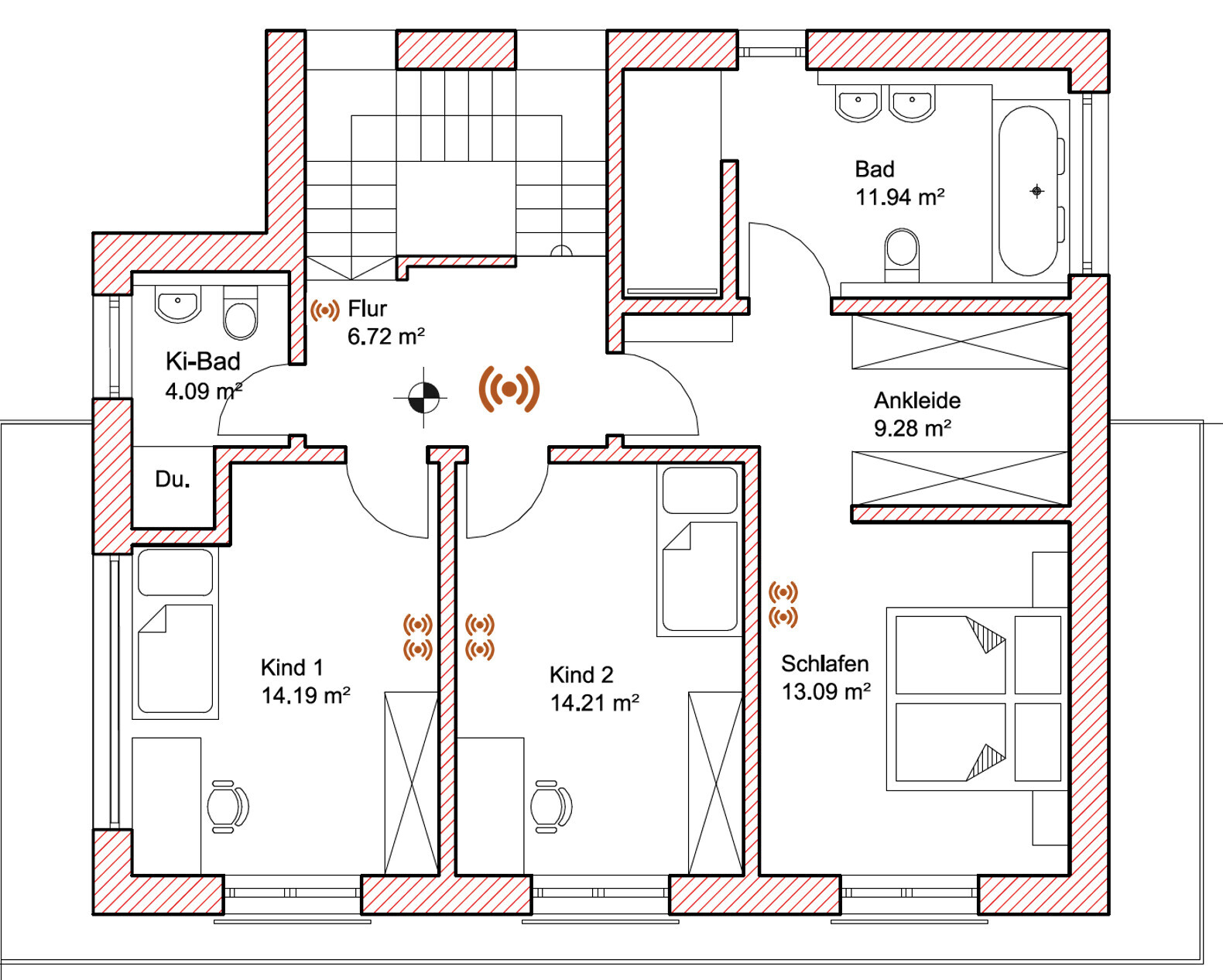

First floor: 8 connections
One double outlet each in the children’s rooms and the bedroom
1x for access point in the hallway
Floor plan of the first floor: hallway, bathroom, dressing room, children’s bathroom, shower, two children’s rooms, bedroom.

Mycraft4 Jan 2022 12:07
majuhenema schrieb:
That is very smart!
This is the usual approach. But yes, it hasn’t reached all electricians yet.
1. No, neither.
2. No, still stick with four here.
3. Yes, probably one would be enough in the bedroom.
4. 24 will be sufficient for your plan.
In the utility room, you simply don’t install any sockets. Here you can always patch directly because in most utility rooms I have seen, the wiring is surface-mounted anyway, and there are always enough connection points available.
