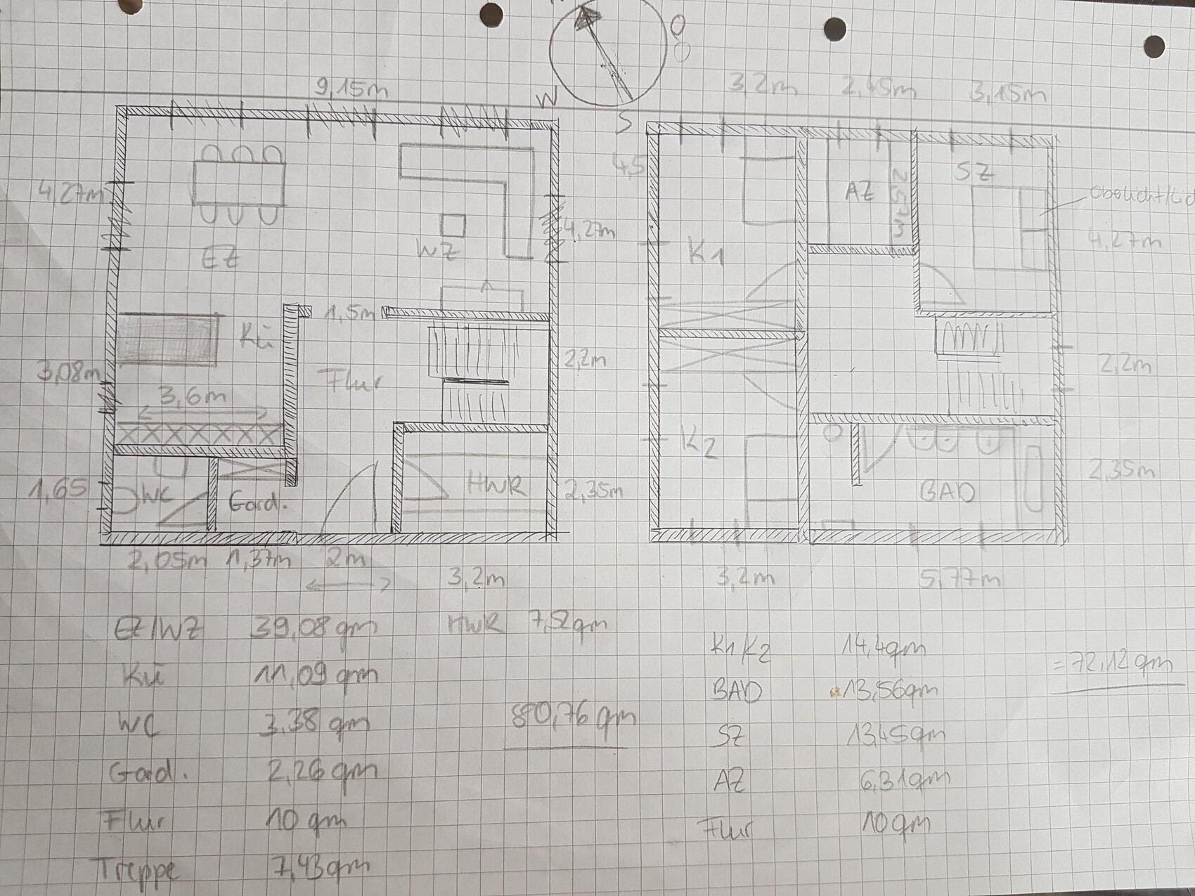

prm2021
21 Nov 2021 17:03
Does anyone know the room sizes for the Medley 3.0 100? How wide is the living room? Is it possible to slightly enlarge the dining and living areas while reducing the stairs, WC, and wardrobe? Or to increase the overall house size by a few square meters so that the combined dining-living area is at least 35 sqm (375 sq ft) or at least 3.8–4 m (12.5–13 ft) wide?
I found a similar example of the ground floor from someone in this forum (in gross square meters).
I was thinking about narrowing the hallway, enlarging the stairs, living room, and utility room, and increasing the dining-living area to 3.8 m (12.5 ft)
(to get as close as possible to the “magic” 35 sqm (375 sq ft) threshold).
Thank you very much
Thanks
