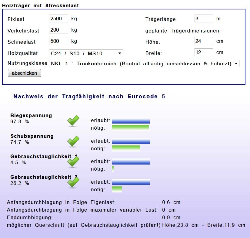

If I stack existing and new beams on top of each other, I get about 33 cm (13 inches) in height. For the calculation, I only entered 24 cm (9.5 inches) and increased the estimated load from 2 tons to 2.5 tons. I also added additional loads (snow, live load, even though there is none). The result was positive. Image:
toxicmolotof17 Nov 2013 19:23An online calculator cannot replace professional advice. I would not undertake this without a structural engineer, even if I found 10 calculators online. I wouldn’t even know what data to enter.
