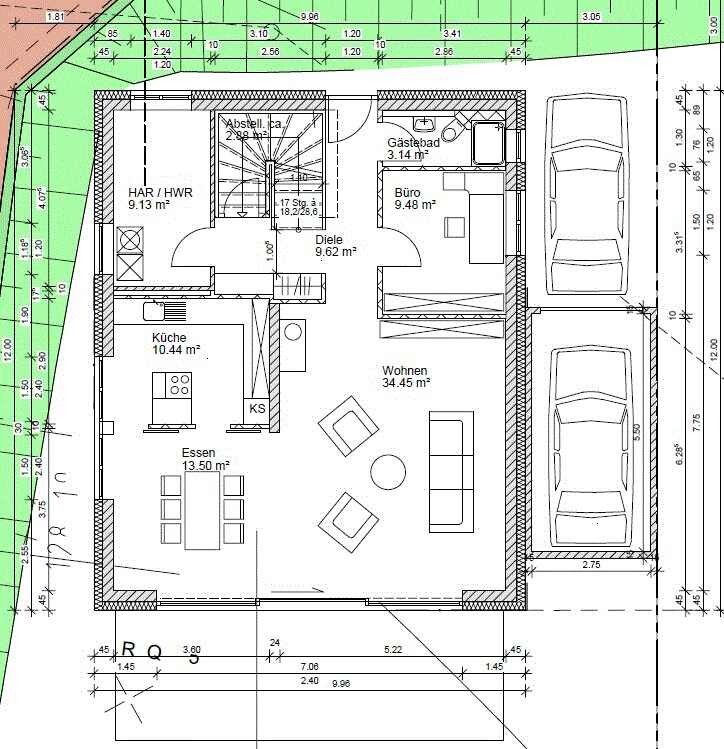

We will somehow reposition the shower on the ground floor. Possibly take part of the office space for it.
I have a question about this: can I simply swap the utility room and the office?
Our architect said that would be problematic because the main utility connection has to be routed into the utility room, which should be located at the side facing the street...

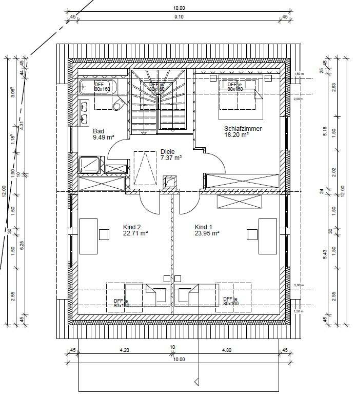

Upstairs in the bathroom we will reposition the toilet. Possibly behind the door, where the closet is, and enlarge the bathroom slightly in that area.

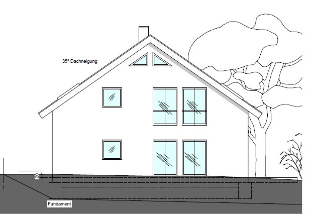

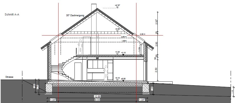

A dormer would improve the exterior appearance of the house. However, according to the architect, this would exceed the allowed size for the upper floor. Only one full storey is permitted.

Hausgrundriss mit offenem Wohnbereich, Küche, Essbereich und Garage.
Grundriss des Obergeschosses mit Schlafzimmer, zwei Kinderzimmern, Bad und Diele.
Schnitt A-A durch Wohnhaus mit Treppe, Geschossen und Dachkonstruktion

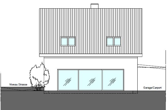

Architekturzeichnung eines Einfamilienhauses mit Fundament, 35° Dachneigung und Fensterfronten.
Moderne Hausfront mit großen Glasfenstern und Glas-Schiebetüren im Erdgeschoss

The placement of the toilets is not really my preference. On one hand, it’s practical (shared plumbing), but on the other hand… well, I think my wife would object if she’s in the bathtub and I urgently need to use the toilet :p. The same goes for the shower room.
Is there a specific reason for having two sliding doors? In my opinion, it doesn’t make much sense—except for extra costs. One would be enough.
Do you plan to convert the attic later on? Otherwise, I believe that with a ventilated roof covering, the windows in the attic are unnecessary (this was explained to us by our builder and architect). I hope I understood that correctly. We decided to install only a roof hatch, as the attic will be used solely for storage. Apart from that, custom-made windows can be quite expensive.
Nice design with a lot of natural light. I couldn’t actually manage something like this. My wife would probably refuse to clean the windows 🙁. Or I would have to hire a company for that.
