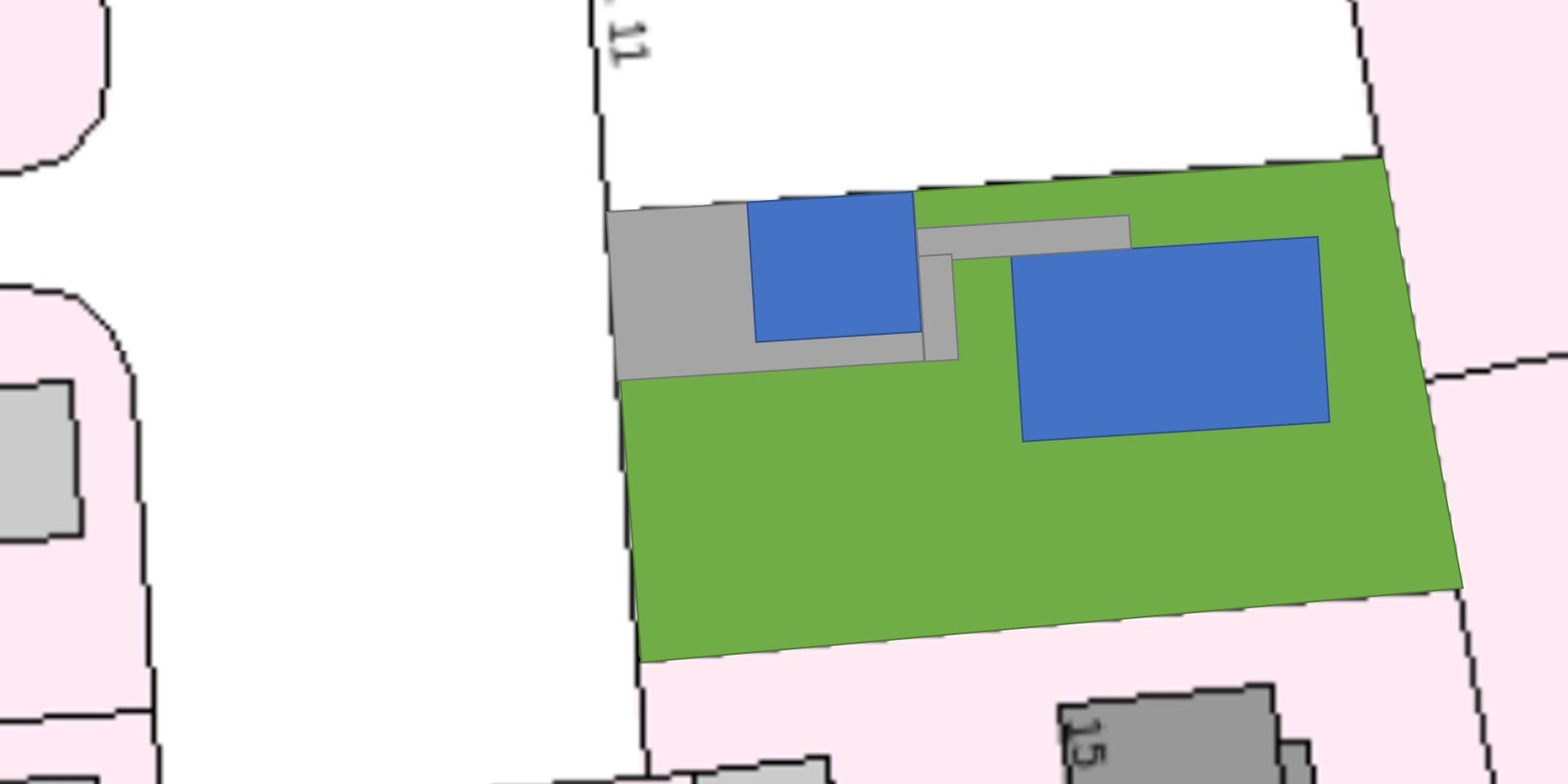

Does the garage have to or should it be connected to the house?
If not, perhaps consider something like this:
If yes, with such a generous budget, you could even imagine a garage partially built underneath the house. And that odd balcony appendix on the east side could be replaced by a rooftop terrace above the garage on the west side.
That was my first thought as well. Although there is a desire to keep the west side open, this comes at the expense of the south (4m (13 feet) of space is not much). I would rather try to create some extra space on the south side, especially since the fireplace and living room are located there. If, instead of a solid garage, a more open carport is placed in the northwest, it would also provide more privacy from the neighboring northern property. Perhaps the house could be rotated 15–20° clockwise?
How does the 42 cm (16.5 inches) wall construction come about? The, let’s say, "emancipated" arrangement of the load-bearing walls (which also seem excessively thick to me) will definitely make the structural engineer scratch their head. And of course, I see plenty of planned construction flaws again. The sliding doors integrated within the walls also do not seem optimally designed to me. The kitchen is, in my opinion, too small, and both the bedroom balcony and the living room projection are costly luxuries. I recommend, although by no means “everything is bad,” a redesign (including separating the building units "house" and "garage").
How should we imagine this setup? The architect seems to me more than just newly qualified—I would even say still fresh out of the oven—if she hasn’t noticed the many cost-increasing inconsistencies.
What exactly does that mean?
I believe the review by the structural engineer will prompt a reset (unless the 5 million budget really is feasible and you are firmly determined to proceed with it).
