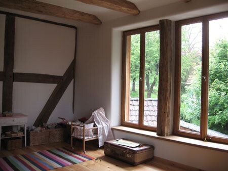

Since people often like to get unsettled, I took another look at the windows.
So, like in this example,
Interior with visible wooden beams, large window, and furniture during renovation
I find it quite elegant (except for the wood).

Floor-to-ceiling windows are becoming less appealing to me.
