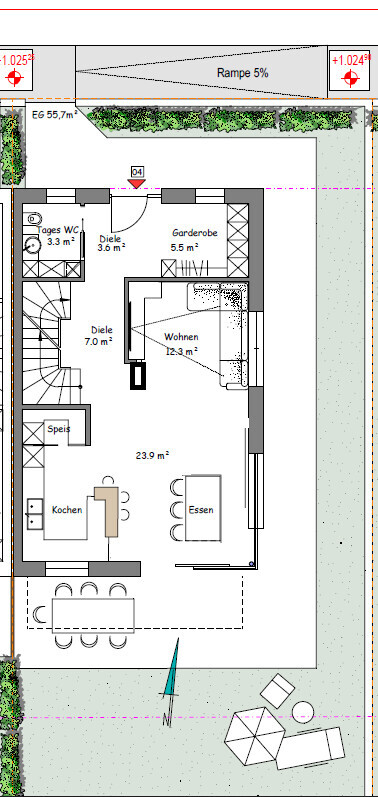

Attached is the latest draft from our architect, including furniture, which does not yet contain any changes since the meeting is still pending. In the next post, we will share some ideas we developed based on this.

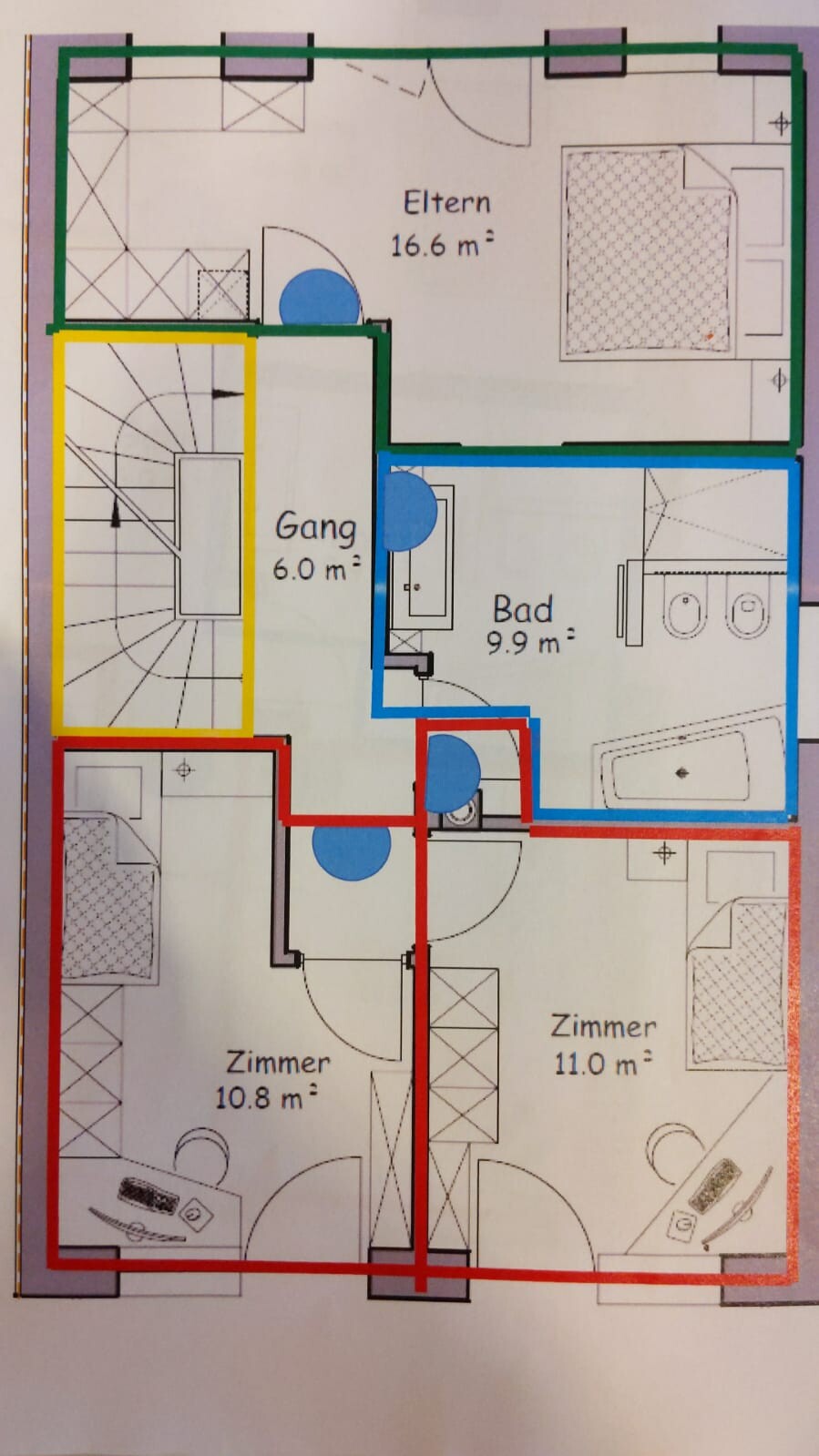

Idea for the upper floor, only the colored lines are mine, drawn over the original plan.
In the bathroom, you could install a shower at the bottom. Right next to the shower exit, I would have a radiator installed to warm the towels 🙂
Another advantage is that the entrance to the left child's bedroom is better positioned, and the hallway becomes a bit smaller.
On the ground floor, we would remove the wall between the living room and the dining area. The wall on the left would be replaced by the wood stove, which is like a half-height wall. The fireplace will need to be relocated but should align well with the bathroom upstairs.
The cloakroom and the guest toilet would be swapped, and we would also add a shower in the toilet.
Looking forward to your feedback 😉
