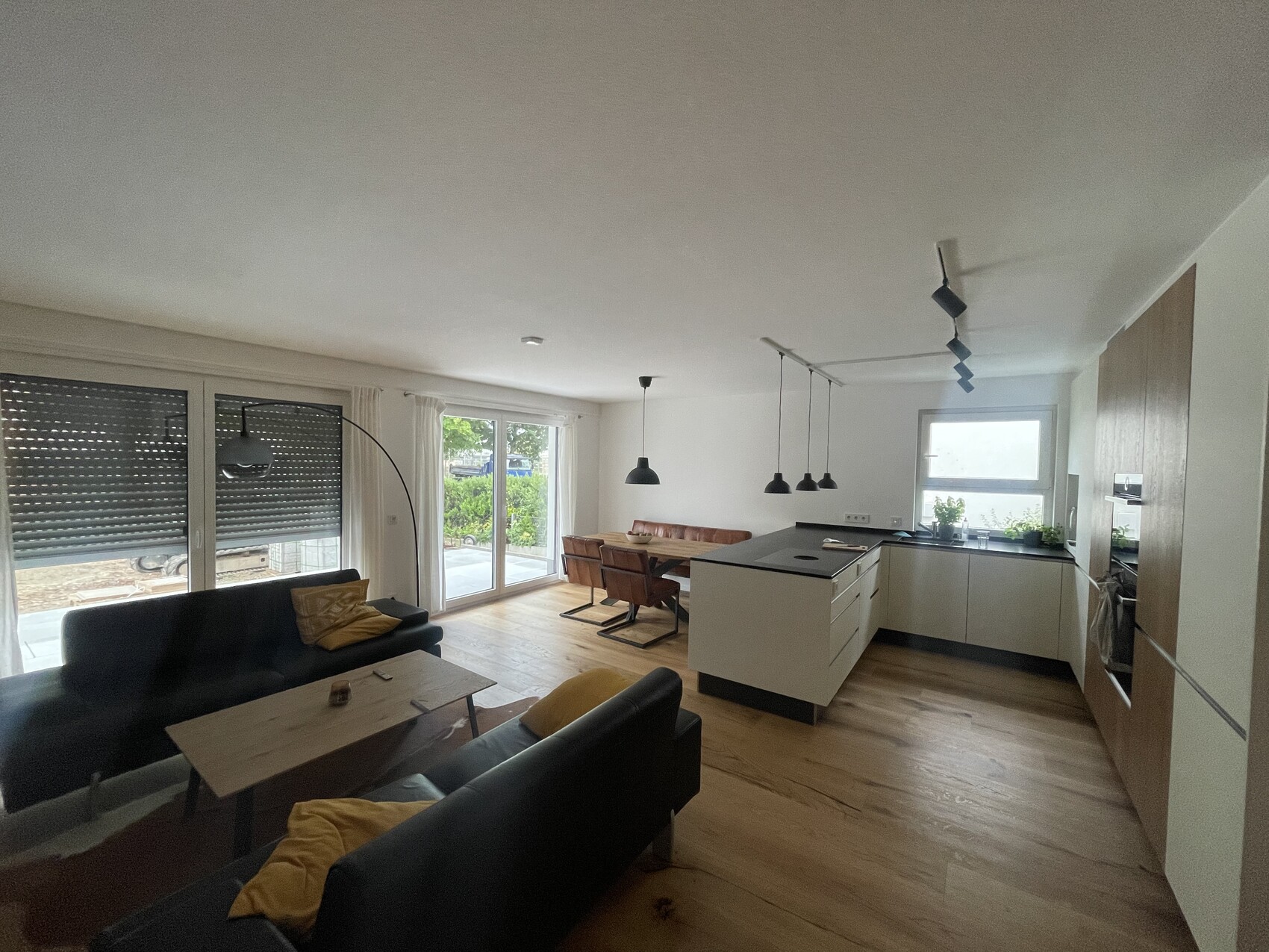

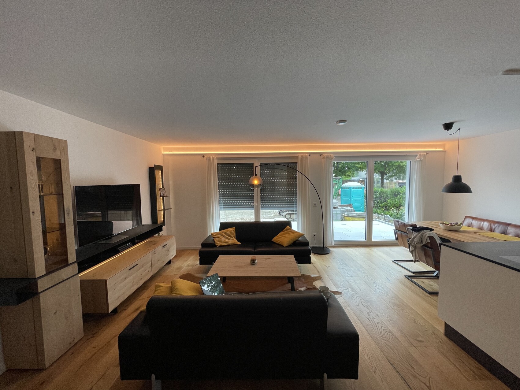

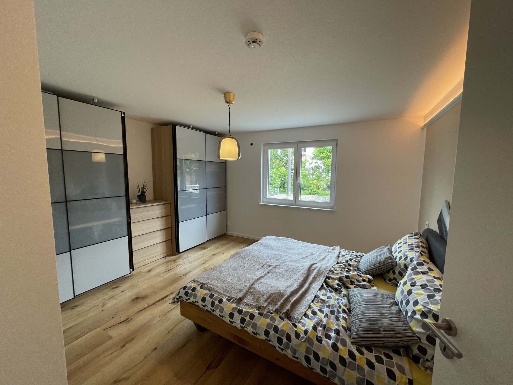

NoggerLoger27 Jul 2021 17:23Light benefits from a combination of different fixtures: direct, indirect, and accent lighting. In every room, I have a light cove along one wall connected to the standard ceiling outlet. In the living room, this is combined with the dining area. This was almost the only solution since we purchased the apartment while it was still under construction. The only thing that still bothers me is that, due to the fixed segment lengths of the LED strip in the living room, it stops earlier on the right side than on the left.
If you still have freedom of choice, use all aspects of lighting, but never cover everything with spotlights on just one side.
Also, be sure to account for the light loss caused by the diffuser on LED strips (30%) and the reflectance of the ceiling when planning indirect lighting.
