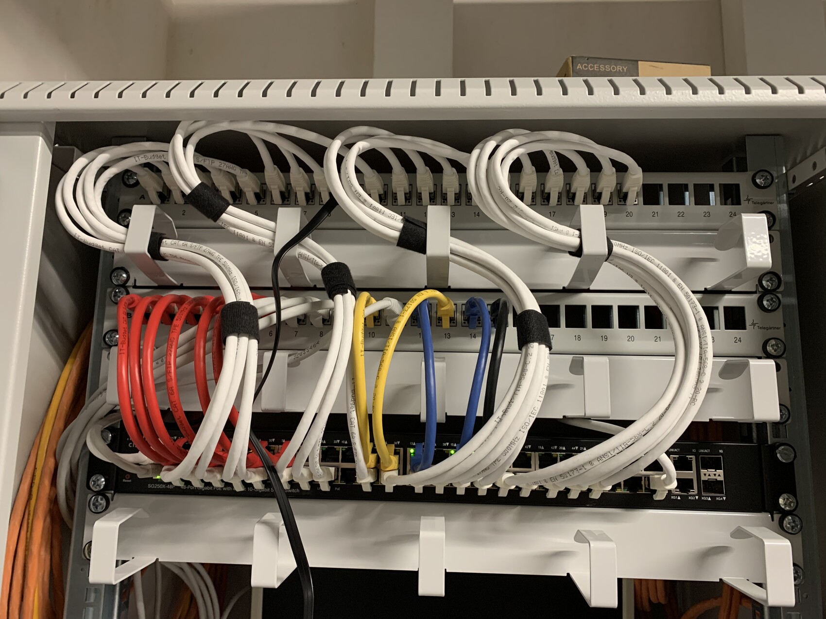

hampshire13 Jul 2021 17:12The way you describe the electrician gives a very good impression. The recommendations are also customer-friendly. We have a similar Keystone solution as @untergasse43, but much less extensive. Since the DSL and Wi-Fi routers are located elsewhere and we only added two small 8-port switches, the heat generation is so low that we don’t need any ventilation.
Tarnari schrieb:
Here’s another example with two 24-port panels and one 48-port PoE switch. Keystone jacks are really very practical. I would definitely recommend using them.
But the cable management is just for show, right? :pK1300S schrieb:
But the cable management is just for show, right? :p You mean the colors and Velcro straps? Yes, definitely. I hate messy cables. Otherwise, it’s nowhere near my standard. As is often the case, a lot gets left unfinished right after moving in. I deliberately left out the messy part underneath with the NVR and modem.
As I said, this quirk comes from my time as a PC junkie. Every computer I build has to have "invisible" cables. Assembling the components takes about one-tenth of the time I spend on cable management. Like I said, it’s a quirk.
