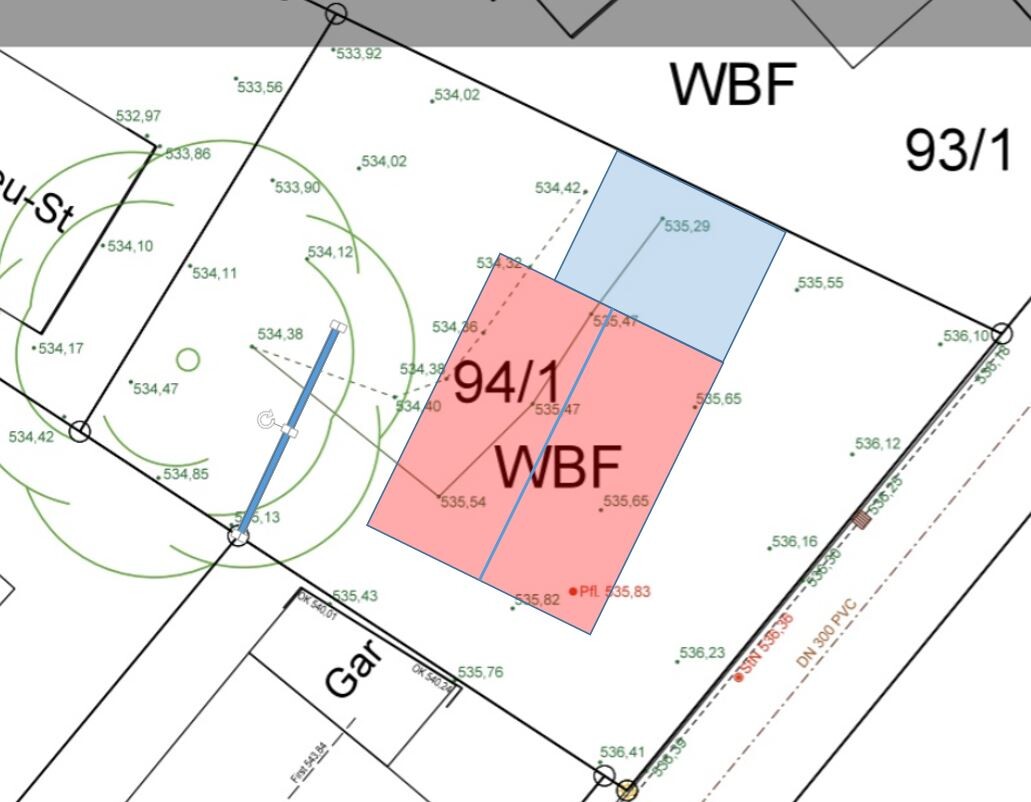

Here is a thought. The wall is meant to support the terrace at ground floor level.
Site plan: red 94/1 WBF rectangle next to blue area, property boundaries and coordinates.

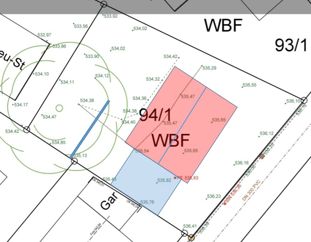

Or like this?
Site plan: plot 94/1 WBF with red building area and blue adjacent section, survey lines.
Si0n198912 Jul 2021 10:14
Ventreri schrieb:
The wall blocks are practical but not particularly cheap at 200 per m² (200 per 10.8 sq ft). I received a quote from the landscaping contractor for retaining walls made of shell limestone at 200-220 per m² (200-220 per 10.8 sq ft), fully installed.
Besides planting, do they have any other advantages (for me as the builder and not as the wall installer)?
You can transfer a load of up to 5 kN per m² (466 pounds per sq ft) without a concrete foundation for walls up to 8 meters (26 feet) high. Also, the wall blocks are reusable like building bricks if you ever want to remodel.
hanghaus2000 schrieb:
Here’s something to think about. The wall should stabilize the terrace at ground floor height.
Or like this?
The first idea could work, but you would also need to support the neighboring property and to the north, which means instead of one wall, you’d need three retaining walls or a full platform, which would be more expensive. Additionally, you would lose window area in the garden level and the remaining windows would get less natural light from the west.
I had also considered the second option. However, the layout on the ground floor didn’t suit us. We have now spent about two years on the floor plan and don’t want to change it fundamentally. From the carport, you enter our storage room through a side door and from there into the kitchen. If we move that to the other side, all rooms would have to be rearranged. Even simply mirroring it doesn’t give the desired result.
