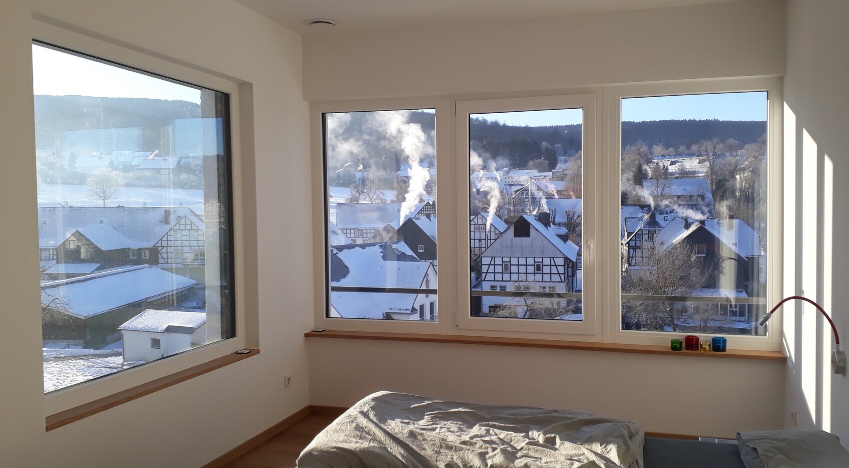

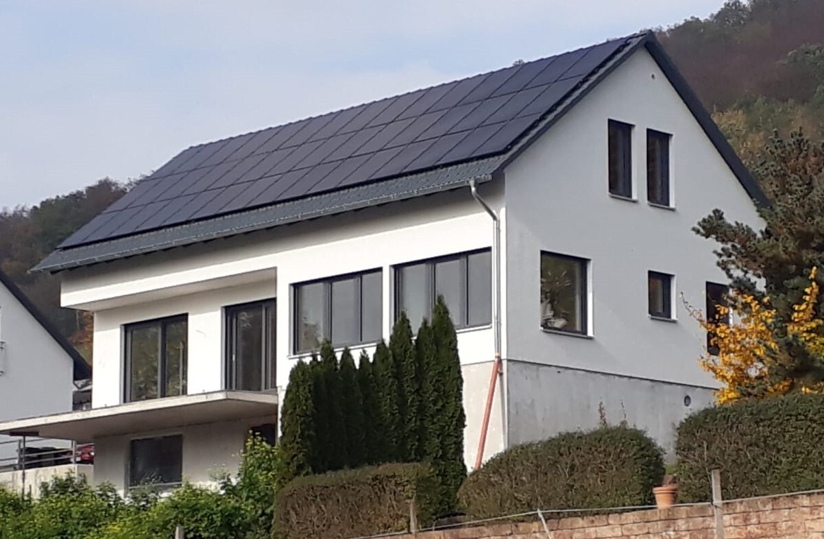

As for the corner windows, I would be cautious as well. In the kitchen, yes, and the floor-to-ceiling corner windows in the dining area are fine, but for such a relatively small house, I find the corner windows on the upper floor inappropriate. We installed several windows right up against the side wall. It’s technically simpler and looks more coherent from the outside (at least in my opinion 😉). Perhaps this could be a compromise? Here are interior and exterior views:
Only regarding the bedroom/walk-in closet, I have some comments. The bedroom is really tight (with a 2m (6 ft 7 in) wide bed, you have just 65cm (25.5 inches) of space left on each side, which isn’t much), and the walk-in closet takes up comparatively too much space. Suggestion: remove the wall between the bedroom and the walk-in closet and rotate the bed 90° clockwise against the bottom wall in the plan. Then you can have continuous wardrobes along both the left and right walls. This provides the same wardrobe space but creates a much more spacious room.
