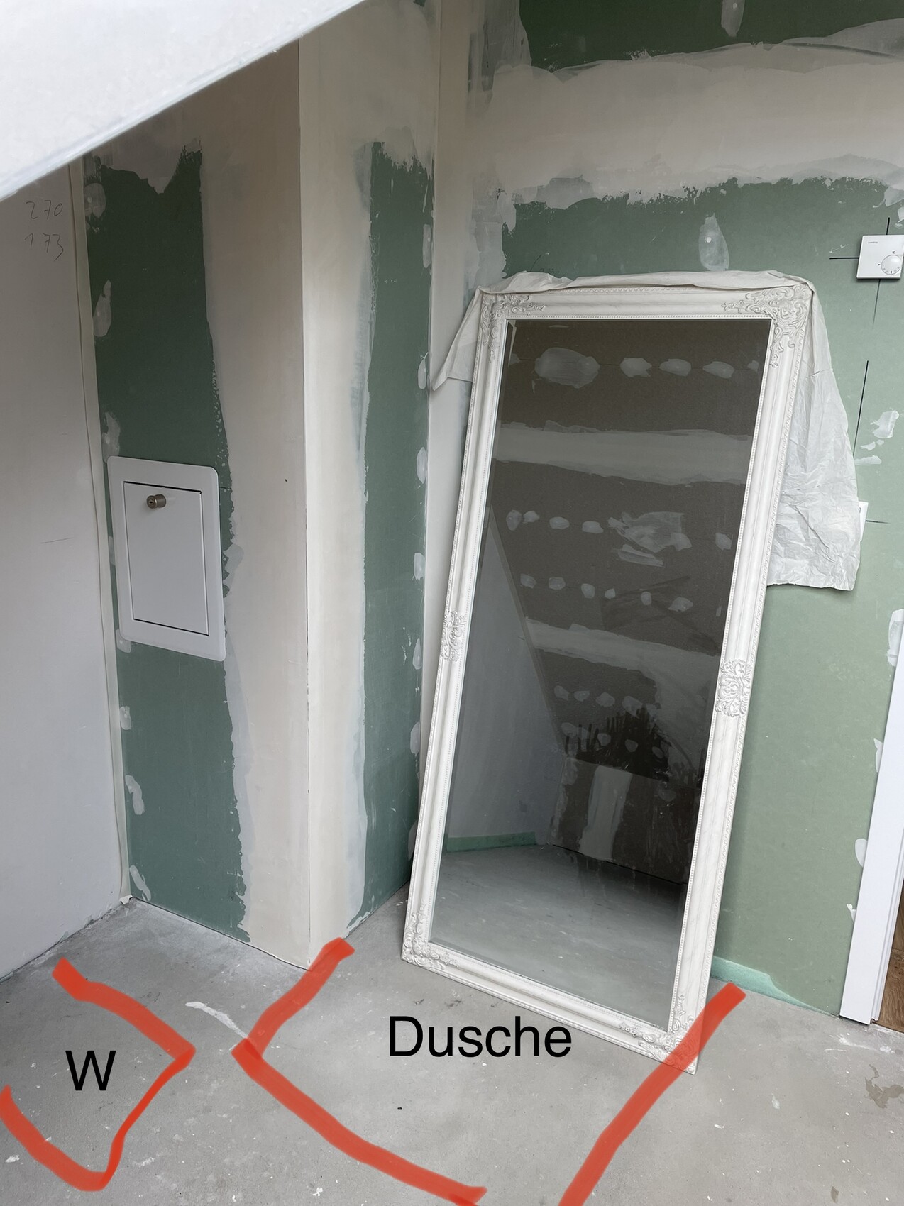

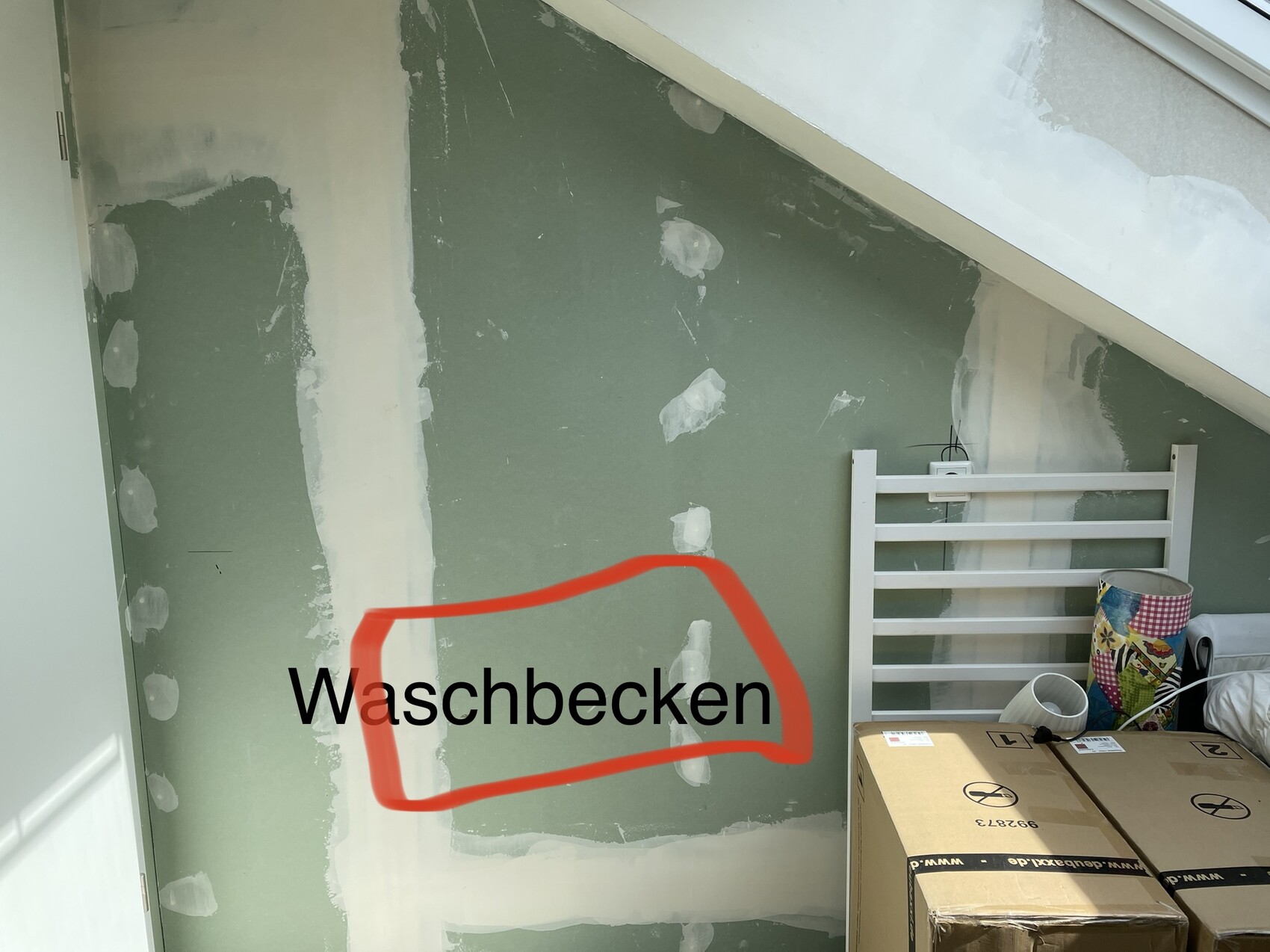

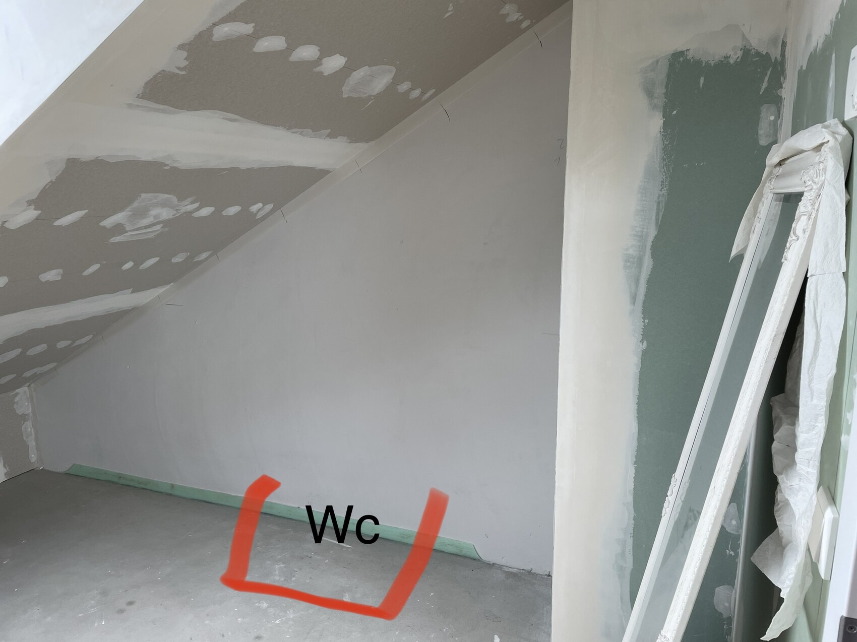

Hello everyone, here are a few photos of the room. I roughly marked the current layout. I hope the images help you understand the situation. Ideally, the shower would be where the toilet is currently planned, but then the pipe shaft would be inside the shower area. The boxed-in section would need to be opened and reclad because the water pipe was routed there.
