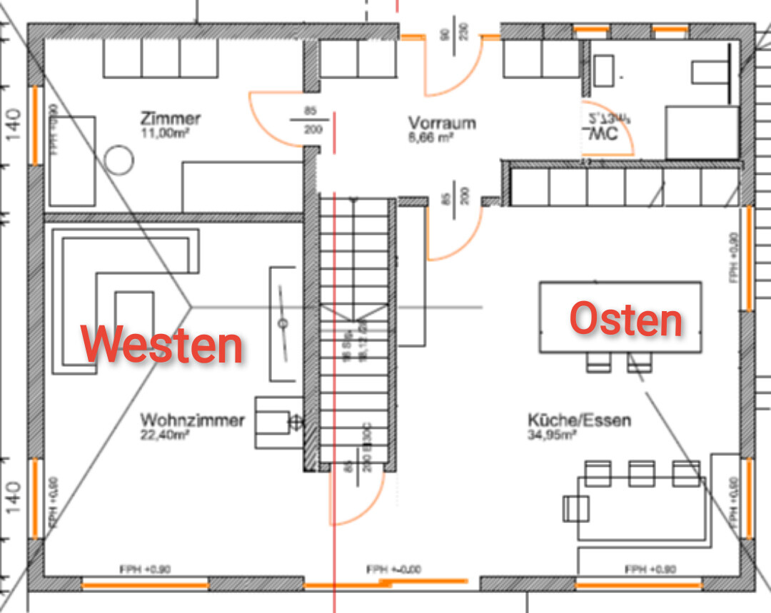

wolverine19879 May 2021 19:38Hello!
I have another question for you.
How would you orient the interior of the house, since we are considering flipping the entire layout (west-east)?
We are wondering what would be better, having the living room in the east or in the west. The same applies, of course, to the kitchen and dining area.
Attached are both layout options along with the site plan of the house.
On the site plan, the house is still shown 3 meters (10 feet) too far east, but we have already adjusted it to 5 meters (16 feet). This leaves about 8 meters (26 feet) of space on the west side.
Maybe you have some ideas, opinions, or experiences on this topic. Thanks for your help so far!

Breakfast time is the morning sun for day shift workers, and for living rooms, the evening sun is usually more relevant. I’m surprised that the kitchen planning still hasn’t progressed – or does that only happen in a specialized forum where I don’t visit often enough?
