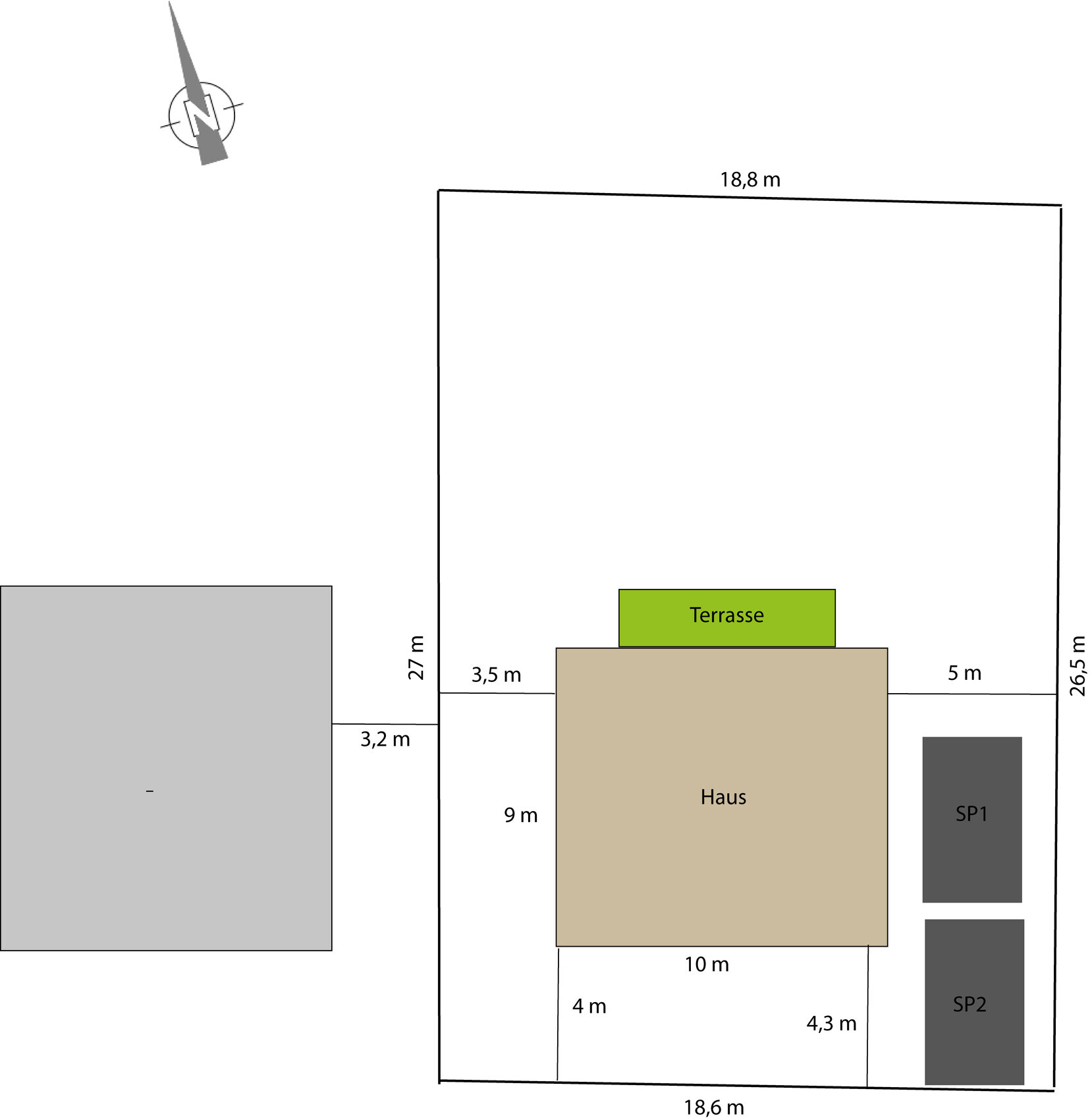

we have been juggling ideas back and forth for several days now and would appreciate some fresh external input.
The plot is already owned, and the house has been purchased from a major general contractor (134 sqm (1,444 sq ft)).
We are maximizing the zoning plan, meaning we cannot build larger or taller.
Besides optimizing the floor plan, we are still considering the positioning of the house.
It is an excellent plot with a 3 m (10 ft) wide access path, so we only have to keep 3 m (10 ft) distance on all sides.
Two parking spaces side by side would be ideal, but I would prefer not to risk ending up just 3 cm (1 inch) too close to the neighbor.
Alternatively, we could arrange them in tandem or enlarge the "front garden" and convert it into parking space.
The house could be rotated if that helps.

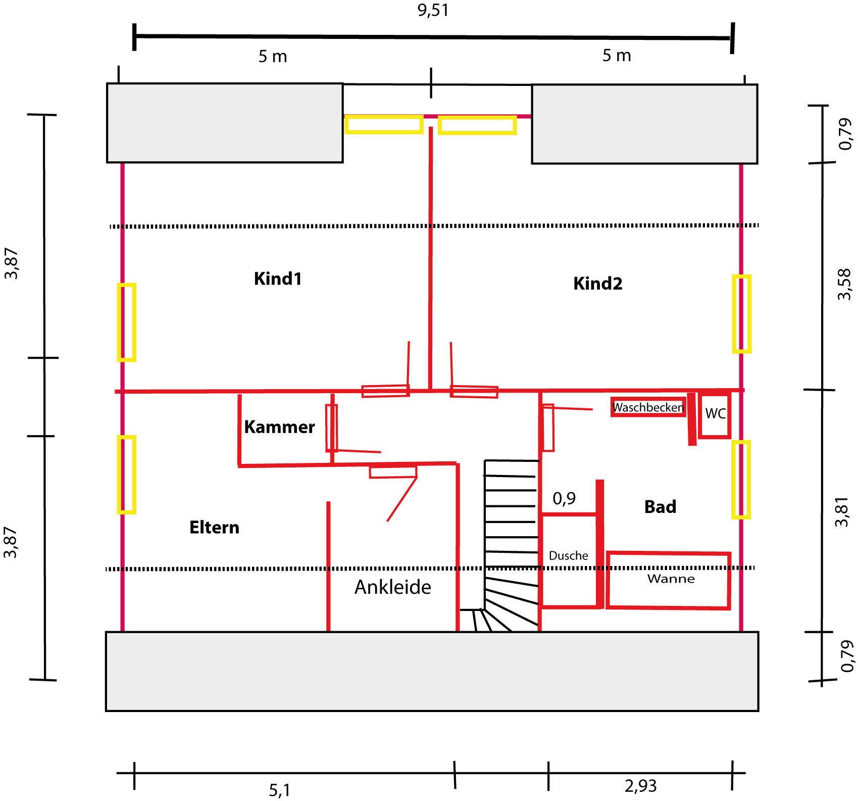

"Open" walk-in shower upstairs without door between 3 walls, toilet somewhat hidden, large washbasin/mirror (3 women at home...)
Planning origin: modified catalog house
What do you particularly like? Why? All desired rooms included, open-plan living area as the heart of the ground floor, equally sized children’s rooms
What do you not like? Why? How to distribute everything sensibly? Small walk-in closet affected by roof slope

Where is north?
Not allowed, no official parking space according to many/all? building codes/planning regulations.
Please provide the dimensions of the bathroom.
Better to skip the pantry than to have a maze-like corridor leading there.
Ruska schrieb:
Alternatively, we can stand facing each other

hanghaus20001 May 2021 12:50Selling spaces side by side is tight but should be possible.
Thank you for the quick responses!
I have redrawn the north arrow. On the right is only garden; on the left, the neighboring house has been added.
We currently also have two parking spaces one behind the other in the same town; that seems to be acceptable.
The pantry is more like a walk-in cupboard. For larger items, the utility room is available.
Right now, it’s quite annoying to store canned goods and supplies in kitchen cabinets.
Would it still be possible to add a (double) carport? I found 6 m (20 ft) width as a guideline, which is not available here.
How large should the turning area in front of the house be if both cars park side by side?

Right now, I'm really frustrated with storing canned goods and supplies in the kitchen cabinets.Plan your kitchen carefully. A pantry cabinet holds twice as much as an apothecary cabinet.
Only use pull-out drawers, 90–100cm (35–39 inches) wide.
They hold a lot and help keep everything visible—avoid corner cabinets.
I would shift the house 2m (6.5 feet) north for the terrace and evening sun,
or, if you prefer sun all day, move it fully north and position parking spaces as a visual screen toward the street.
