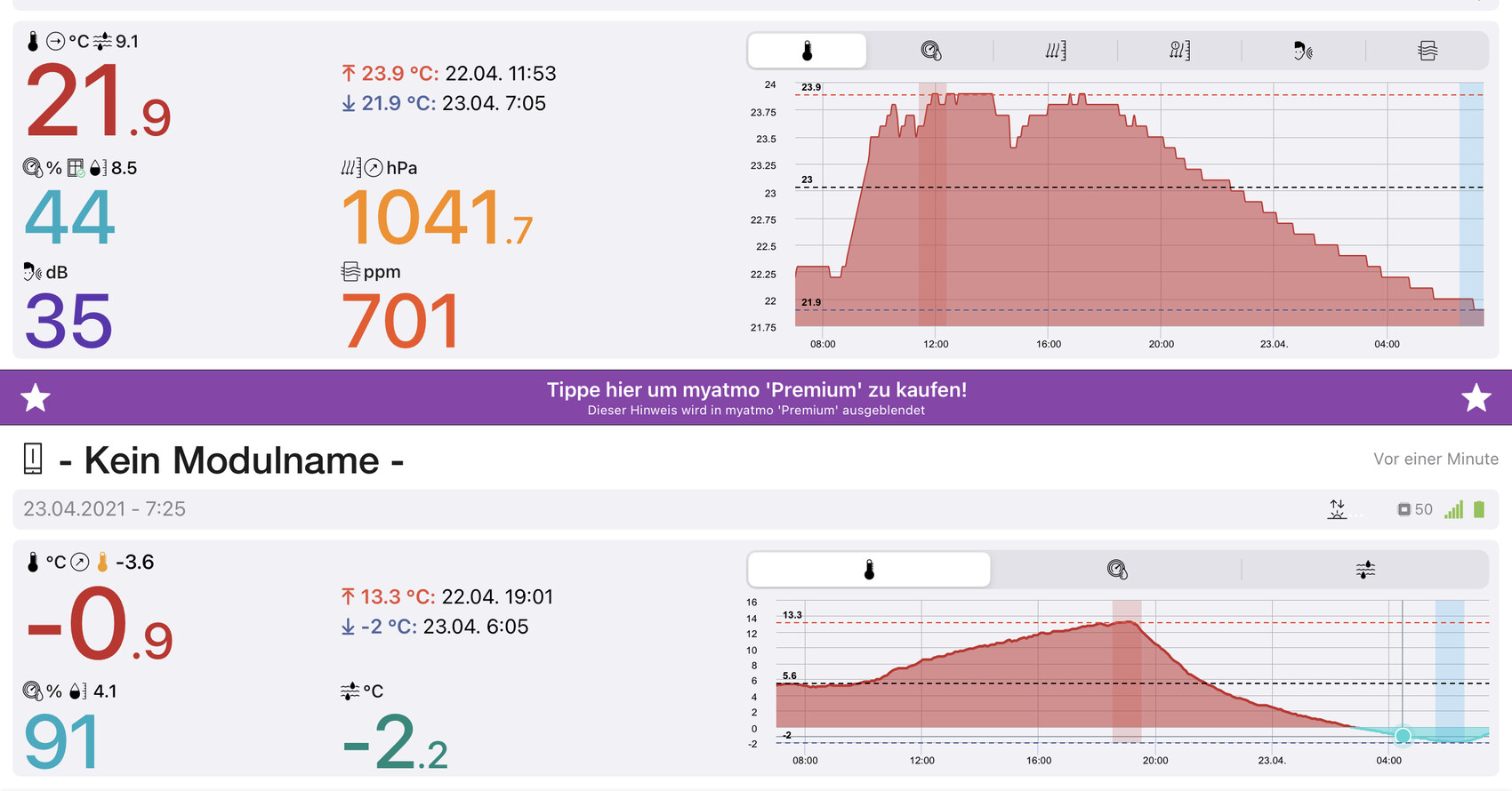

Second night without heating. Everything is fine. Nobody is cold. Here are the temperatures from the ground floor over 24 hours and outside. Inside the ground floor, it is 0.3°C (0.5°F) colder than yesterday at the same time because we dropped below zero outside last night.
Upstairs, the temperature is currently 21.3°C (70.3°F).
Indoor climate dashboard showing temperature, CO2, and humidity graphs
