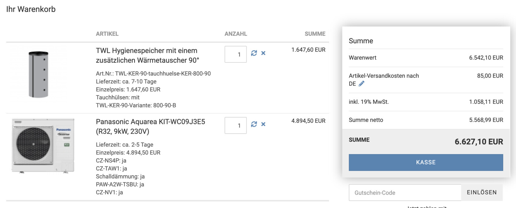

nordanney9 Feb 2021 19:31Joedreck schrieb:
For example, the Panasonic that a user here has.Yep. Unbeatable price/performance ratio. Experience report in 4-6 weeks.N
nordanney9 Feb 2021 19:37meowmeow schrieb:
The heat pump would probably be a lot cheaper.Go for the monoblock. You can simply connect it yourself to the existing heating pipes.Hmm, I would have to run the water pipes through the exterior wall to the outside. If the heating then fails during winter, I think that could quickly become quite problematic.
What is the main advantage of the monoblock?
With the split systems, you no longer need an annual leak test.
