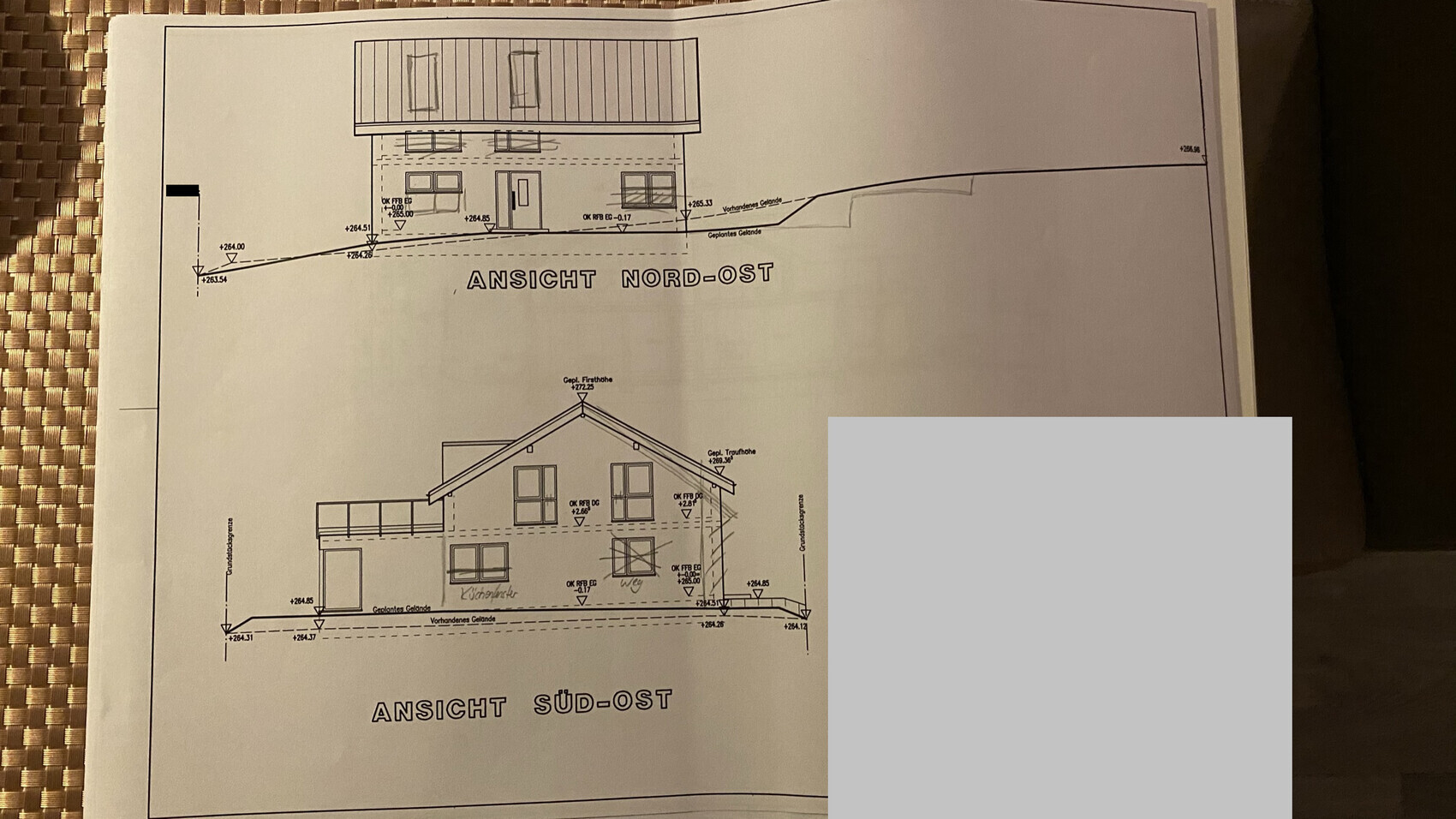

Hausi190913 Jan 2021 12:45Hello everyone,
this has taken a bit longer than we initially hoped.
We have now decided on an architect to handle the planning up to the building permit / planning permission application.
We will need to apply for an exception / exemption because our eaves height will likely be about 50 - 80cm (20 - 31 inches) higher than what is specified in the development plan.

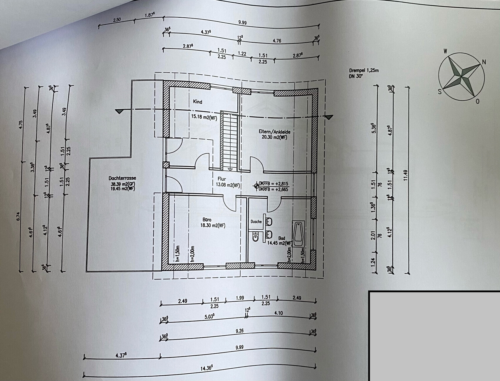

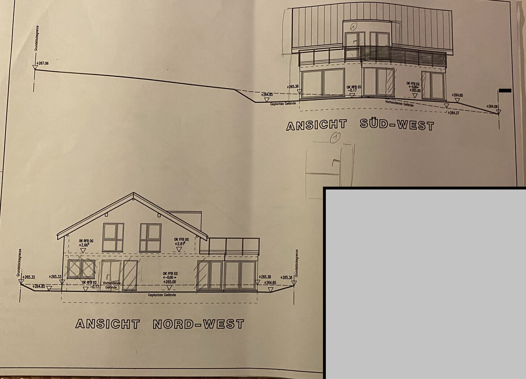

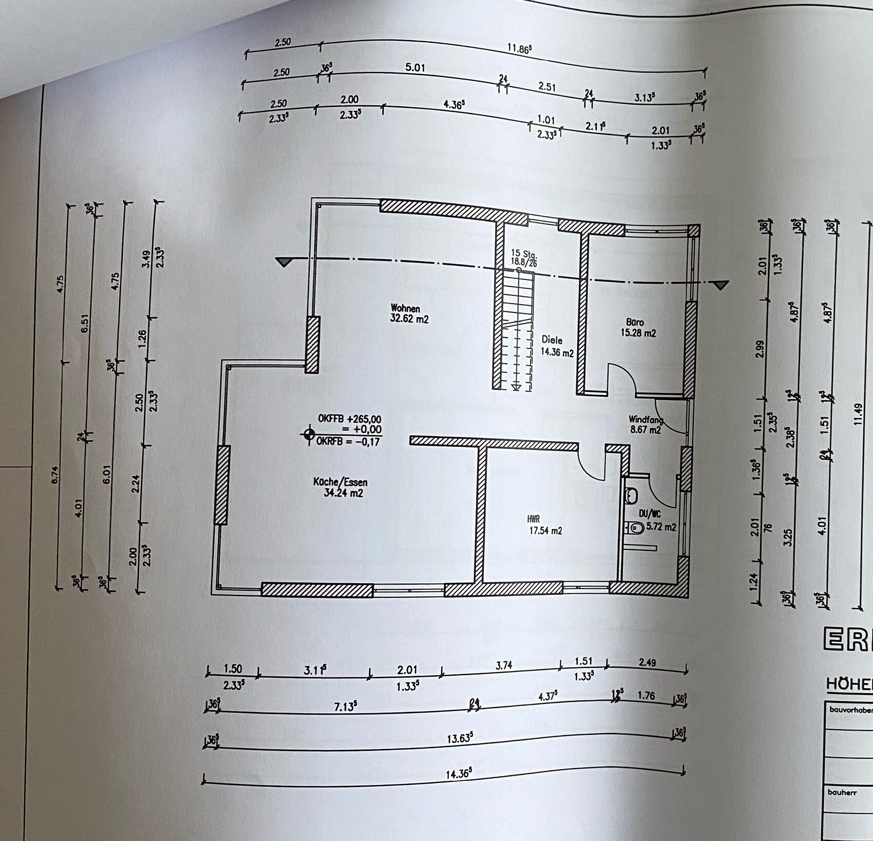

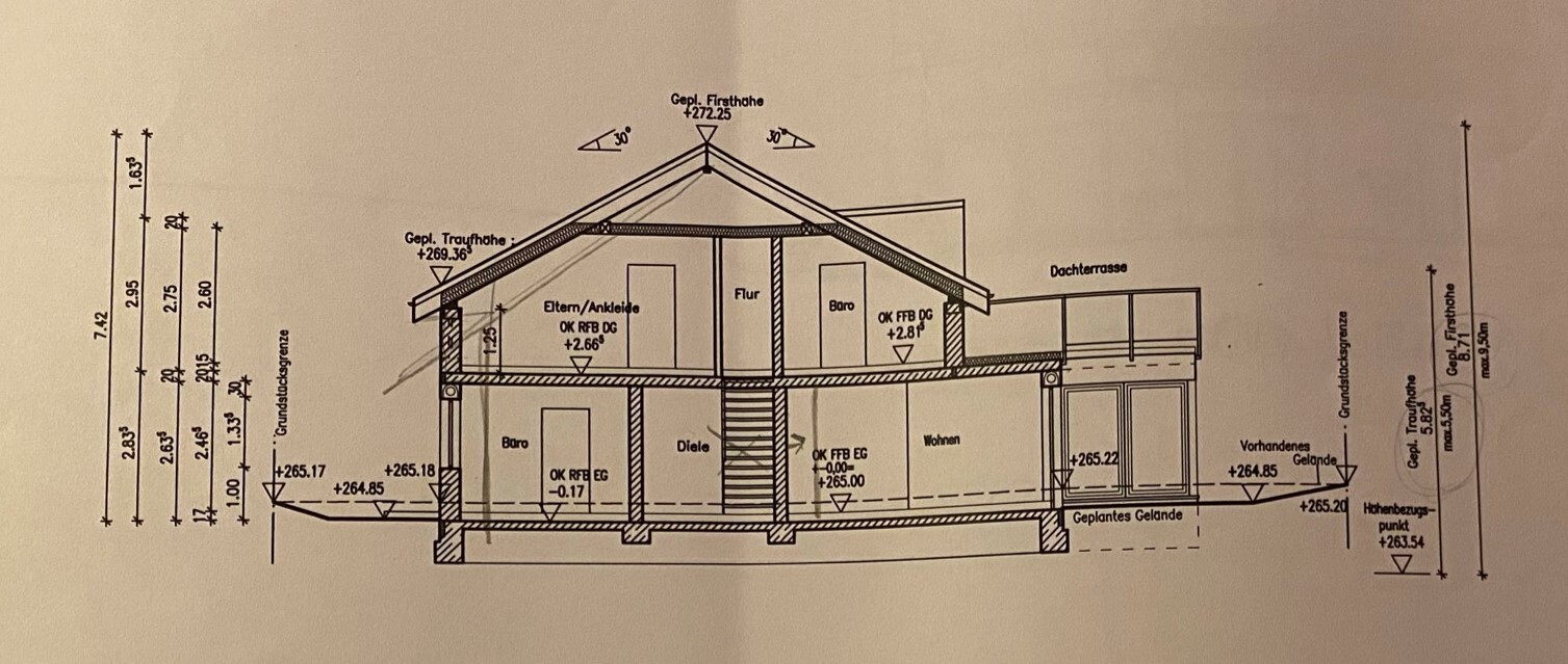

We have received the first drafts from the architect, which I would like to share with you.
Overall, the house is still a bit too large since we have only budgeted about €400,000 for the turnkey house.
We would really like to have a roof terrace, which the architect has included in the plans.
Do you think €400k for the turnkey house (excluding additional costs — we have roughly €100,000 set aside for those / upgrades)
is realistic if the living area is reduced by about 20 sqm (215 sq ft)?
Is a roof terrace as expensive per square meter as the enclosed living space, or even more costly?
Our concern was that due to the development plan (max eaves height 5m / max ridge height 9.5m) and the sloping site with about 3.5m (11.5 ft) elevation difference
along the length of the plot from the street (which is the reference point for the eaves height), we would have to dig very deeply into the garden at the back.
However, this does not seem to be quite as dramatic when looking at the site sections — what do you think?
We also want to try shifting the house slightly towards the northeast because there is a path running directly along the southwest side of our property,
and between our terrace and the path, there is only about 3m (10 ft) distance. We are concerned that this distance is too small and it might feel like we are always being watched or overheard.
Does anyone have experience with this?
Regarding the floor plan: We are basically satisfied with the layout. However, we would like to save some hallway space
and use the gained area in the rooms or save it overall, so the house can be a bit smaller.
One idea was possibly to use a different staircase design or remove the lobby and place the stairs directly adjacent to the entrance area.
So far, we haven't found a good solution for this.
We have completely moved away from the split-level option. We saw it in two other houses and it did not appeal to either of us.
I/we are very much looking forward to your comments, suggestions, and tips 🙂

Hausi1909 schrieb:
Overall, the house is still a bit too large, as we have only budgeted around €400,000 for the turnkey home.
We would really like a roof terrace, which the architect has planned accordingly. I would remove the word "a bit." Choosing an architect rather than just a draftsman is important, not least because a) they can talk you out of having a huge smoking balcony for your child, and b) they can manage the eaves heights from both sides so you don’t have to simply raise them by "50 to 80 cm (20 to 31 inches)"—or rather, want to. I’m counting on the reasonableness of the authorities here.
The house is seriously too large. If you're not double-income earners in band A14, this is beyond your means—and at the very least, it offers endless space where it’s not needed. You really should develop your sense of scale. And yes, the suspicion is correct: per square meter, a roof terrace easily costs at least as much as fully enclosed living space.
