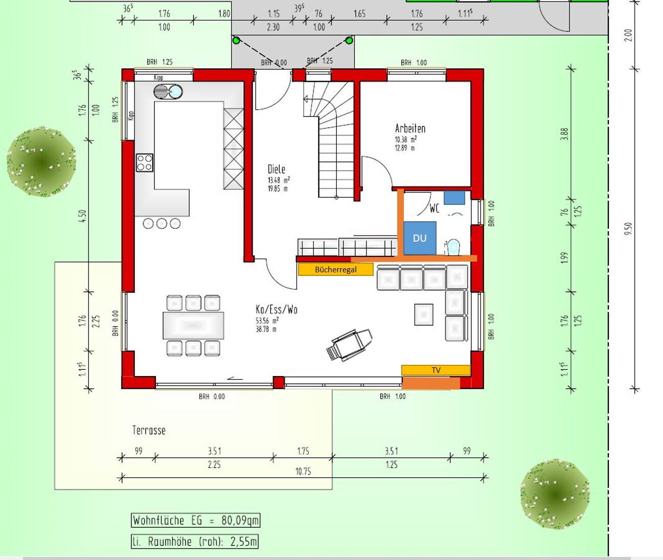

RomeoZwo17 Nov 2020 08:09
Hmm – okay, you’ve thought it through and have your opinion, but what are the costs for a second shower in the ground floor bathroom? The house’s external dimensions remain the same – it doesn’t need to be bigger. Then you have the pipes and shower fittings, plus a shower tray. If nothing special is required, it will probably stay around €1000 (about $1100).
Grundriss EG: Küche, Essen/Wohnen, Diele, Arbeiten, WC, Dusche, Bücherregal, Terrasse.
The window on the upper floor will need to be adjusted accordingly. You won’t have symmetry anymore, but I don’t find that very important with the different window sizes anyway.
Alessandro
17 Nov 2020 09:12
You always emphasize individuality and that you’re comfortable with the floor plan.
In my opinion, you’re just making everyday life unnecessarily difficult. This has nothing to do with individuality, unless you’re masochists 😉
Your entire hallway will get dirty and muddy. You’ll end up spreading that dirt throughout the whole house. If you enjoy cleaning, then of course this is a dream house!
If I were to build again, I would definitely include a large entrance area with a cloakroom.
You haven’t yet experienced situations that others here have dealt with long ago. This input is invaluable!
Your thoughts about parking the stroller in the garage, basement, or on the terrace say a lot...
If you store it in the hallway, you’ll have dirty walls because the wheels will scrape along them every time you move it from place to place. You can probably imagine what happens if you have twins 😉
Your kitchen “island” will be full of all sorts of stuff you need on a daily basis and just leave there. I suspect it will be the messiest spot in the entire house. Forget about sitting there romantically.
At least have the connections ready for a potential shower in the future. That will cost you less than 100 euros!
