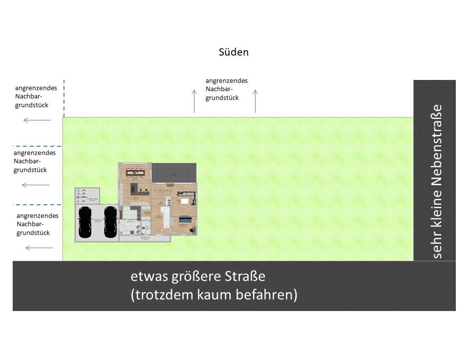

After spending hours as silent readers in this forum, my partner and I are now ready to share our floor plan for your feedback.
First, here is the questionnaire:
Development Plan/Restrictions
Plot size: 1322 sqm (approx. 14,230 sq ft); about 23 x 56 m (75 x 184 ft)
Slope: No
Site coverage ratio: no development plan – § 34 Federal Building Code
Floor area ratio: no development plan – § 34 Federal Building Code
Building envelope, building line, and boundary: no development plan – § 34 Federal Building Code
Edge development: No, only carport/garage and garden shed or storage shed allowed
Number of parking spaces: no development plan – § 34 Federal Building Code
Number of stories: no development plan – § 34 Federal Building Code
Roof style: no development plan – § 34 Federal Building Code
Design style: no development plan – § 34 Federal Building Code
Orientation: corner plot approx. 23 x 56 m, streets to the north and west
Maximum height/restrictions: no development plan – § 34 Federal Building Code
Other requirements: none

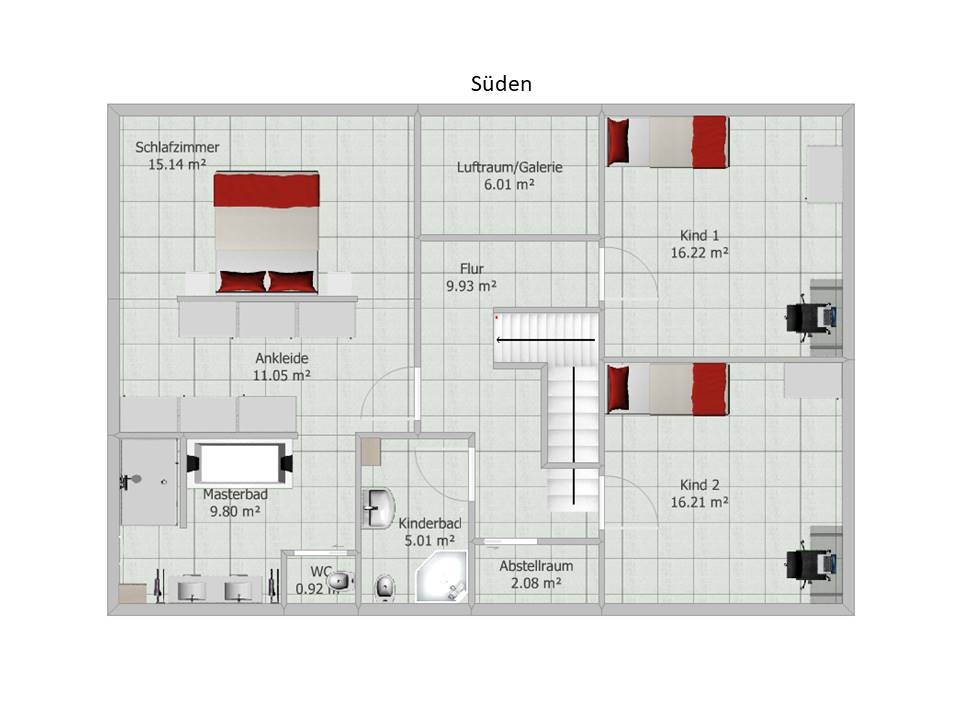

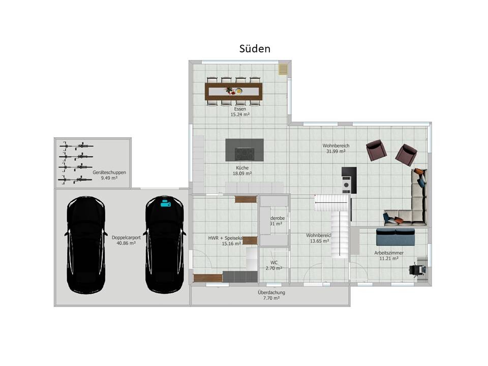

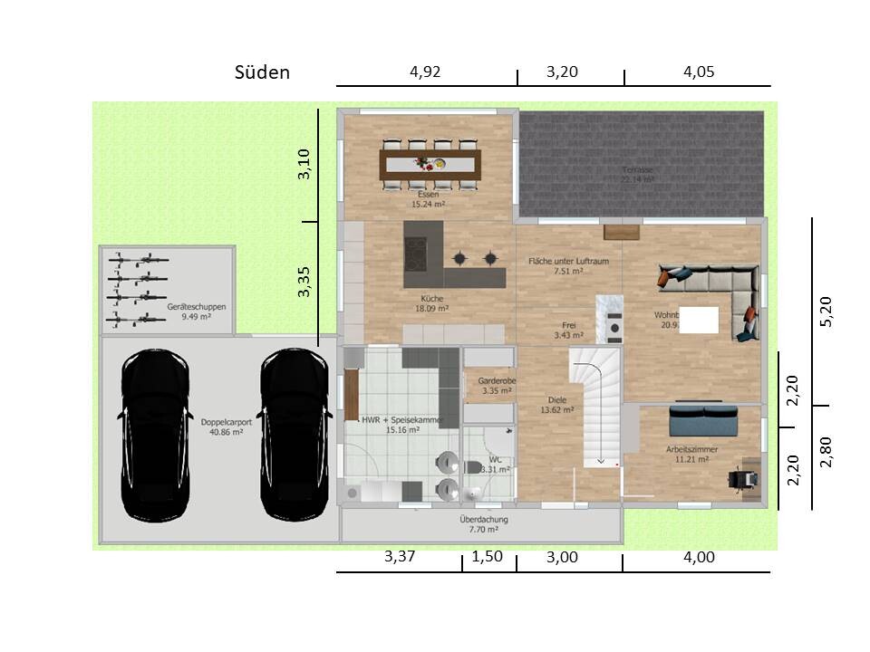

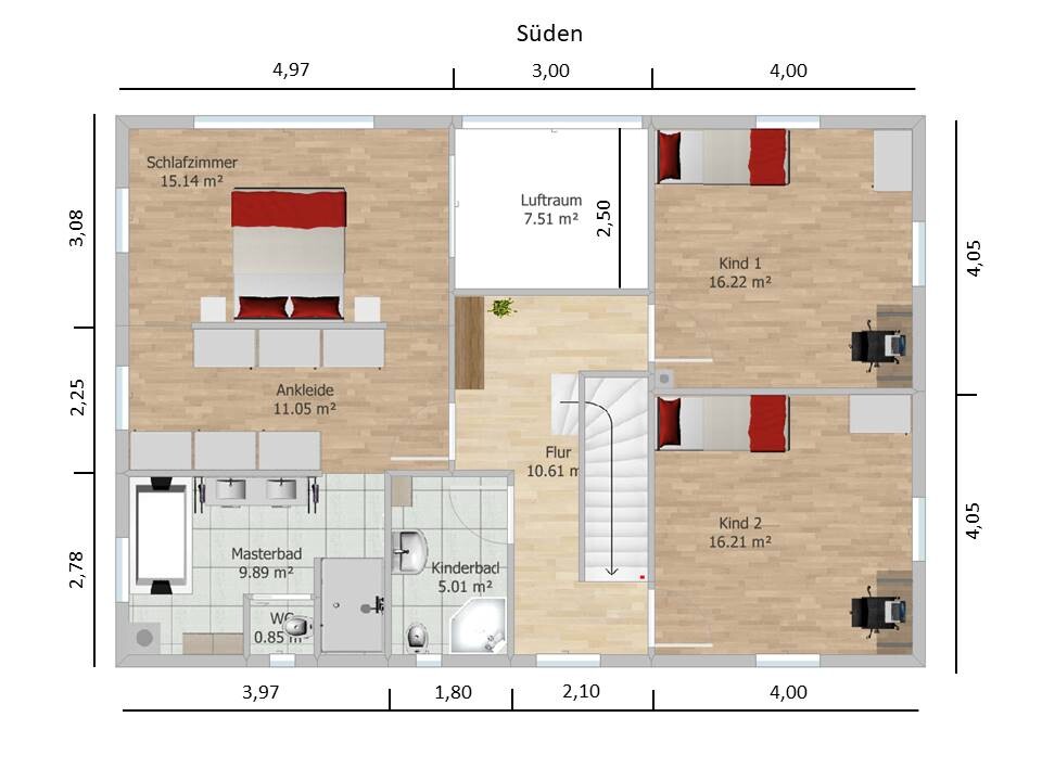

Nice-Nofret28 Oct 2020 19:55I think the floor plan is moving in a sensible direction.
Three minor details come to mind right away.
Ground floor bathroom: The entrance to the shower is about 60cm (24 inches) wide, which is a bit narrow. It should be at least 80cm (31 inches).
First floor bathroom: The space for the separate toilet is somewhat narrow. I would increase it to around 1m (39 inches) for more comfort.
First floor bedroom: (personal opinion) For better comfort, I would position the head of the bed against the top or right wall.
Hausbau202229 Oct 2020 09:07What I would also like to point out are some "details" in the bedroom. For the view from the bed, I would choose a large window, similar to the ground floor below. This way, you have a great view of the garden from the bed.
I like it.
In the bedroom, I would arrange the furniture differently. It doesn’t feel great when the entrance door is right next to the head of the bed.
However, the master bathroom won’t work like this.
With a structural dimension of 2.45 meters (8 feet), the clear room height is about 2.40 meters (7 feet 10 inches). That leaves barely a meter (about 3 feet) between the bathtub and the washbasin, probably even less.
I also find the separate toilet too cramped and would leave it out.
I would reconsider the bathroom layout. If having a separate toilet is very important, you might consider a more open concept by not strictly separating the dressing room and bathroom. There are some great possibilities there.
For the dressing room, you could install a wall-to-wall wardrobe along the wall next to the stairs, and on the right side just a chest of drawers where the wall doesn’t go all the way to the ceiling. Then place the washbasin there with a standing mirror that can also be turned toward the dressing room side.
This would definitely improve both rooms, making them less narrow and corridor-like.
This is a bit of a drawback of the floor plan, but it can be nicely adjusted. The master area, with about 37m² (400 square feet), is large enough to accommodate everything comfortably.
Personally, I would probably reduce the size of the bedroom a bit and enlarge the dressing room and bathroom area instead.
I would align the door to Child 1’s room with the bathroom wall. That way, from the square hallway in front of the children’s rooms, you could create a separate room with a door to the corridor. This would create two doors from the living area to the children’s rooms, and the noise transmission over the gallery would be reduced.
Regarding the children’s bathroom, I’m a bit torn about whether it might be better to increase the width from 1.75 meters (5 feet 9 inches) and reduce the length accordingly.
But these are all details for the planning stage. For a meeting with the developer, I think this is a good starting point.

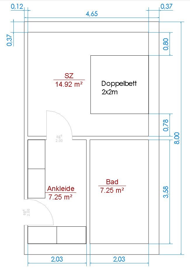

Something doesn’t seem right. What exactly do your measurements refer to? I was just about to start planning the parents’ area.
For the basic dimensions, I used 8 x 4.65 m (26 ft 3 in x 15 ft 3 in). Exterior walls are 36.5 cm (14.4 in), and the wall next to the stairs is 11.5 cm (4.5 in) masonry. I could imagine that, for structural reasons, this needs to be built with 17.5 cm (6.9 in) bricks.
If I draw it like this, everything becomes much, much tighter.
So either you used incorrect dimensions for all the furniture and sanitary fixtures, or your measurements are off. That doesn’t make things any easier...
