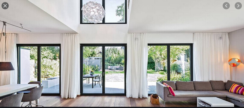

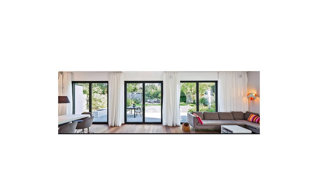

Alessandro schrieb:
The difference is clearly visible in this direct comparison! Even you can’t deny it, @Nice-Nofret
Like with everything, it’s a matter of personal taste. For me, 3x2 meters (10x7 feet) would feel too tunnel-like, but of course I understand that others like it. And that’s exactly how it should be.
However, this visual comparison does not show that without the open space on the upper floor, you would have a nice, open area, which is lost in the solution shown here.
So in the end, it’s a subjective choice based on what you prefer or find more important, not a matter of right or wrong.

Alessandro schrieb:
1.png"]52814[/ATTACH]<br />
<br />
<br />
<a href=
You can clearly see the difference in this direct comparison!
You can’t deny that either, @Nice-Nofret
You also cut out the entire ceiling... I actually prefer it without the air space.
[ATTACH type="full" alt="Living room with large glass sliding doors, gray sofa, colorful cushions, garden view." width="500px">

pagoni2020 schrieb:
This visual comparison overlooks the fact that without the open space on the upper floor, you would get a nice, open area, which is lost with the solution shown here.
That's true, but that wasn't the point. As @Sparfuchs_:P demonstrates, it’s a matter of taste with pros and cons on both sides. To generally denounce and speak badly about having an open space like that, as some do here, isn’t helpful. It’s like claiming all red cars are bad.

I feel the same as Sparfuchs.
Thank you, Alessandro, for sharing the comparison.
How does it look from the hallway upstairs?
