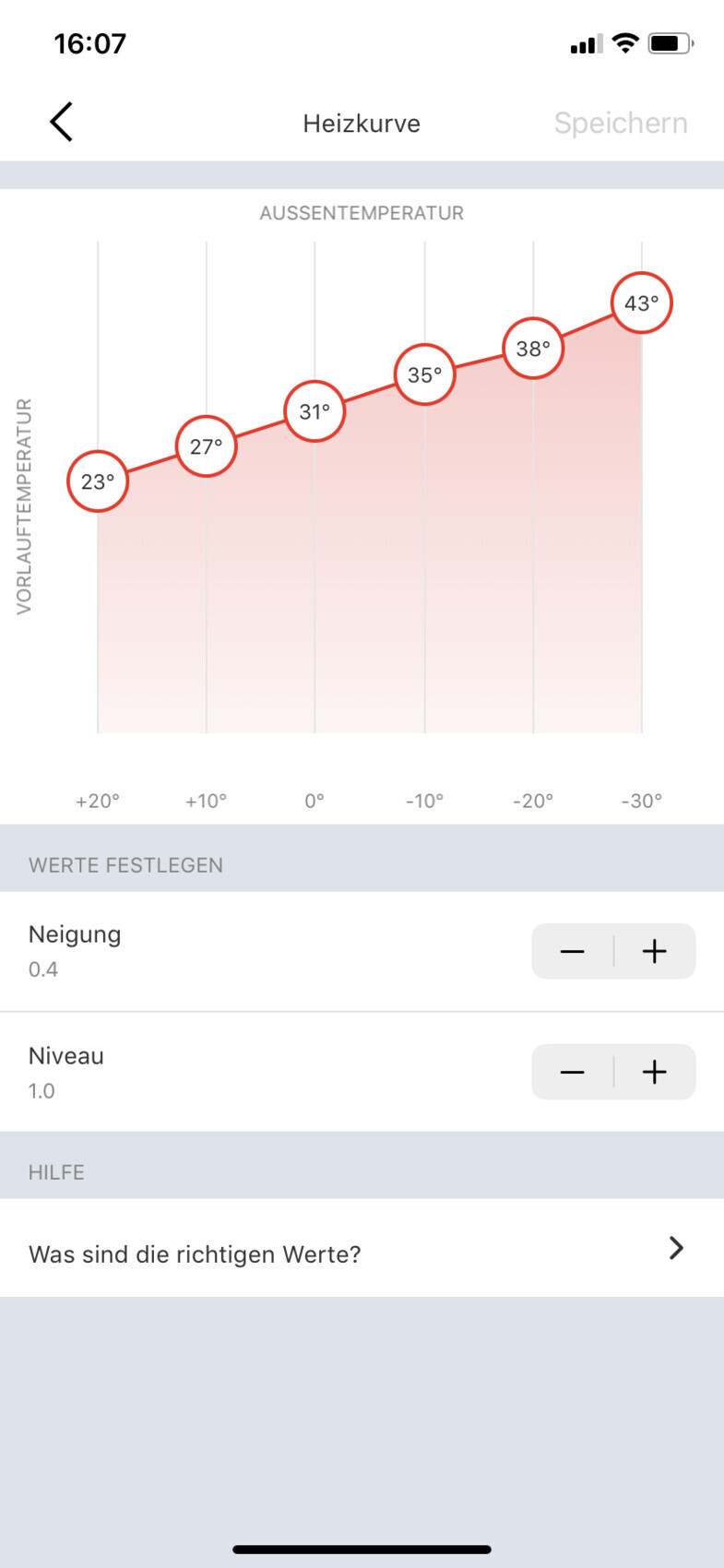

I’ve attached the heating curve I set for you...
