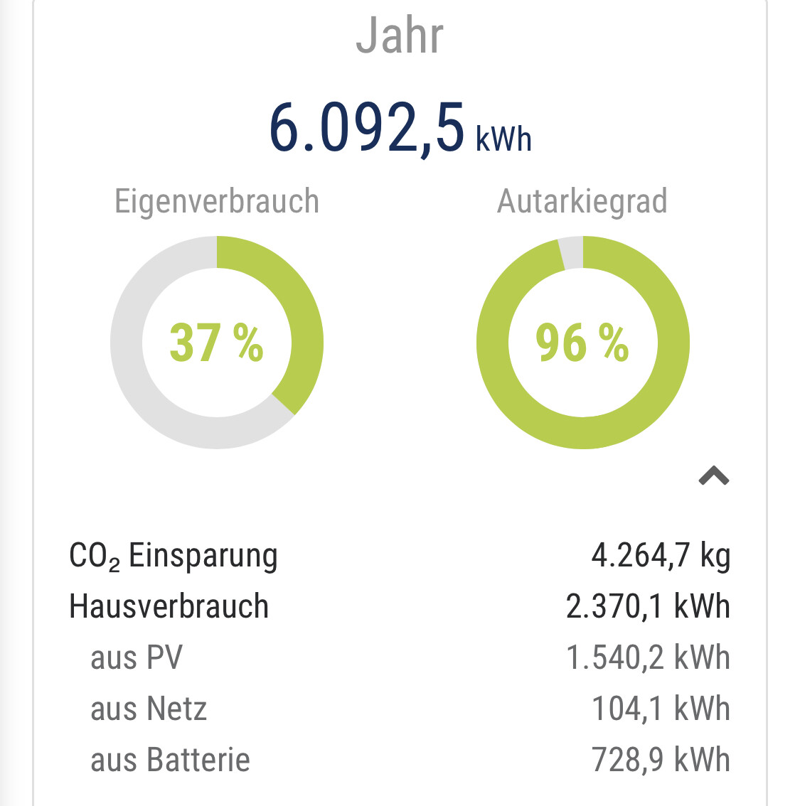

It is not representative due to being 2/3 daylight saving time since April, but this is our household consumption exactly day by day for the last 5 months. The nearly 6.1 MWh (20.8 million Btu) is the photovoltaic production since the beginning of May.
