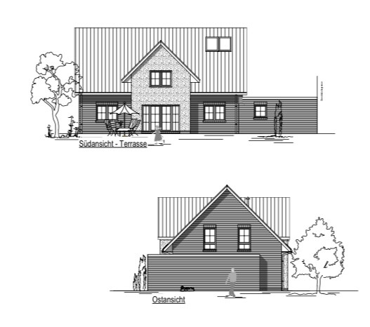

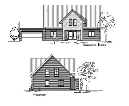

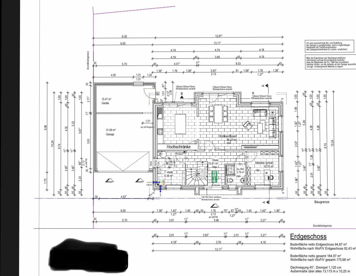

After a long wait, the first floor plan is ready. I would appreciate it if you could take a critical look and give me your feedback.

Guest toilet door is somewhat awkward, too narrow? Hallway wastes too much space?? Where should a proper coatroom go? Entrance area is not appealing? The front door feels too small for the house, the guest toilet window does not fit visually. No idea how to improve this.

House drawing: South view with terrace, furniture and person; East view with tree.

Ground floor plan of a house with kitchen, living room, garage, hallway, utility room, and bathroom.
Triple house view: east view, north view (entrance), and west view with garage, tree, and person.

One more question: Would you keep the door to the utility room as it is, or would you place the door to the utility room from the kitchen? The advantage of the current layout is that when entering the house through the garage, you can immediately leave shoes and jackets at the planned wardrobe opposite the stairs. On the other hand, having a direct door to the utility room from the kitchen would naturally shorten walking distances for accessing supplies and so on.

If you want a purely work island, I would plan it as shown in the attachment. The door to the dining room is only 1 meter (3 feet) away, and when you come in from the garage, you will probably need to go to the cloakroom before the kitchen more often.
hampshire schrieb:
Trash solution in the island
I would definitely recommend that as well. Regarding the placement of the sink and stove: this is just an example here; others will certainly know better what works best.
Oh, and also hinted here: install a large floor-to-ceiling window front in the kitchen, not just a small window. If you can accept that the house won’t be completely symmetrical because of that.

I still don’t understand where there is supposed to be wardrobe space for five people.

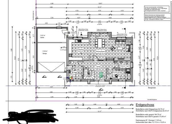

attached is our new floor plan. There are some minor changes. Overall, we are quite satisfied. We will probably keep the kitchen as planned, but design it as an “aircraft carrier” style. Below the kitchen, a side-by-side refrigerator will be placed against the wall. We like the new bathroom on the upper floor as it will have no sloping ceilings. We are still deciding where to place our bedroom—either as planned or in the gable of Child 2’s room. This way, all the children would have the largest rooms. What do you think? Another highlight is the view of the entrance area. The ugly bathroom window is finally gone. The west elevation is not very appealing, but it is difficult to arrange the windows there. What is your opinion?
Architektonische Zeichnung eines Hauses: Südansicht mit Terrasse und Ostansicht.
Zweistöckiges Einfamilienhaus: Nordansicht mit Eingang und Garage, Westansicht mit Baum
Grundriss Erdgeschoss: Küche, Wohnzimmer, Treppe und Garage.

The design flaws remain, and the floor plans are obscured by poor "readability" :-(
