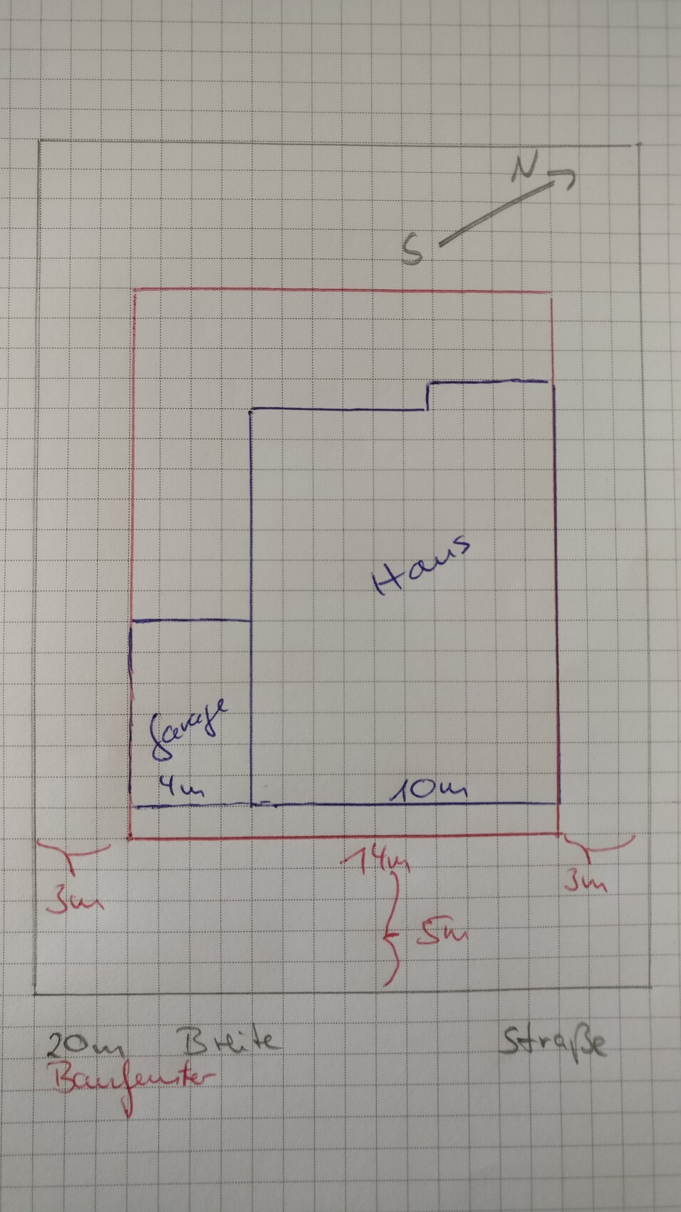

Hausbewohner19 Jul 2020 16:41Hello,
thank you very much for your comments.
First of all, please find attached a simplified plan of the plot and the building area. As mentioned above, the issue is that we need to fit both the garage and the house within the building area, and no boundary construction is allowed.
The plot has a street frontage of approximately 20m (66 feet) and becomes slightly wider to the back. In my drawing, I calculated with a 14m (46 feet) building area, but according to the survey, there may actually be about 0.75 to 1m (2.5 to 3 feet) more. In my opinion, this does not make a difference, and the extra space should be allocated to the garage.
Since we want to include a large garage, we have limited the house width to 10m (33 feet) to avoid making the layout too elongated.
We are aware that certain compromises in the floor plan will be necessary due to the plot’s conditions.
The positioning of the house and garage on the plot is not final and may be adjusted by a meter or two. However, we like the general orientation because it provides privacy on the terrace from the neighbor on the south side.
Moving the kitchen closer to the entrance would either mean placing it next to the garage (with no windows) or orienting it entirely northward (which we don’t favor either).

@11ant
There are certainly larger floor plans available from the builder, but these are wider and would require extensive redesign.
Therefore, we decided to extend an existing 165sqm (1775 sq ft) floor plan and to incorporate features like a storage room, etc.
