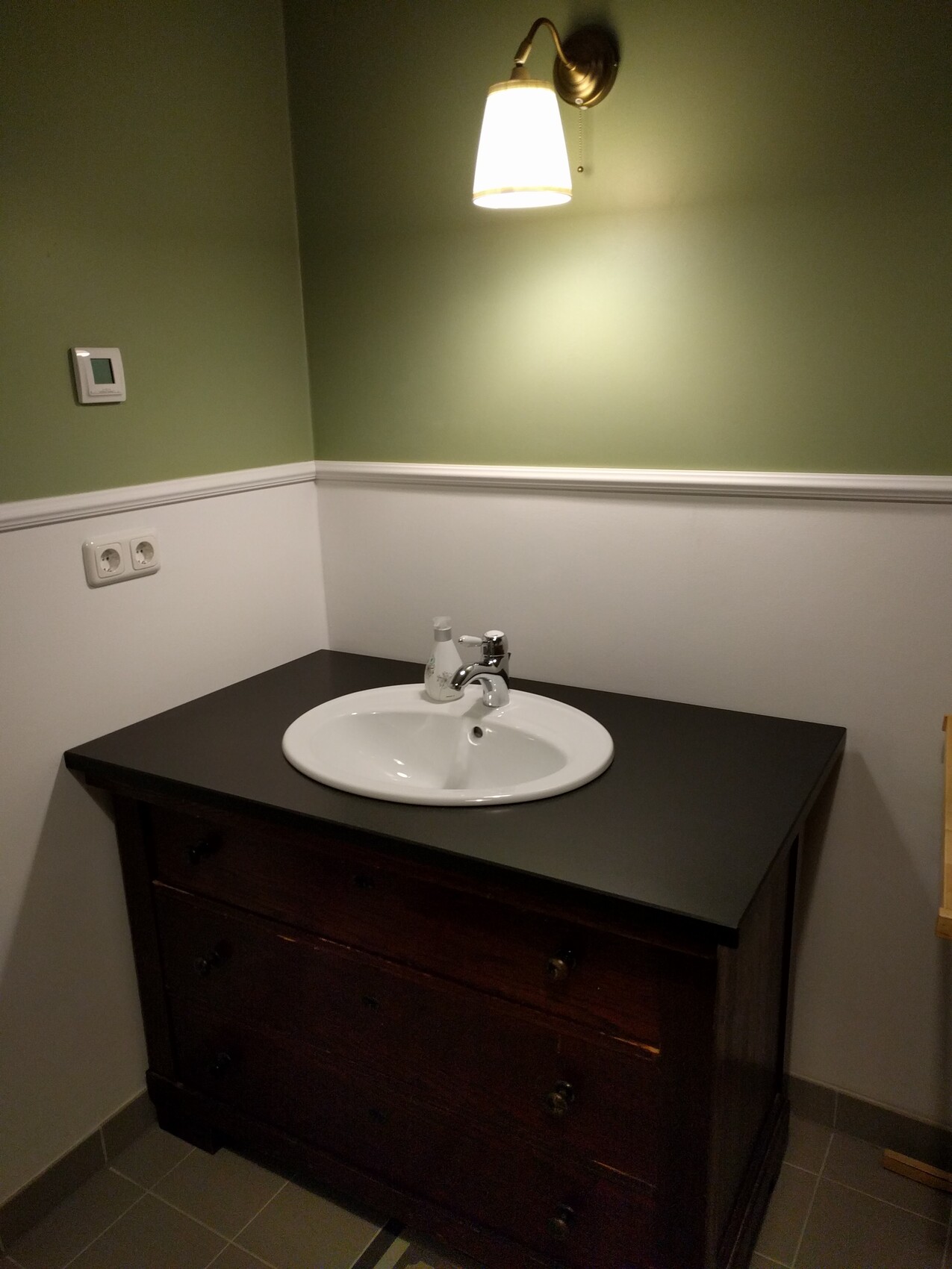

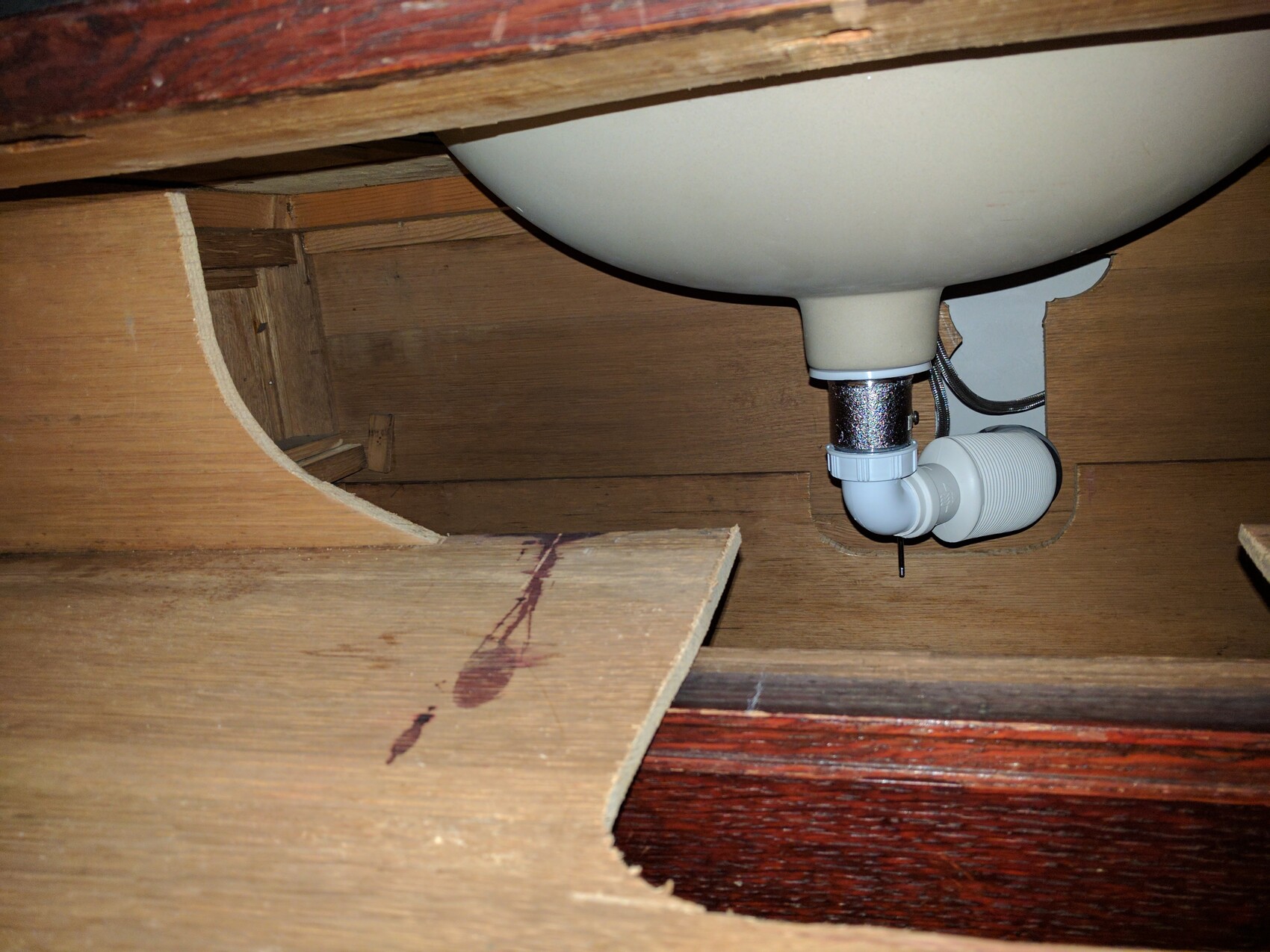

Just to share our solution without much context: old dresser (eBay classifieds 20€) + sink 60€, granite countertop from the stonemason about 200€ including cutout, custom-made to the sink dimensions (we used the sink as a cutting template). Everything else follows standard dimensions for the plumbing. From the hole in the wall/floor, it’s like Lego—just connect the right parts until the water flows where it should. In our case, a flat trap was the best solution.
