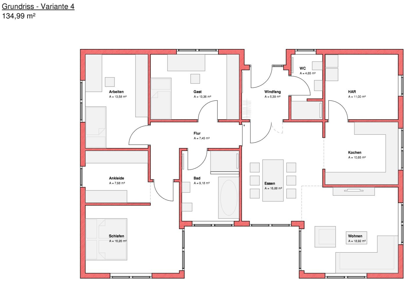

Stulli19129 May 2020 10:25Good morning everyone,
Yesterday, we received the first proposals from our architect.
He created the different floor plans based on our initial discussion.
Overall, we find the partition walls in the living/dining area very interesting, but we are leaning towards option 4.
Would you be so kind as to share your thoughts, suggestions, and opinions?
Thank you very much
Thank you very much
He created the different floor plans based on our initial conversation.
Overall, we find the partition walls in the living/dining area very interesting, but we tend to prefer option 4.
Would you be so kind as to share your thoughts, suggestions, and opinions on this?
Thank you very much I always feel somewhat uneasy with layouts where a room is used as a passageway. The children will grow older and start going out in the evenings; you will have guests, and I would find it disruptive if the dining room is the only way to get from the front door to the other rooms. Both as someone “passing through” and as someone sitting at the dining table in the way. Open-plan living spaces are nice and spacious – but in the proposed arrangement, I would also consider the drawbacks. Personally, I would prefer a continuous hallway.
Another point of concern for me is the guest toilet with a shower located near the front door. If it is intended to be used as a guest bathroom or children’s bathroom, you would still have to walk through the living area. From my perspective, that is inconvenient. If it is not used that way, then it’s worth questioning whether a shower is needed there at all.
I also find the swing direction of the vestibule door unfavorable. When open, it blocks the hallway door completely.
