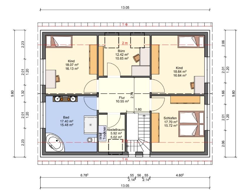

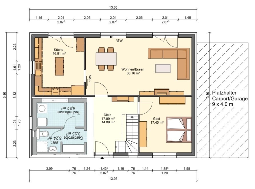

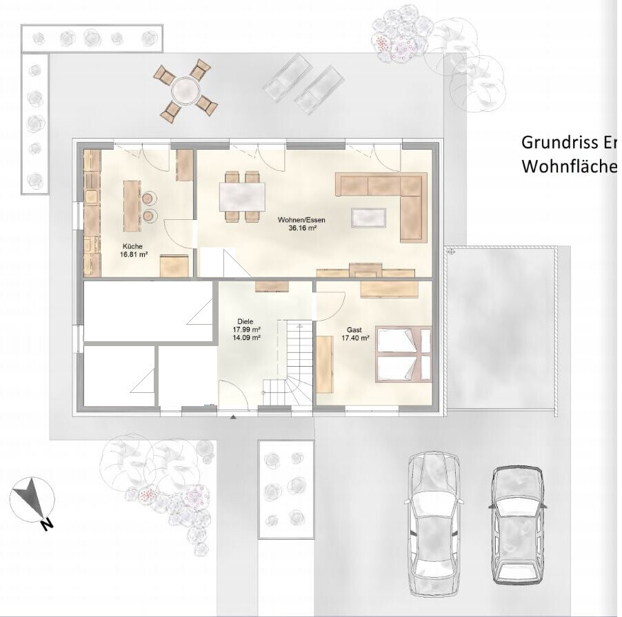

I have been thinking over the past few days about the arrangement and design of the rooms and the plot, and I would first like to know if the concept is okay. I am not concerned with details inside the rooms such as windows, doors, or bathroom design. That’s not possible anyway since I created the floor plan myself based on Gussek Haus floor plans. However, I tried to design it as well as possible. For this reason, I want to share the floor plan here for discussion. I’m mainly looking for feedback on the layout and room arrangement, as well as ideas, suggestions, or tips. Maybe you’ll also spot things that “just don’t work” or are not practical for everyday living.
I created the floor plan with RoomSketcher, but only used the free version, so many features are limited. Please ignore the room dimensions on the upper floor. There is a dormer in the area of the home office.
A few more details about the house.

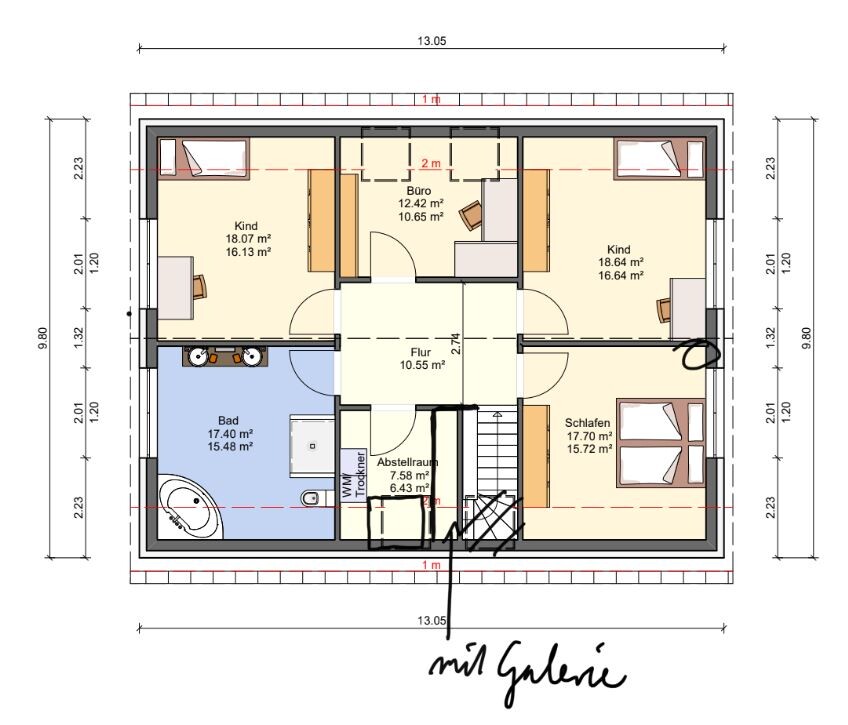

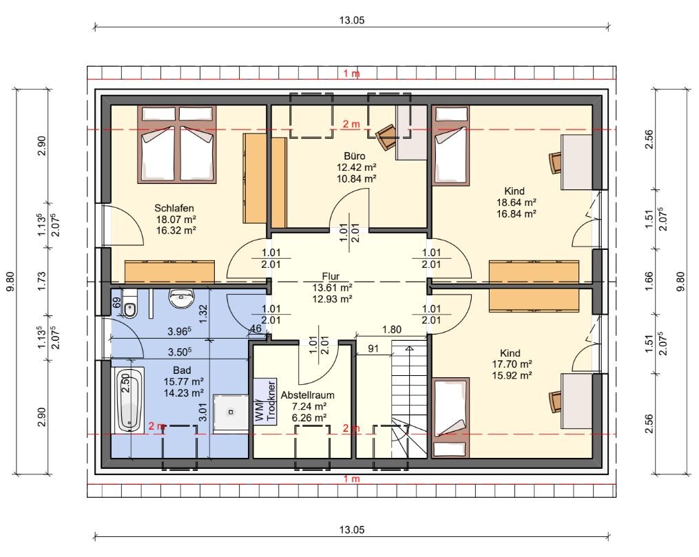

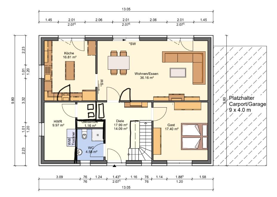

Chrisi190624 May 2020 15:00Here are the latest floor plans.
Changes on the upper floor:
The storage room has now been recessed, and the bathroom on the upper floor has been made smaller. The bathroom design has also been changed according to our own preferences. We removed the gallery and instead placed a skylight next to the storage room / by the stairs. A width of 89 cm (35 inches) for the stairway currently still seems like a mistake to me. I also feel that the passage next to the storage room with 91 cm (36 inches) is too wide, but what do you think? Basically, it’s only there to access the skylight. Would you extend the “passage” all the way to the exterior wall? Visually, I would leave 90 cm (35 inches) clear at the end of the stairs. Of course, then it would be less easy to reach the skylight. However, my wife and the planner overruled me.
Changes on the ground floor:
I had the ceiling height adjusted to 2.75 m (9 feet). Additional costs were almost €5,000 for the increase and window adjustments. We have looked at 3 houses from the builder. House 1 with 2.75 m (9 feet) on the ground floor and 2.5 m (8 feet 2 inches) on the upper floor, with a ventilation system. I found the upper floor somewhat low. It is difficult to say whether this was due to the ventilation system or the height difference between ground and upper floors.

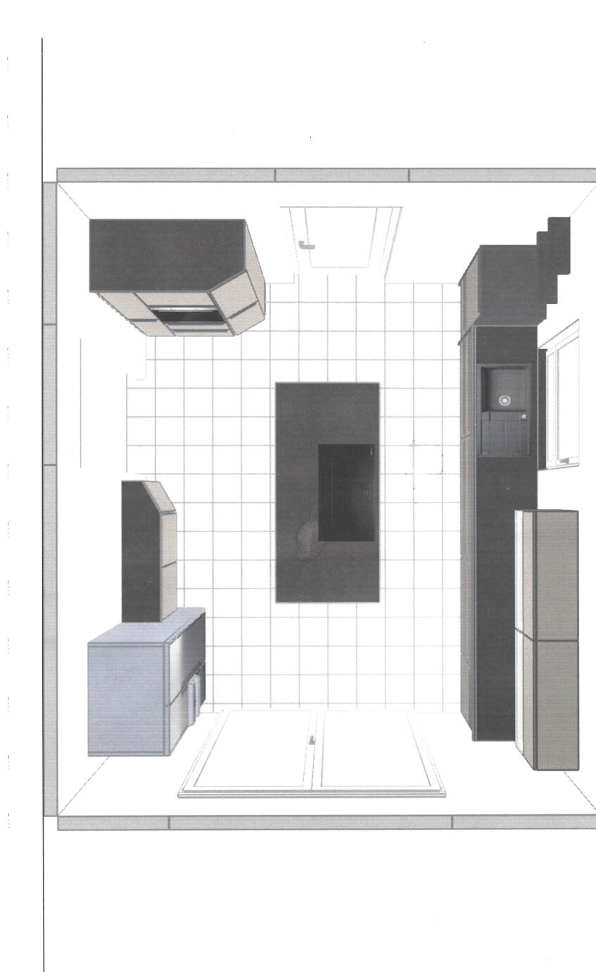

Also, we visited a kitchen showroom this week and had a kitchen design planned. See the picture below, but it has not yet been incorporated into the floor plan. If you remove the cabinet next to the fridge, it would be possible to install double sliding doors to the kitchen. However, I suspect that while these would look nice, they might be impractical.
I’m not sure if it makes sense to add anything more since hardly anything changes despite various suggestions, but I’ll say it again:
There’s no space to use the wardrobe next to the bed. Move the wall toward the office by 60cm (24 inches) and position the wardrobe flush with the door. The patio door behind the sofa is impractical; the walkway from the other patio door in the living room is blocked by the dining table, and the west-facing window is completely missing in the living room.
All windows on the upper floor are too narrow (except for the double casement window).
Congratulations on the double casement window in the stairwell—what a long time it took!
