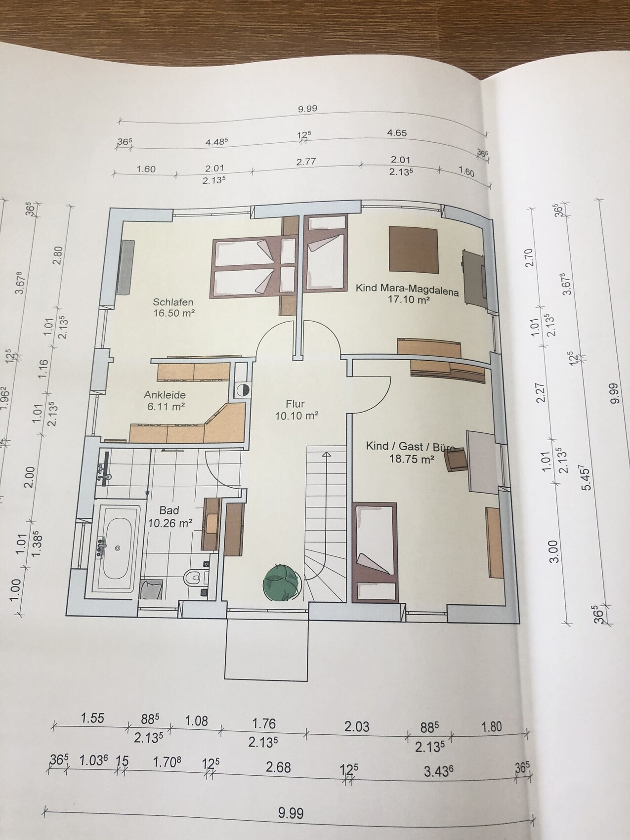

Hi, attached is a floor plan for a townhouse (142sqm (1,527 sq ft)).
What can be improved here? How can the upper floor be optimized in relation to Child 2’s room?
All windows on the upper floor are floor-to-ceiling and located in the same positions as on the ground floor.
On the ground floor, for example, I would create an opening from the kitchen to the hallway opposite the floor-to-ceiling window.
1. This would save having to go through the living room.
2. It would allow natural light into the hallway through that window.
Additionally, I might consider moving the fireplace closer to the living room.
- This would make the walk-in closet more usable; it would probably not disturb Child 1’s room.
Regarding Child 2’s room, the only idea I have is to incorporate the hallway space. Child 2 would then have the wide floor-to-ceiling window, but the hallway would lose its window entirely...
I’m really at a loss here.
Open living/dining area (36.87 sqm (397 sq ft)) with kitchen on the left, sofa on the right, shower and storage room.
Floor plan of the upper level: hallway, bedroom, walk-in closet, bathroom, 2 children's rooms, office/guest room.

This was the original plan... the only issue we have is with the staircase. It starts right at the entrance, so dirt is carried straight upstairs. Additionally, we would like to have it enclosed to use as a storage room.
Grundriss eines Wohnplans mit Flur, Kinder-/Gästezimmer, Büro und Bad.

Is it allowed to adjust the generous master bedroom considering the house size?

Fingerhaus Madley 3.0 211 would only swap parent and child rooms on the upper floor.
I don’t like the ground floor; it should be revised.
Schwörerhaus E 20-144.3
Hanse Haus Villa 133

Thank you very much. Regarding the second children's room, would it be possible to simply move the staircase downwards, placing it directly near the entrance, and slightly shift the door on the ground floor to the left? Then do the same with the window upstairs. The bathroom could then be designed as a kind of niche (see picture). Additionally, the wall between Child 1 and Child 2 could be moved upwards. This way, Child 1 would have slightly less space, and Child 2 slightly more.
Grundriss eines Hauses: Schlafzimmer, Ankleide, Flur, Bad und zwei Kinderzimmer.
