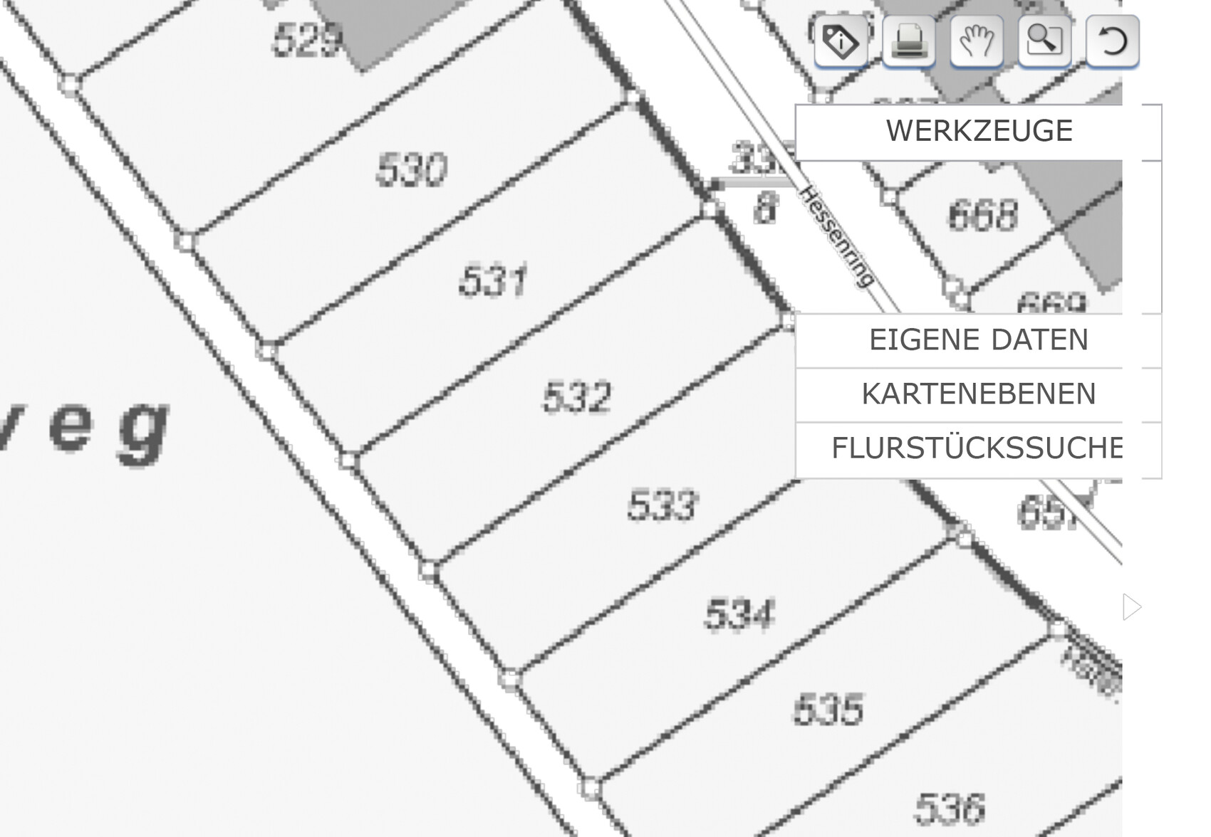

I hope this helps a little. Plots 530-535 – the situation is still unclear, but it should become clear quite soon.

Then go back to the land registry portal and enable the additional information overlays there. This “quality” of presentation is only enough to explain to an alien where Hesse is located.
