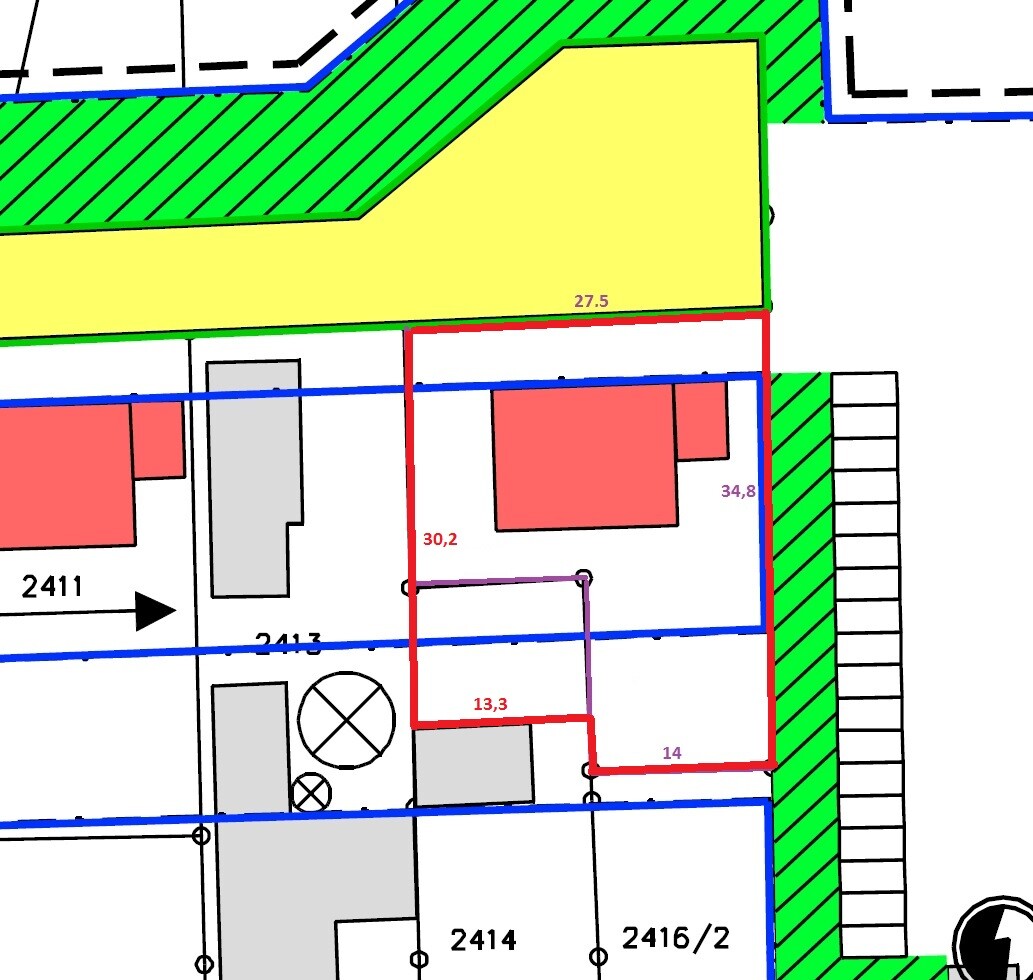

Attached is an excerpt from the development plan. The plot outlined in purple is the one in question. The houses shown in red do not exist; they were just added for planning purposes.

See attachment.
One shows the current state of the plot.
However, we plan to shift a boundary slightly. So also see the intended state as we imagine it.
To be exact, I quote again from my original post, from the email quote from the local building authority:

kaho674 schrieb:
Please provide the plot dimensions. Then it is easier to get an idea of what is possible size-wise and whether your complaints are justified.
See attachment.
