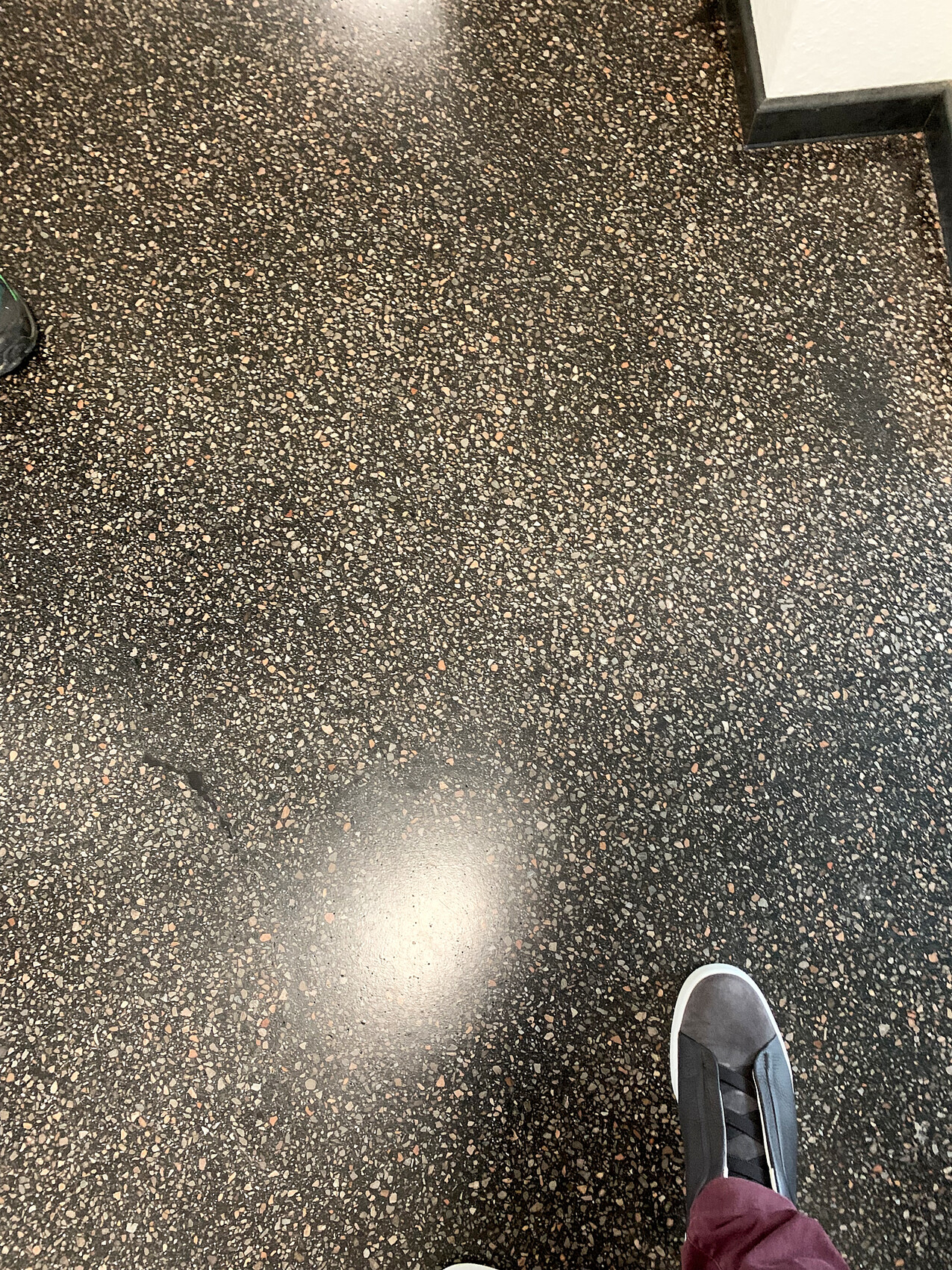

Here’s an example photo (the floor is scratched and not well maintained). This was taken at our supplier’s location.
You can find more examples on Google under Bituminous Terrazzo.
The appearance can be influenced by the additives (grain size, color, etc.). The base color is always black.
