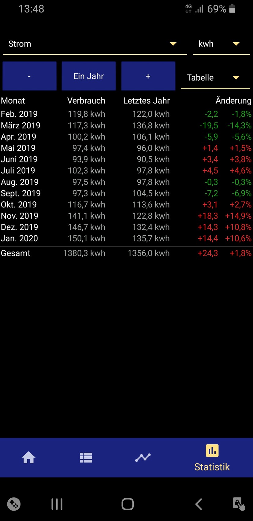

Stadtvilla1922 Mar 2020 13:55No, we have everything—both the refrigerator and the large freezer are energy class A appliances. We also have a dishwasher that runs every two days, and the TV is always on in the evenings. Apart from an instantaneous water heater, we only have a gas boiler, which also consumes some electricity. In summer, the refrigerator and freezer work extra hard because we live in an attic apartment that can reach over 30°C (86°F) on some days.
At the moment, our consumption is increasing slightly since my wife is on parental leave, but here is the analysis from February 2018 to January 2019.
