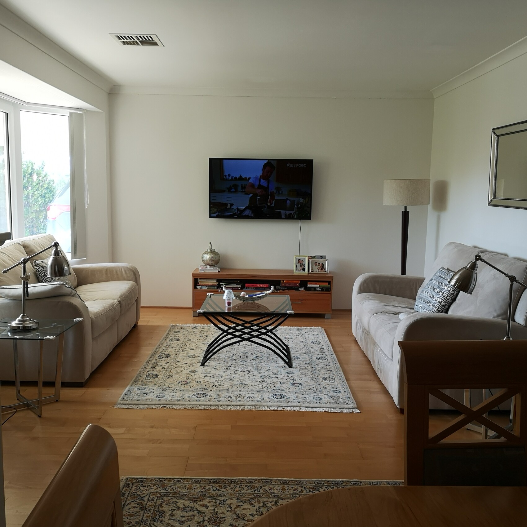

We have two ugly, expensive couches facing each other, about 180–200cm (70–79 inches) apart. One is his, the other is mine. When we watch TV together, we lie on "our" couch. The room faces the street; there is a second living area toward the garden.
Regarding the house of the original poster, the TV would be on the left wall by the office. One couch would be placed along the bottom wall, and a second one opposite it, with some distance from the kitchen wall. From there, you would look right toward the garden and left at the screen.
evelinoz schrieb:
And when it comes to space around the dining table, if you can afford a bigger house, everyone would enlarge that area.It's not always a matter of size. Even in small houses, you can keep pathways clear.
RomeoZwo schrieb:
You don’t always want to watch TV while sitting on the sofa. Sometimes you just want to sit and talk, and then a view of the garden is much nicer than looking at a dark wall with a dark TV. I think we are in the minority here. The mainstream attitude seems to be that the TV is the center of the living room, and the viewing distance is practically the axis of the earth.
I think we’re actually in the minority here. To me, the mainstream attitude is that the TV screen is the focal point of the living room, and the viewing distance is almost like the Earth’s axis. Do you really think so? I suspect that because this setup is so common in almost all prefabricated house floor plans—probably to create an attractive exterior with large windows in small rooms—it has gradually become the norm without anyone really intending it.
