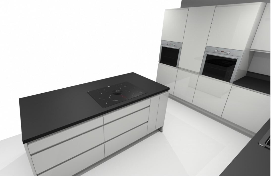

I don’t have any photos of the finished kitchen yet, but at least a 3D view. It is an open kitchen connected to the dining and living area (behind the kitchen island). The kitchen space measures 3.0m x 5.4m (9.8ft x 17.7ft). Behind that, there is approximately 6.5m x 4.8m (21.3ft x 15.7ft) of space for the dining and living area.
Before any questions about the fridge/freezer come up: yes, they will be attached to the side like that because that’s how we want it .
[ATTACH alt="Screenshot_20200115-024632.png"]41917[/ATTACH]
Feedback and suggestions are welcome!

why are the tall cabinets on the right positioned so far to the left that a gap appears next to the refrigerator? That doesn’t look good. Can't they be moved to the right?I suspect the refrigerator doors wouldn’t be able to open properly then?!

Thanks for the feedback. The uppers layout isn’t final yet. The depth is a small issue we’re still working on. Right now, it’s only available in a 40cm (16 inches) depth. The cooktop is about 45cm (18 inches) from the edge. It’s a bit easier to see from the other side:
You can’t really see it clearly in the 3D image, but the two lower cabinets are 60cm (24 inches) and 80cm (31 inches) wide.
Above, there are currently only two 60cm (24 inches) units. That’s why there’s a gap. We haven’t made a final decision on that yet either.

@Chris2511 I would leave out the two upper cabinets to the right of the window. It looks kind of chopped up, especially next to the fridge.
I can’t tell for sure if it’s like this already, but I’d make the wall cabinet above the niche on the left side as deep as the tall units – that looks more modern and better.
With the cooktop on the island, especially so close to the edge, you’ll often have grease splatters on the floor on the left side.
Curly schrieb:
Why are the tall cabinets on the right so far to the left that there’s a gap next to the fridge? That doesn’t look good. Can’t they be shifted to the right?

Grantlhaua15 Jan 2020 13:10Are you getting a Bora Pure or a Bora Pure X?
