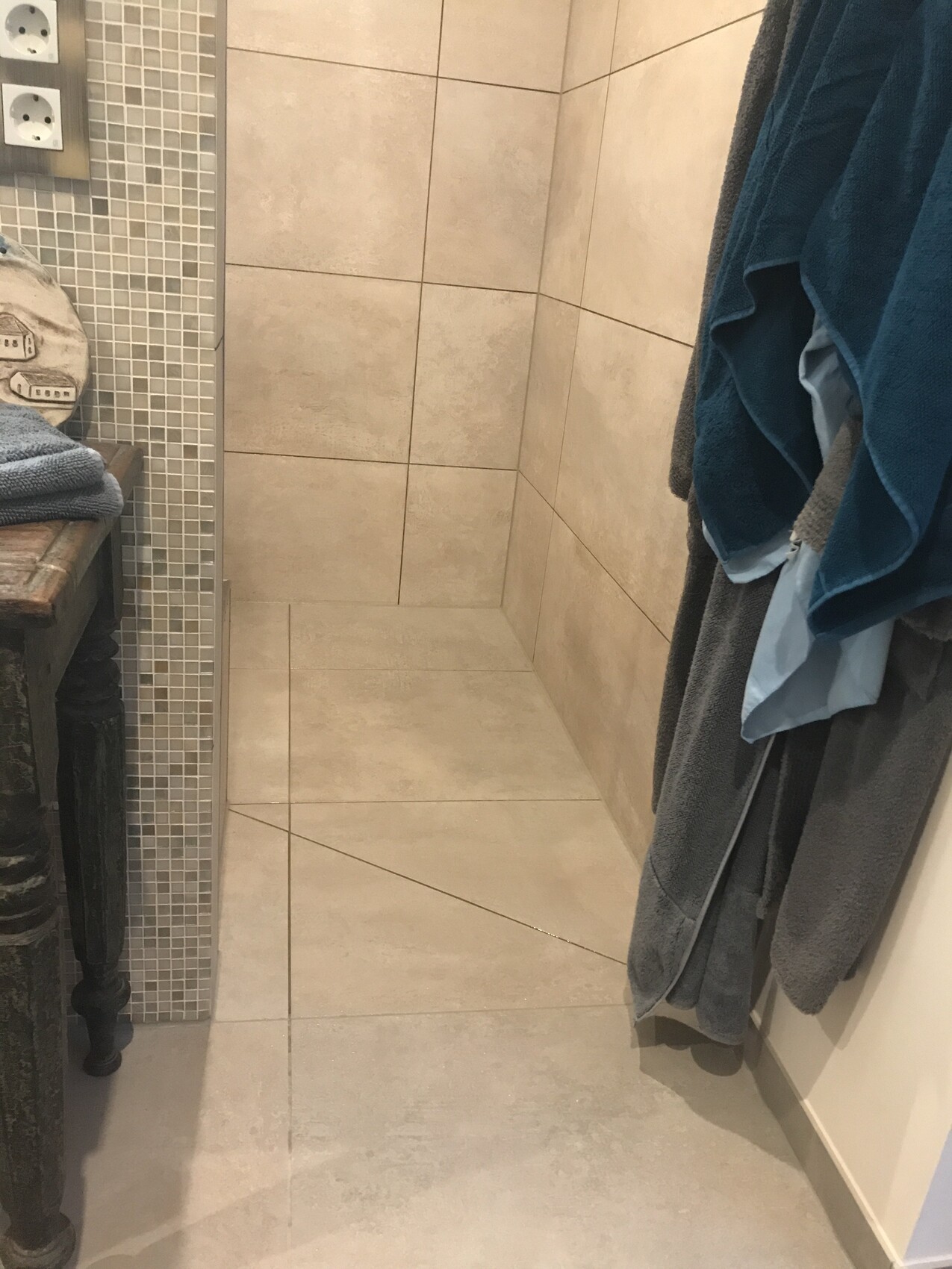

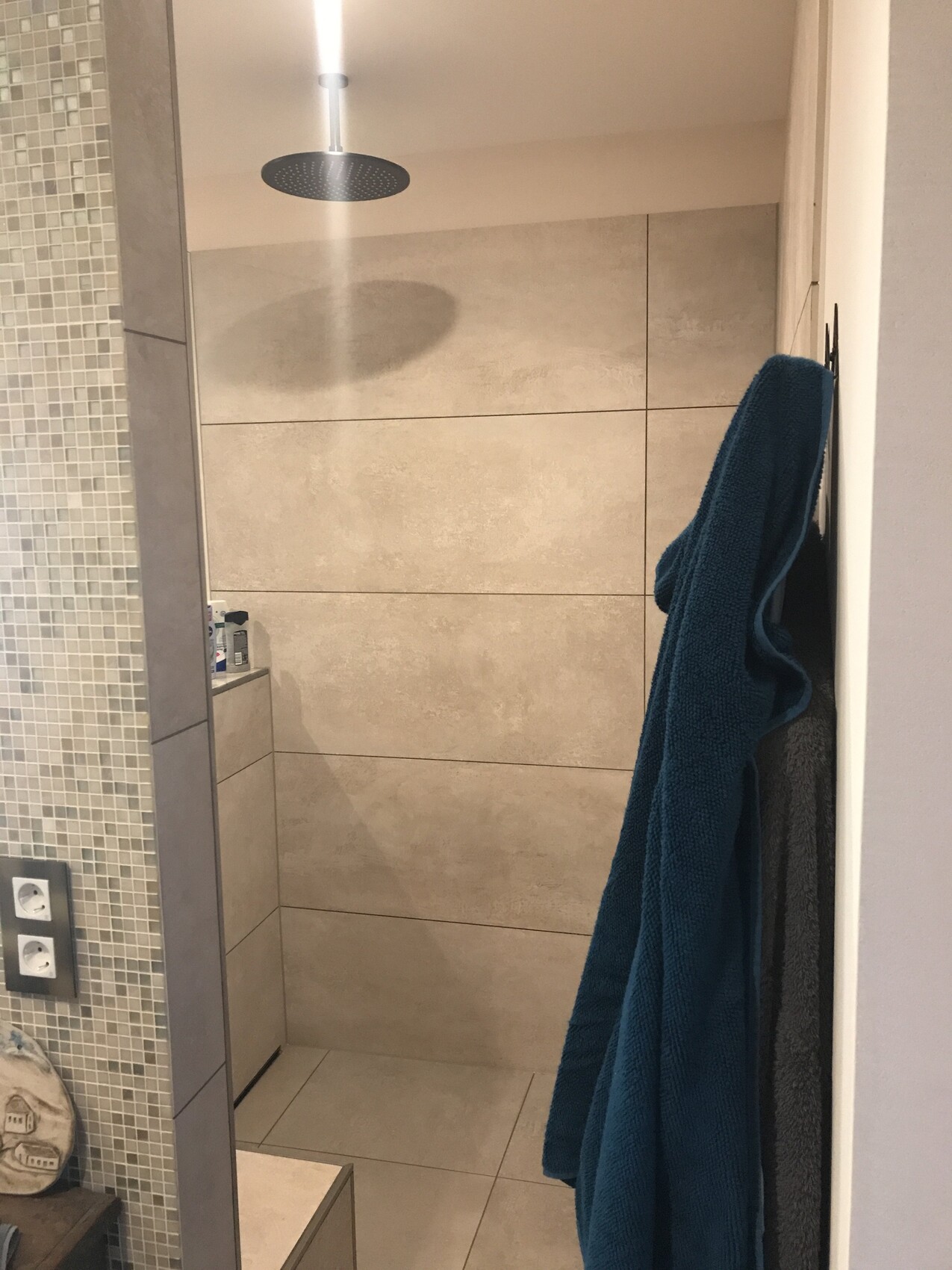

hampshire3 Jan 2020 09:02I just did a practical test. The water splashes up to the hanging towels next to the shower. The floor tiles are 60cm x 60cm (24 inches x 24 inches). The tile on the wall side is slightly shortened. The tiled shower bench doesn’t significantly stop the water when using the overhead rain shower. The height is about 180cm (71 inches). The split tile already has a slope. Using a squeegee to wipe down is part of the shower routine.

When I shower, the water reaches about 140cm (55 inches), for my husband it reaches up to 200cm (79 inches). That is also the length of the shower.
It definitely makes a difference where the shower is installed – whether lengthwise or widthwise.
