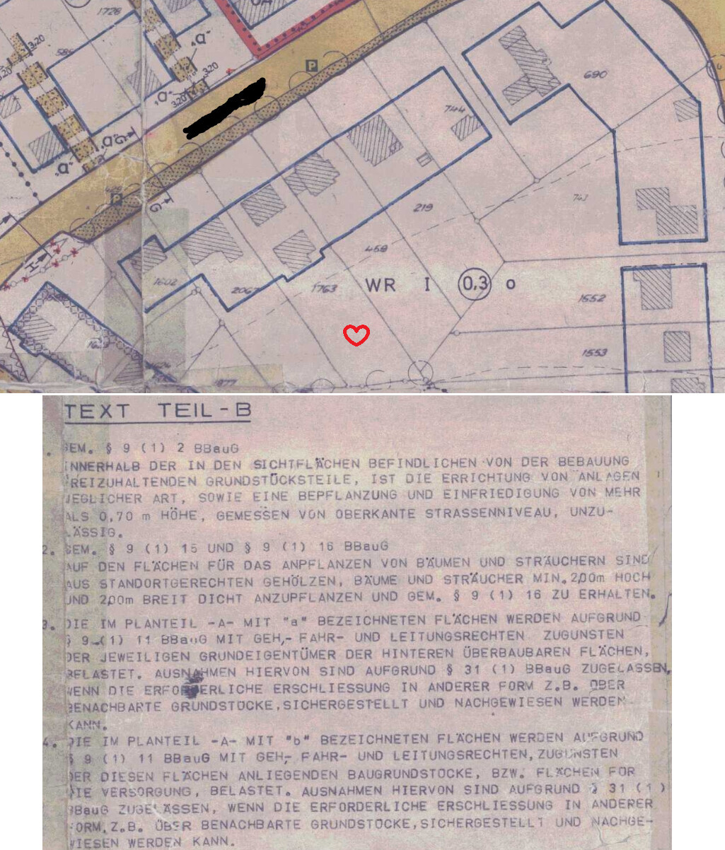

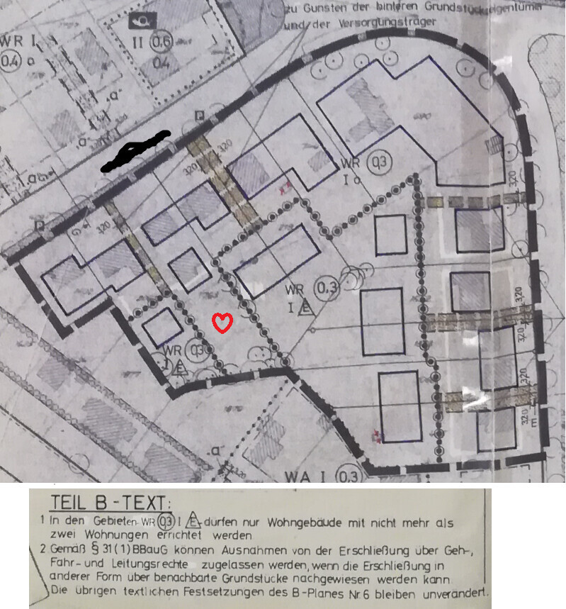

Hamburger202015 Dec 2019 13:16Hello,
Thank you very much for the additional information! I have attached the development plans. I noticed that the first version of the development plan (1979) allowed for a larger building envelope. However, the current version (from 1984) has restricted the building envelope.
Does this increase our chances or decrease them?
I have marked our plot with a heart.
Escroda schrieb:
Yes, the zoning plan. But with a good justification from the architect, an exemption should be possible to approve.Hamburger2020 schrieb:
Does this increase our chances now, or does it reduce them?I don’t think we can assess that better than you on site. Just a gut feeling: I would bet that you have very good chances to widen your building plot. So definitely ask. A small plan with justification—ideally in a direct conversation. If you don’t get a categorical “no,” just submit the building permit application. The worst that can happen is that you need to resubmit parts of the application, lose some time, and spend a bit of money. We also submitted a preliminary building inquiry and paid 3,500 euros extra for it. It was worth it for us. Whether it is for you too, only you can decide.Hamburger2020 schrieb:
I marked our property with a heart.Cute.By the way, here is a quick batch:
Yes, you have to accept some changes. But I just say: nice kids’ rooms, right?
Hamburger202015 Dec 2019 14:09kaho674 schrieb:
I don’t think we can judge this better than you on site. Just based on intuition, I’d guess you have a very good chance of expanding your building plot. So definitely ask about it. Have a simple plan with your reasoning ready—ideally discuss it in person. If there’s no outright “no,” just submit the building application. The worst that can happen is you need to resubmit parts of the application, lose some time, and spend a few hundred euros. We also submitted a preliminary building inquiry and paid an extra 3500 euros for it. It was worth it for us. Whether it’s worth it for you is something only you can decide.
